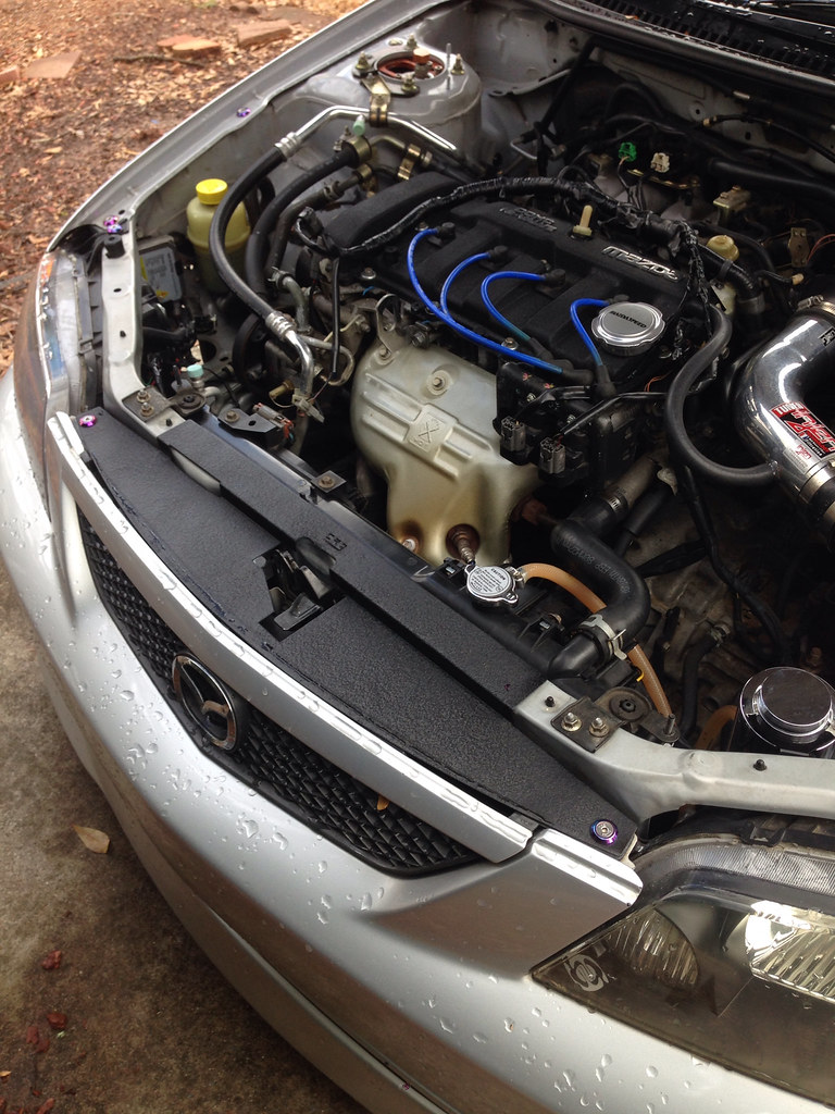

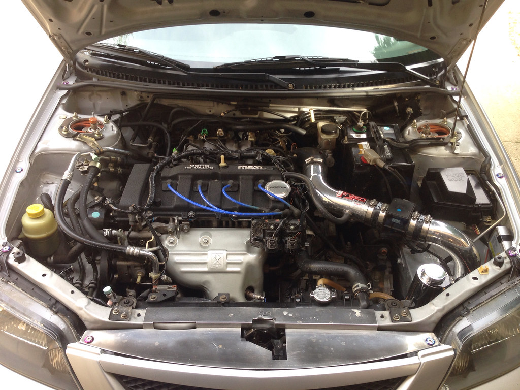

pic below is of the wires/sensors/vac lines moved. Non were cut or extended just undo all of the OE loom and reloomed in tech flex as well as heat shrink on everything.
