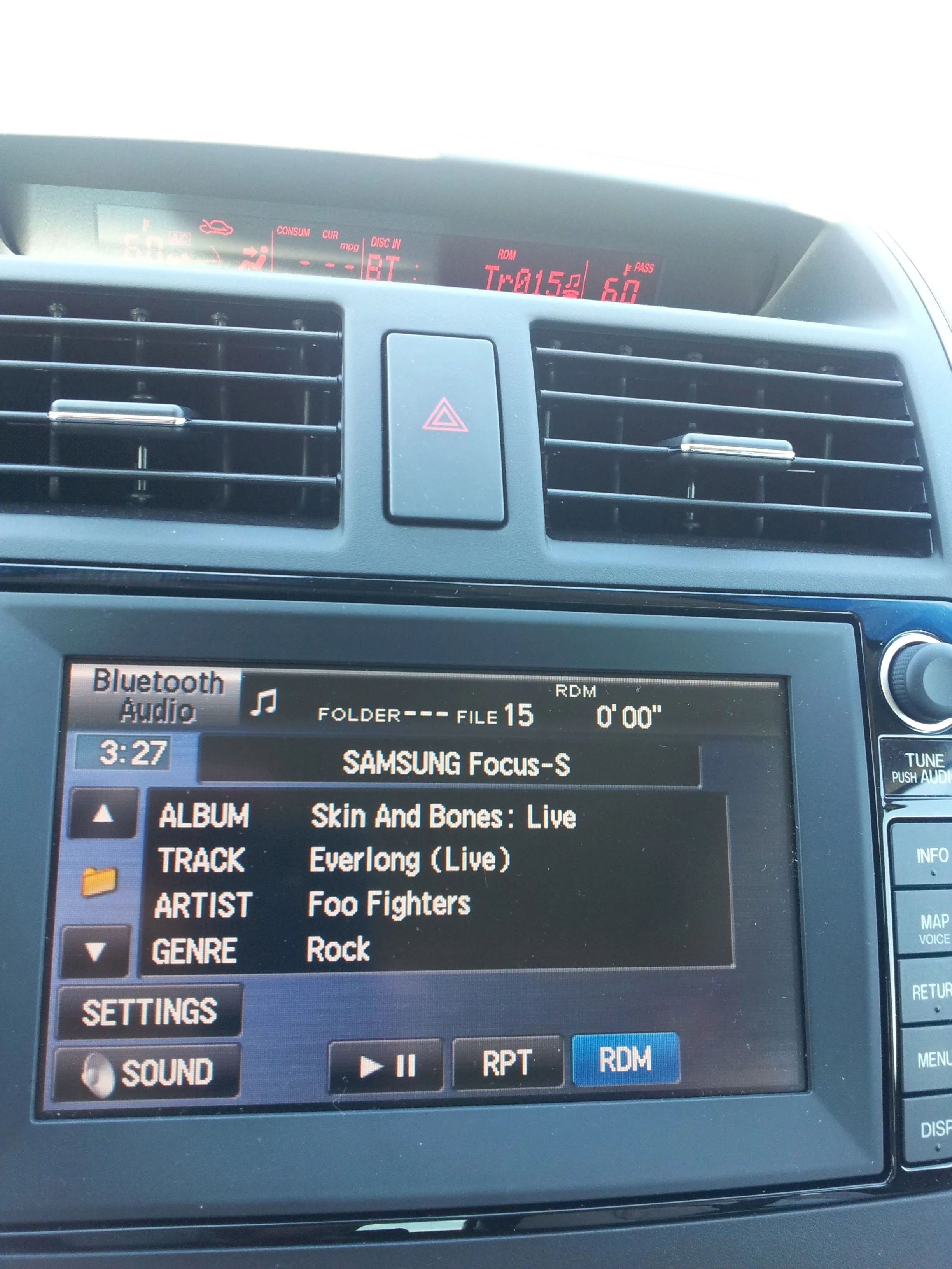

I begun trying yesterday with my CX-9 (2011 GT with Nav and Bose). I use the Phone Music Market (Zune) to play demo songs. it worked fine and the Nav system showed full information of the song, artist, album on the screen. I will add few songs today to the phone and retry today to provide more details. I will check if info is going to be shown on ly on the Nav or also on the upper information display (Amber). BTW my phone is a Samsung i937 (Focus S for AT&T), which comply with AVRCP 1.3 (https://www.bluetooth.org/tpg/QLI_PRD2Profiles.cfm?varID=31377&ProductID=17284)
I will update later today
This is what the CX-9 (2011 GT with Nav and Bose) shows to me.
  1. On the amber screen on the top. Just show "BT:" as the source, and then the Track #.
  2. At the Nav Screen it shows all the details
    1. Album
    2. Track Title
    3. Artist
    4. Genre
I found curious that the nav screen DOES NOT show the progress of the song in mins or secs. It always shows 0'00" on the top right corner. Below a picture from the screens while a song is been played
I don't know how to check the module version or reference, if some one guide me, I can post that detail here.
