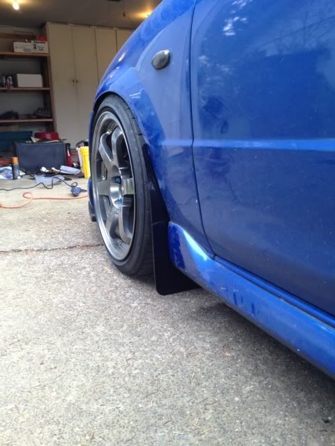

^My 2cents. Get your fenders rolled. You're 215/45/17 1.8" drop I'm 225/45/17 stock so I'm wider than you, but you're lower than me so its a little different. Chalk either the tires or the fender (dry erase marker) to check out where it's hitting. I rubbed in the rear only grabbing the top edge of my sidewall and rolling them did the trick. Now I can hug corners like my summer set up was meant for. Just make sure to use a heat gun...otherwise your paint will crack.
Oh and I gave my car a much needed bath today!
^CHALK! I never thought of that! thats genius!
what did you use to roll?
i used the handle from my jack to do the rears xD
Tada! Lmk if it ends up working out for you man, picking up some mp3 springs this weekend (no idea when they're going in) and id love to know if you make it work to give me some peace of mind before I rip my car apart. Haha.
