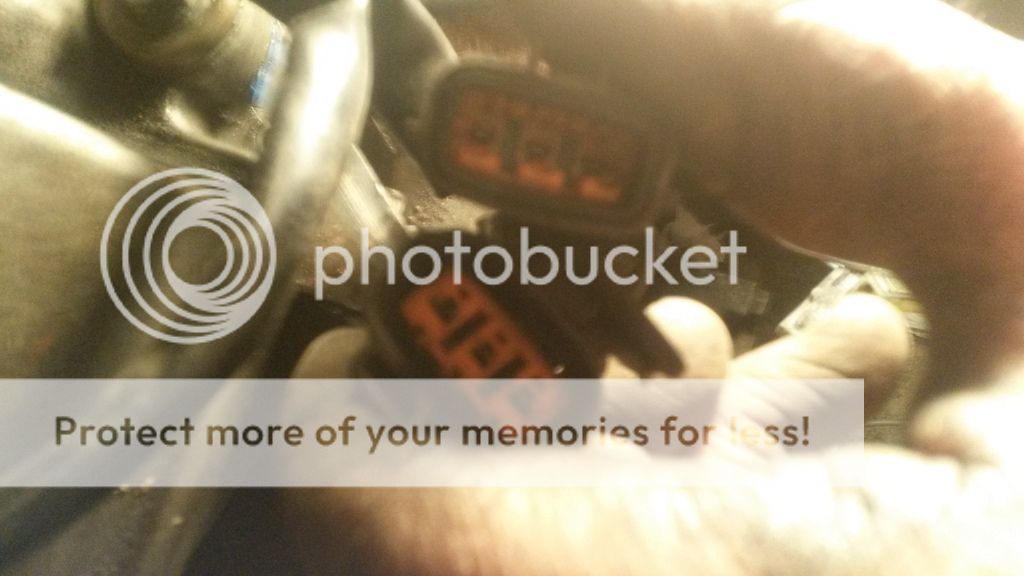

i dont know how its possible as both p5s were 2002 models with 2.0fs engines and abs ect. basically identical cars.. but there is a orange harness near the power steering pump location that doesnt match. both ends are 3 flat prongs but one end doesnt fit into the other... black car is gone so i cant fish the sensor that its attached to.. can i break the harness apart and insert the leads?
