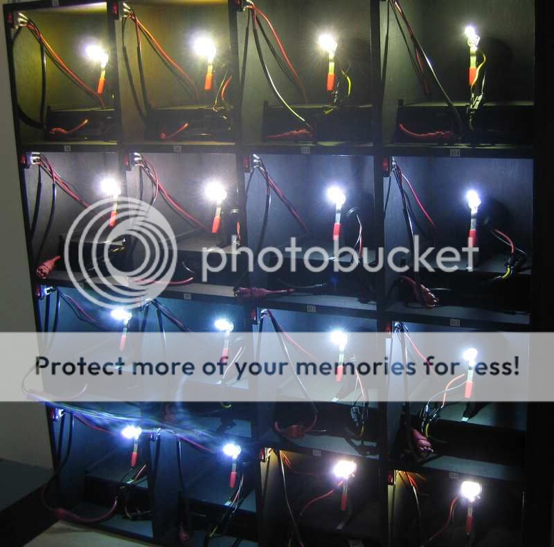

Why do you say this? HIDs tend to have a higher lumen output in lower color temp.
Likely will receive police attention. What is your motivation for doing it?
Why do you say this? HIDs tend to have a higher output in lower color temp.
3k output would be more yellow than white, if it was the better light output OE cars would not come with a 4300kish bulb which typically give 3x more light output than traditional halogens. Halogens are also close to a 2300k light, so IMO 3k would be nothing more than a bit more yellow than our OE halogens and not give anywhere close to the light output of a proper 4300k bulb.
I think you're confusing HID with non-HID output.
Look at the trend below... the higher the Kelvin color rating, the lower lumen output. While 3000K output is not listed its reasonable to deduce from the mathmatical pattern provided that a 3000K hid will output MORE light than a 4300k. Also, you need to consider here that the color temps are not "actual", but rather are adjusted to marketing expectations. 2300k would actually be MORE yellow than a 3000k HID, and obviously it is not, if the ratings were "actual".
http://www.manyadeal.com/page.html?id=24
And instead of Mathematical, here is a visual demonstration of ACTUAL 3000k HIDs... not 3000k advertised HIDs:
3K, 3K, 4K, 4K
5K, 5K, 6K, 6K
8K, 8K, 10K, 10K
12K, 12K, 3K, 3K
