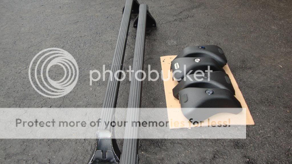

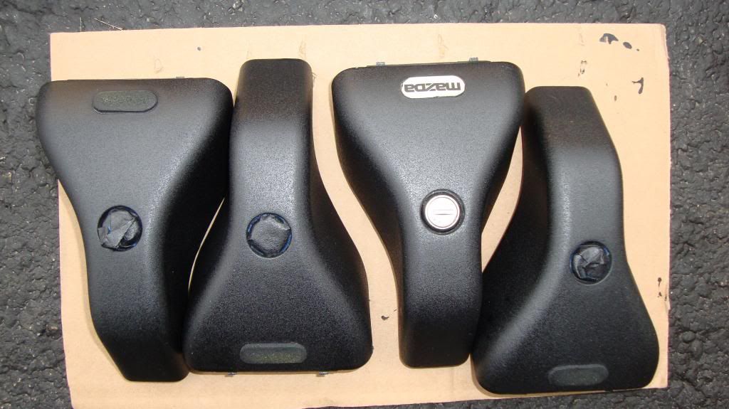

Cleaned up the roof rack I bought on ebay, shot it with Rustoleum bed liner and installed it. Came out looking pretty good I think.
I was going to shoot the bars with black enamel, but found them covered in vinyl, so I shot them with the bedliner spray too.
