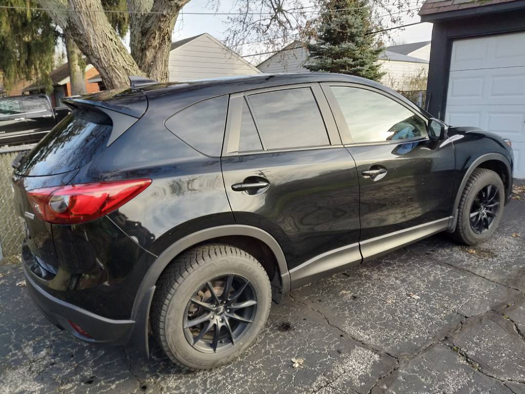

I've only had my CX-5 a couple of days, so I took it out and took some photos of it today to send to family back home. Not much else really.
