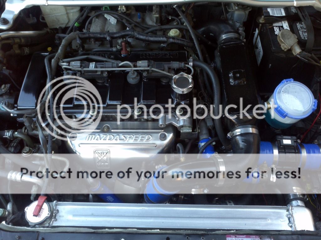

All three of us posting in one thread? Crazy! LOL, Yea, I love this setup on the MSP. I'm always surprised the temp difference of the hot and cold pipes too. It's amazing how well this little intercooler works. This setup wasn't working as well on the S14, but I didn't have the radiator in a very good spot (the air was going around instead of through it) so I'm in the middle of re-locating it so the air coming in the front bumper HAS to go through the radiator, which is how I have the MSP set up.
I like how you guys are running a reservoir right off the water outlet of the IC core. I think I'm going to have to rework my setup to fit with the 505zoom intake that's on the way, so I'll have to take that design into consideration. I've been thinking about going with a different core anyways.

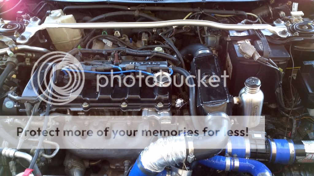

What are you guys intercooler/radiator combo's? I'll start;
MSP
Intercooler. Picture is a link where I bought this from. This is my first setup. I don't have any pictures, but I've gotten rid of the "closed" system with the radiator cap and went to a normal reservoir.

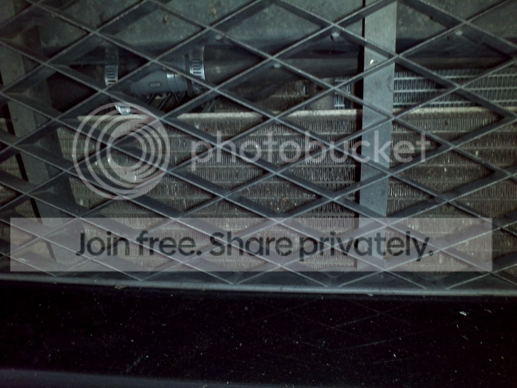

Radiator. Picture is a link again. I had to notch out the bumper support to clear this, but only by about an inch.
