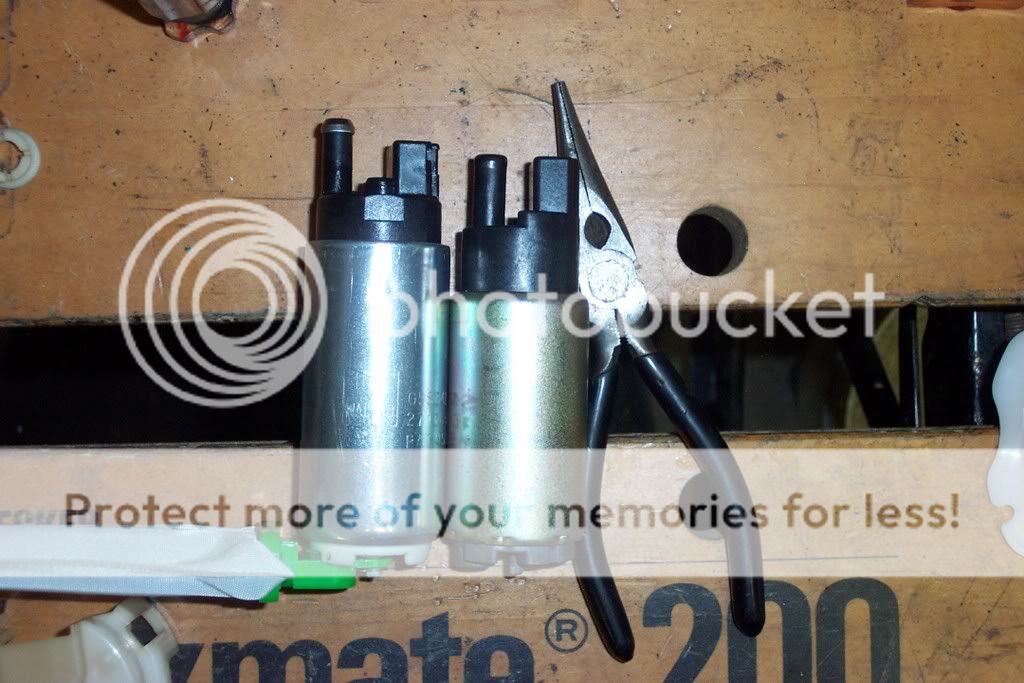

Okay I was going to do my pump today (again). Got the lines disconnected okay and everything out but then I find the Walbro is not the same size as the OEM pump and will not fit in the housing. It is longer (see pic below) and the bottom retainer will not fit back on over the filter.
What's the trick to getting this to work?

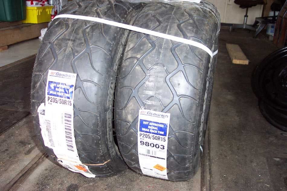

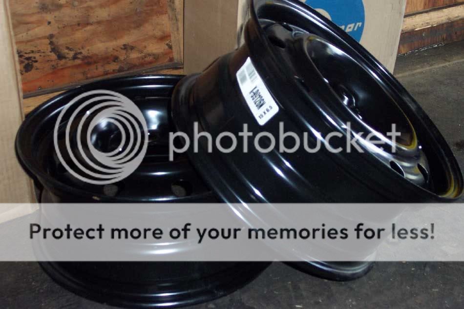

I'm going drag racing next weekend for the 2nd time in my life so I got these...
to go with these... :D

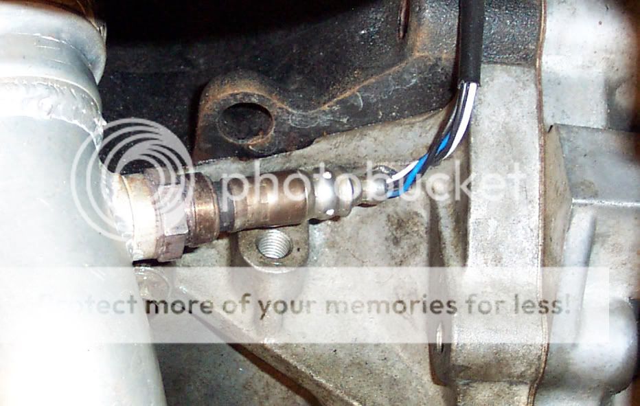

Car died on me yesterday...
Just turned left at a traffic light when it shuts down, no sputtering or any warning of any kind. All power still there, car turned over but wouldn't restart. Towed it home and left it as I had other things to do last night. This morning I got in and turned on the ignition. The familiar sound of the fuel pump priming was not there. I'm hoping it's only a fuse or something minor but I won't be able to look at it more closely until after work today. I do have a Walbro still waiting to install so that's a good thing but I'm just wondering if anyone might have an idea of what the cause of this failure might be, or suggest what to look for.
Have you changed your O2 Sensors lately? If so, did you splice in the wires? If so, make sure they are still properly insulated. This was my problem a year ago, when I was stuck on the side of the road for 3 hours, until Moeed pointed me in the right direction.
My 2nd O2 is gone but the primary is still there in a somewhat compromised position whch has been bugging me for sometime now. The MAM downpipe that I have has 2 O2 bungs after the flex pipe. One has limited clearance for an O2, the other virtually none. (I've got my WB in the bung before the flex pipe.)
And ya I know, WTF is with all the oil??? Damn weeping AWR pan... :(
You can see where the O2 is actually chafing into the tranny housing. I have to relocate the bung. Also, I will trace the wiring and double check the splice and insulation.
