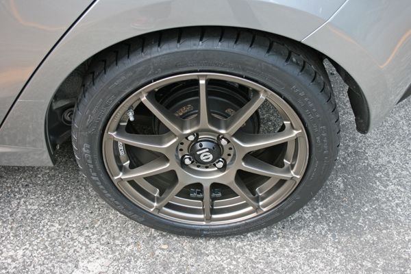

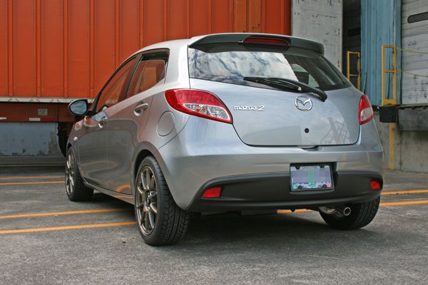

How did you get Tire Rack to show those wheels as an option for the 2? I don't see those Sparcos showing up at all! The bronze, gold and dark matte silver are pretty killer. And that orange is hot...

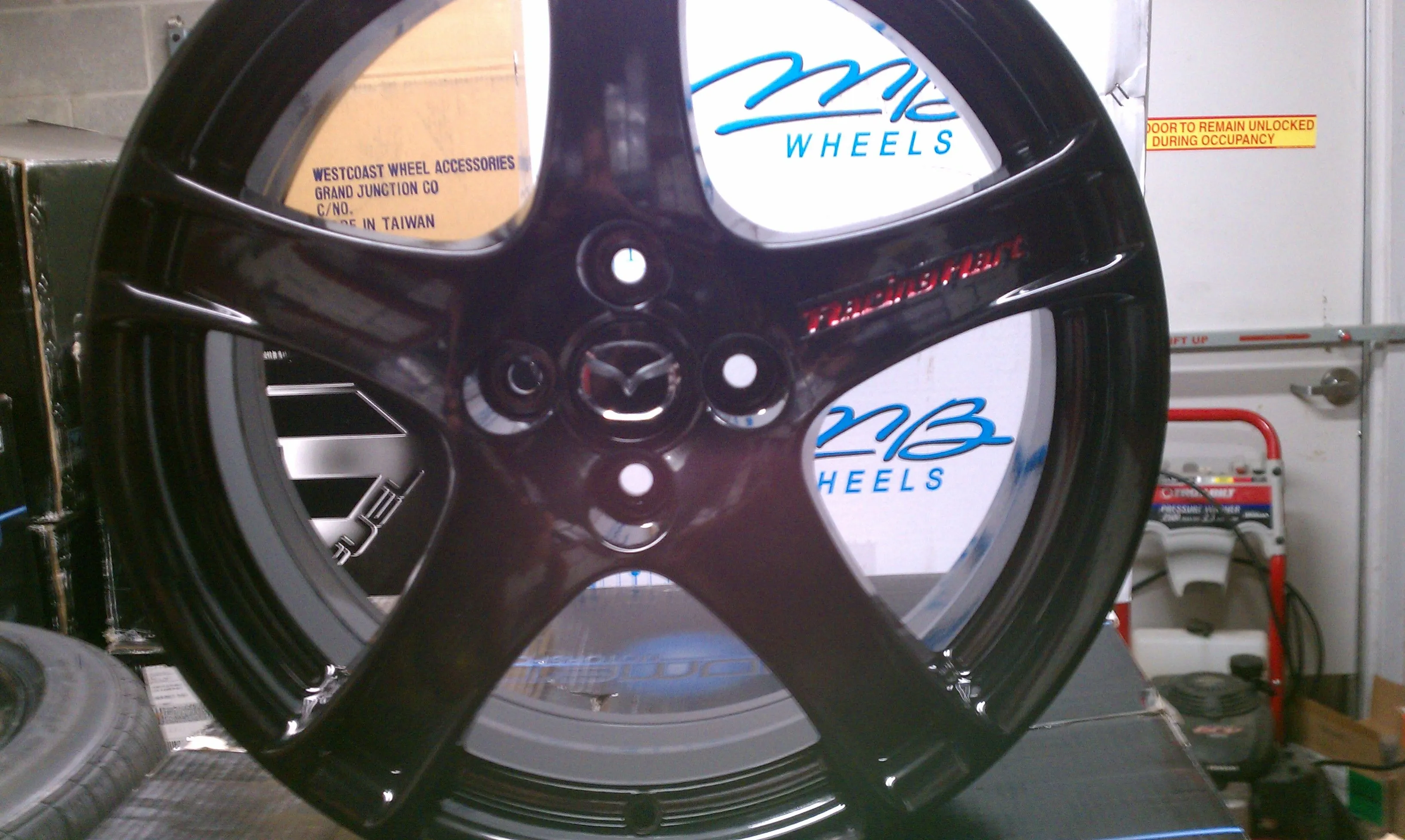

I didn't realize it when I posted that pic, but the wheels are 5 lug :/ lol

Sparco Assetto Gara, 16x7 +37 on 205/45/16s.
