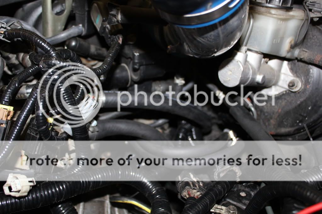

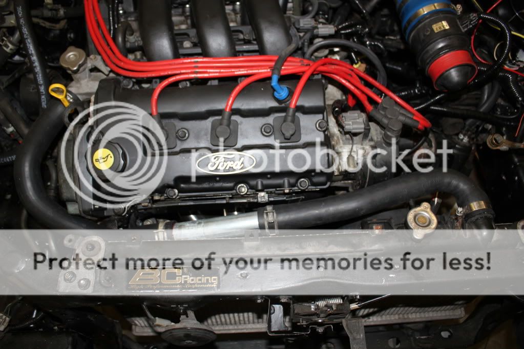

Seeing that radiator hose routing picture above - makes me wonder:
"....is this why mine keeps overheating and spewing it's coolant everywhere, ALL THE FCKING TIME!!!?!!!1!?"

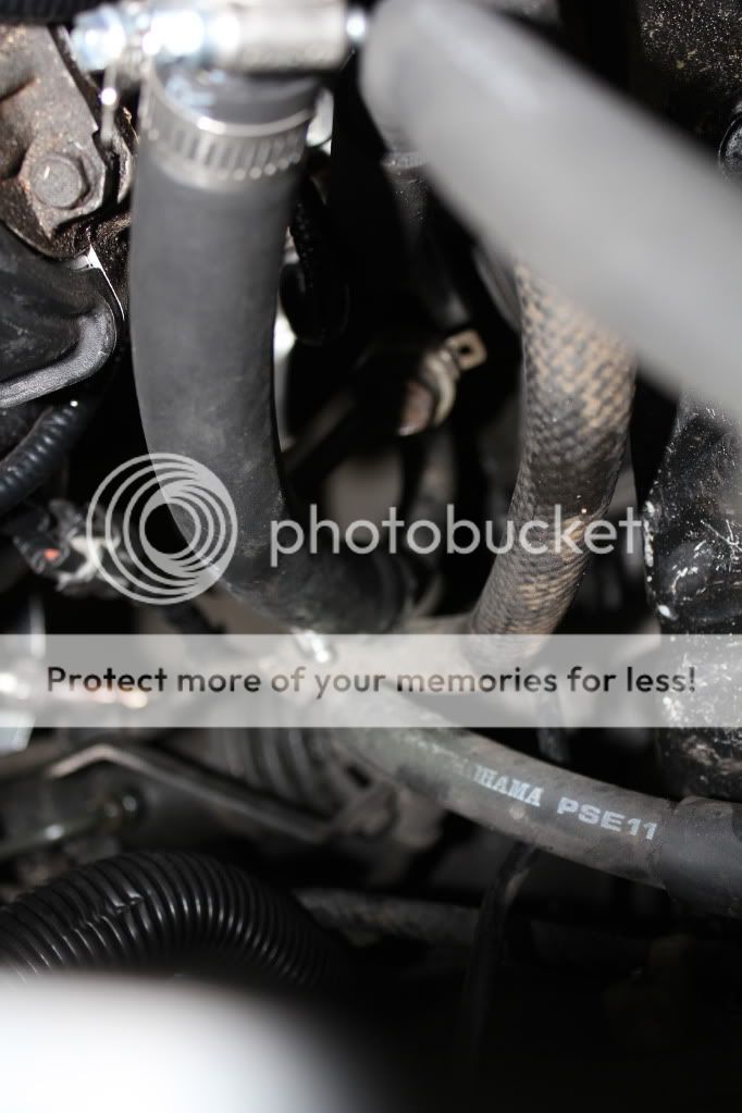

swapped them over to a configuration that allows the feed to always have pressure on it, that is - it's coming from the bottom of the radiator, and the return is shooting straight over to the top inlet (just like the picture above).
I only took it for about a 20 minute drive, but wow.....the temps were a bit lower than I'd expected, honestly. It's reading about 1/3 of my temp scale on the p5 dash gauge.

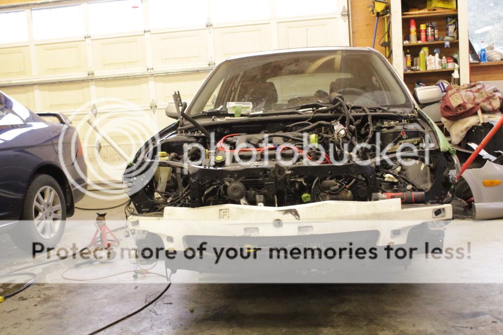

Well I'm due for an update. This is the end of day 3, I'm pretty much 90% to starting it.

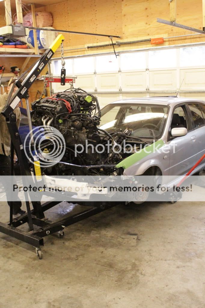

Dropping in the motor:
Motor in, only took a while. The rear mount of these cars is one of the stupidest part of it, I can't believe how hard it was to change and then bolt up, even with the FS-DE...
Here's my helper dog Carter, he's not really helping, he just thinks that shop towels are a toy..
Here's how it sits today
How I ran the rad hose up top, gotta love the extender my dad came up with.

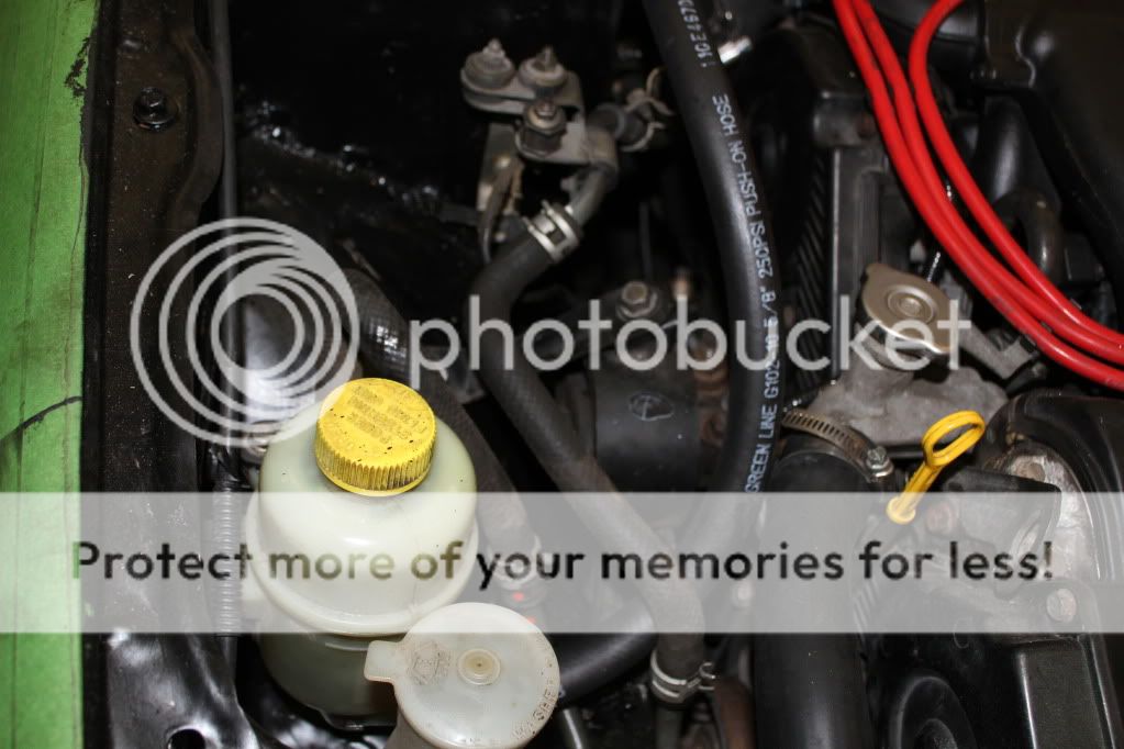

Not the best pic but here's how I did the power steering hard line. All I had to do was bend it a little more flat, new crush washers and it fits like a dream.
And heres the return line, the probe's line is 3/4 and the protege is 5/8. Brass coupler to mate them up, ran the 5/8 right to the bottom of the reservoir.

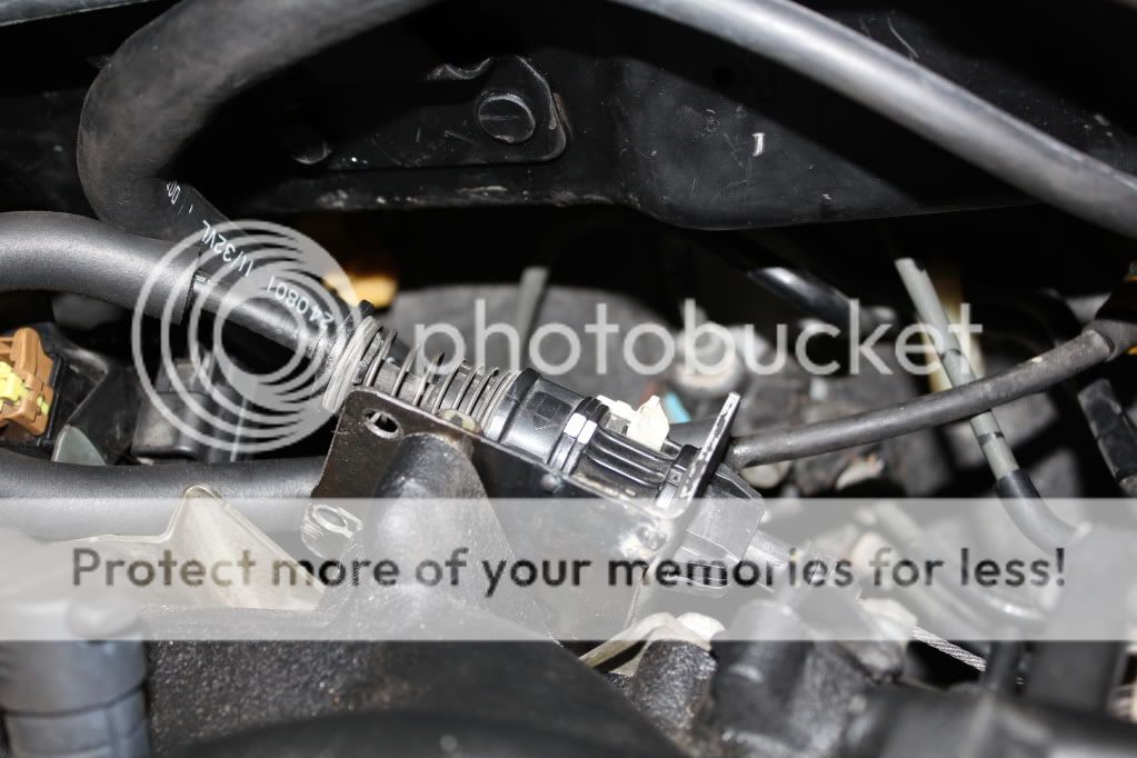

New fuel lines and heater core line. Generic 5/8 hose snaked around. Going to go to the junk yard tomorrow and try and get another 90 degree quick release, the straight line is reeeaallly close to the header.
Fuel lines were 3/8, I cut the quick releases off the proteges line and clamped new line to them, the other side to the KL lines.

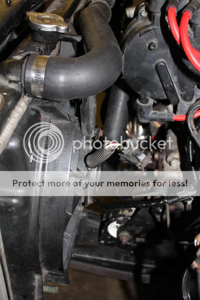

Probe fan mounted on the protege rad, little cutting, some quick brackets, extremely sturdy. Will have to do some wiring with it tomorrow. Also a look at the bottom rad hose. Ran out of clamps that fit, will be getting some tomorrow.

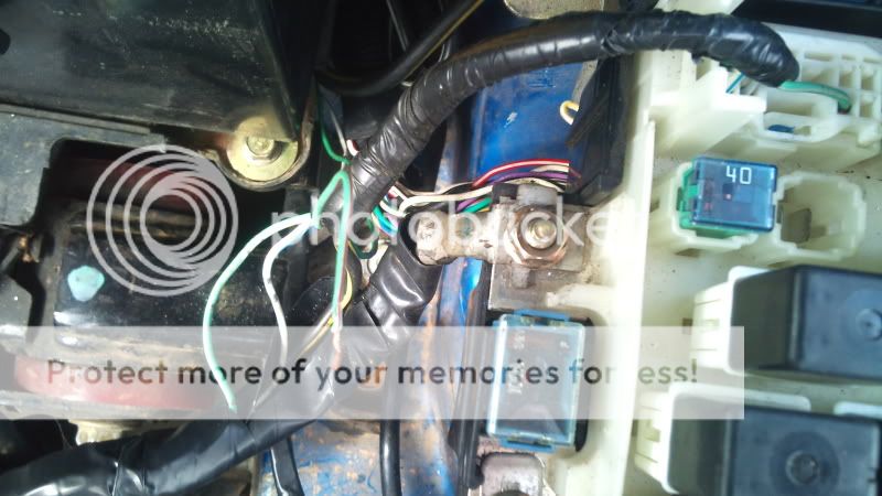

There is a green with a red stripe wire that's the oil light wire on the p5 its hooked up to the wire from the oil pressure sender

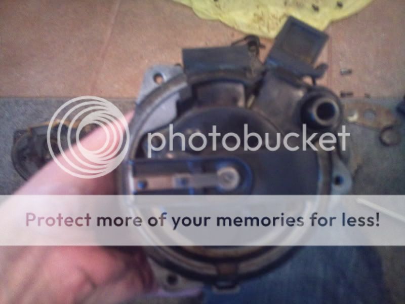

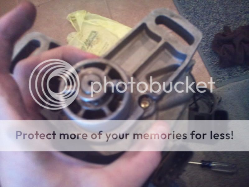

And ill tell you how to tear down and rebuild a dist I need to get on my laptop
seeing how your swap going i assume your reassembled it correctly
but idk if you noticed for your dist to work you have to line the rotor and the part that sits in the crankshaft to the slot in back of the dist and the slot on the ring inside the gasket
once again sorry for the bad cell phone pics
on the back you want to use the side with the notch on the end
