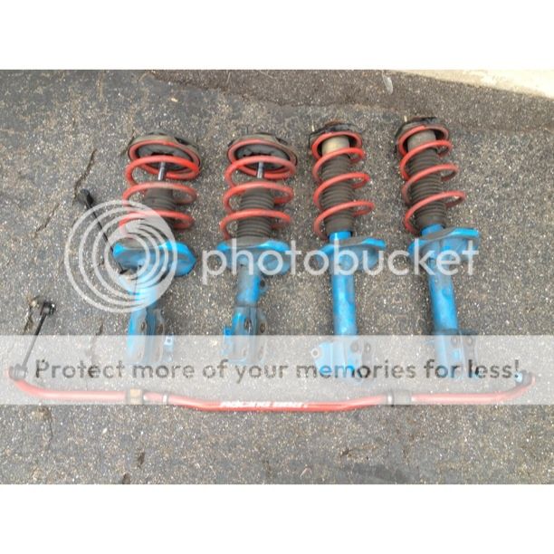

This week I'll be getting tokico blue struts and msp racing beat springs in the mail along with a msp racing beat rear sway bar
I bought them used and am planning on installing them this weekend
first off, i have ASA AR1 17" rims and am running 215/45/17 tires, should i expect rubbing with tokico/msp spring combo?
additionally, i want to know what else I need to install the rear sway.. i am getting endlinks with it and thats it. Should i order some other parts like mounting brackets or will the stock p5 ones do justice?

You'll need 20mm bushings and brackets for mounting the sway bar- i bought some urethane bushings from AWR for my car and used them with the stock mazdaspeed brackets... which don't fit the best on a p5/sedan sub-frame.
Your best bet would be to find some prothane/energy suspension bushings for a 20mm sway bar that come with a bracket that's got mounting holes in the same place as the brackets that are already on your car. I've had trouble with buying brackets that were too big and they just sort of covered up the bolt holes on my sub-frame(s). I've also bought bushings that were the right size to fit over the bar and the brackets lined up with the bolt holes, but the bushings ended up being too wide and i couldn't fit them both on without moving the rubber collars on the sway bar a bit inwards.
Some bushing stuff to consider :)
For the wheels i'm not sure about if they would rub- it depends on their off-set. Mazdaspeed protege wheels were 17x7s and came with a 215x45x17 wheel, so i'd assume if your wheel's offset is the same/close to the racinghart's then you'd be fine
just arrived today
so I have 2 end links and it looks like I will still need to get polyeuro bushings and mounting brackets
and a spring compressor
looks like the bar came with the OEM bushings actually- they might still be good but you'll need mounting brackets. There's a couple members here parting out MSP's and there's a guy parting an MP3 (the MP3 had the racing beat bar also)- you might ask them for mounting brackets.
I see that on of the rubber collars on the bar is starting to move towards the "racing beat" logo- before you instal the bar make sure you push it back away from the middle of the bar to it's original spot, otherwise while you're driving around the bar will slide over. Happened to me- moved over and made a lot of noise.

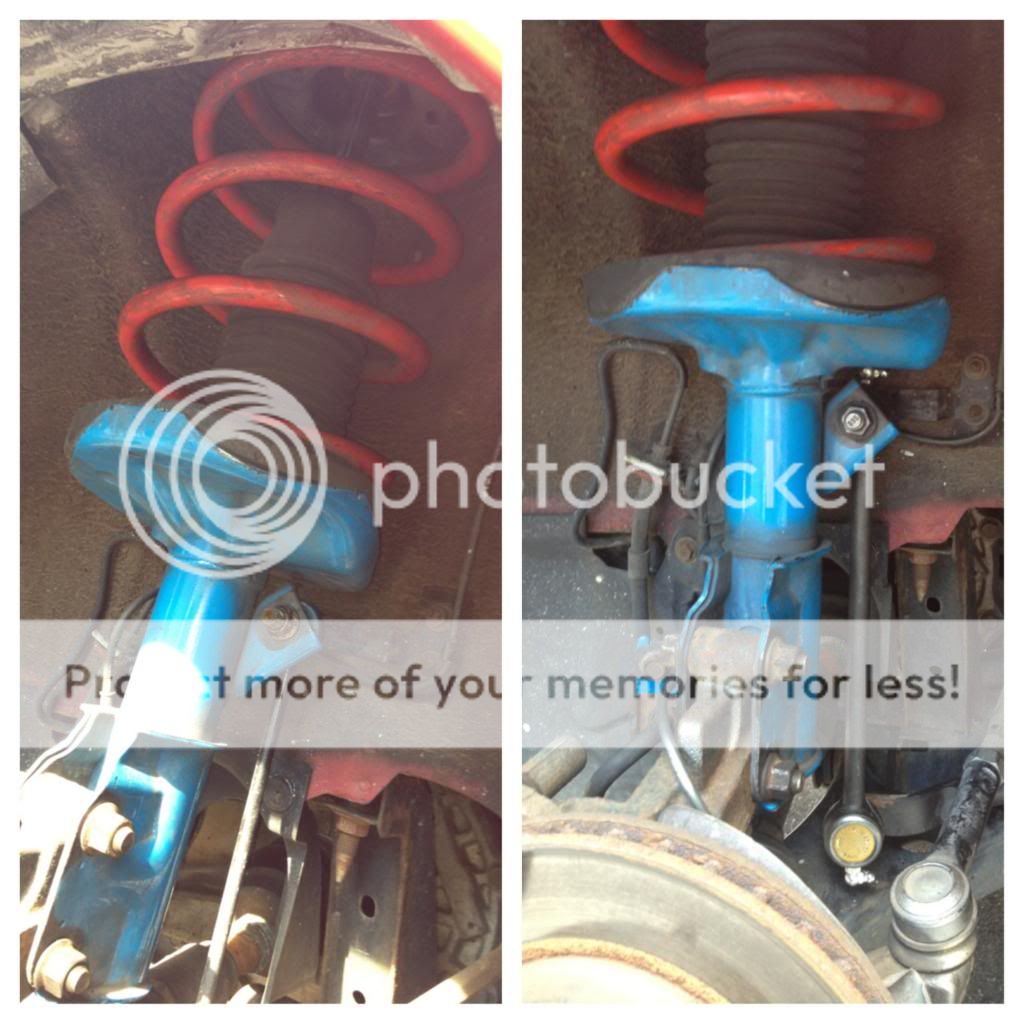

so I did the front struts and springs today. only took a few hours, would have been done in under an hour except the passenger side end link nut was seized and I ended up stripping it. after playing with vice grips for an hour I torched it up and held an Alan key in the screw (spinning freely) as I used pliers to slowly undo the nut.
I'm waiting until tomorrow to do the rear struts and take my hatch apart, also for the rear sway.
just drove around the block briefly and I noticed the springs seem stiffer but less "clunk" when I go over northern state potholes. didn't notice much of a drop, maybe an inch tops which is sad because I was looking for more. oh well, maybe ill buy some used eibachs springs in the future. I'm hoping it'll look nicer once I do the back, but then I can't wait to rally around town and hopefully fall in love with the suspension improvements!
Noticed a strange sound.. Seems to be coming from driver front strut area. Its a faint pop/click sound that I notice when turning the wheel, mostly while moving slow or parked. Could this be endlinks or strut mounts possibly?

New strange noise coming from (what seems to be) the driver front wheel area. It occurs while parked or going very slow in first or second gear and only when i turn the wheel. It is kind of a clunk or "skrrt skrrt skkrt" noise that clicks as you turn the wheel left and right. I noticed this after I replaced the end links, not before so I dont think it is a blown strut. But, could it be that the ford escape endlinks were a TAD shorter than the p5 or perhaps that I need to regrease them again? (You can see the fitting for the grease gun on the right picture posted above)- I did grease them but would doing it again to any justice?
Thanks!
