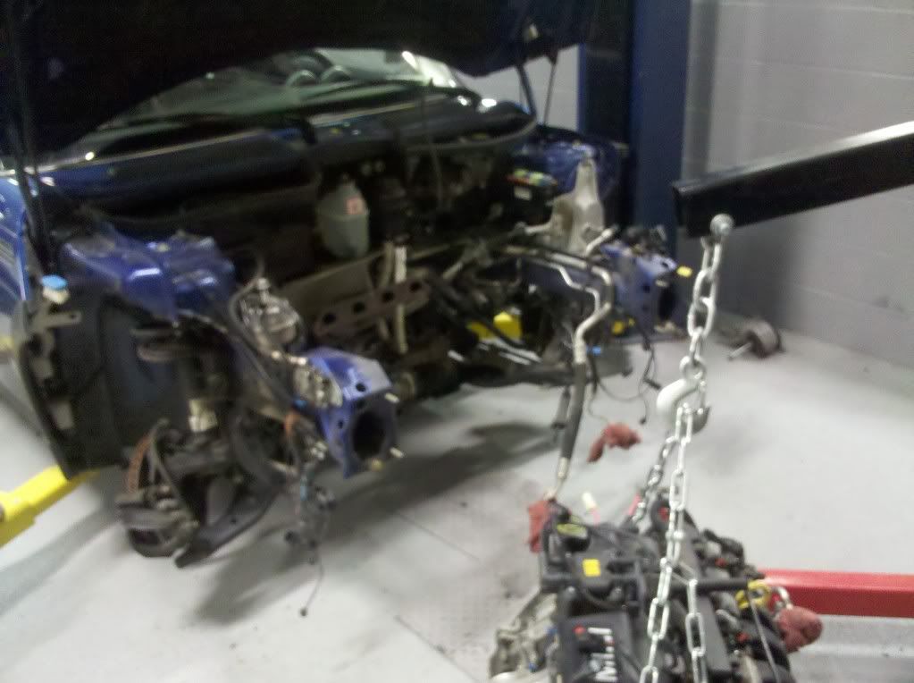

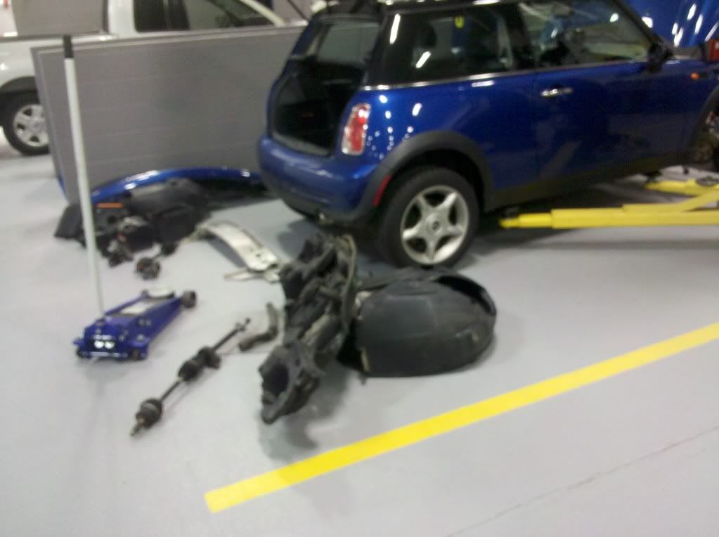

This is the second one in a month. I had to pull a 6spd transmission on an "S" model last time... learned how to get the front clip and all that stuff off pretty quickly.

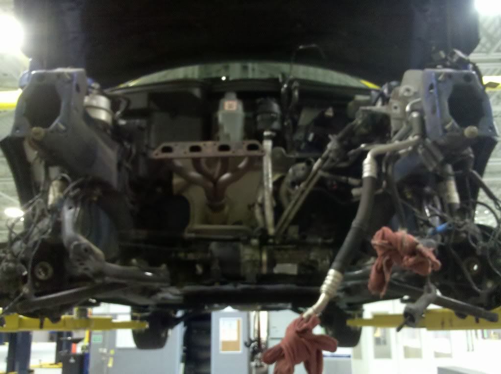

This particular one is getting a new(used) engine due to low compression on cyl 4(scored cylinder walls)... I had the engine+transmission out in about 4hrs(drive)
It is kinda nice that you don't need to mess with the power steering at ALL... it's an electric pump and everything stayed on the firewall/subframe. I got away without pulling the subframe on this one by just dropping the engine a few inches then rotating everything counterclockwise and pulling it out engine first. They're really not too terrible to work on... just so much stuff to remove to get at what you need.
Honestly... to replace the starter it is almost easier to pull the motor to get to it than it is to drop the sub frame to gain access to it. Especially if you factor in that it won't need aligned by not dropping the subframe. (boom06) On the S model that I did the clutch on last time, I dropped the subframe and kept the motor in the car, only pulling the transmission. It was honestly harder to do because of the angles you needed to get everything out at... but also the 6spd is considerably bigger than the N/A 5spd this one has. Not sure if pulling the engine+trans would be possible like this in a supercharged Mini.

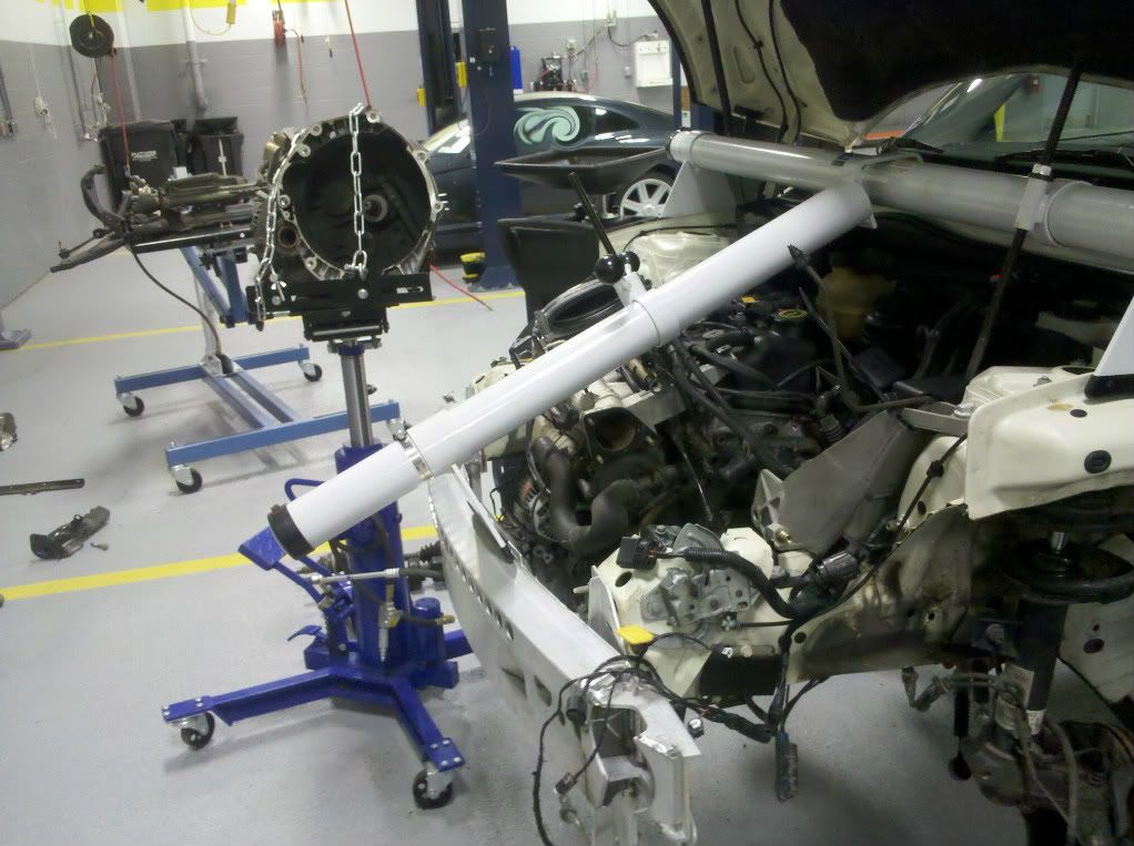

Here are pics from the "S" model clutch job... there was considerably more crap on the ground, partially because it's supercharged, and partially because the sub-frame had to come out to facilitate the trans coming out at an angle. Also had to use the goofy 3-point support and put the aluminum cross brace back on the front because there is nowhere to put that support otherwise.
