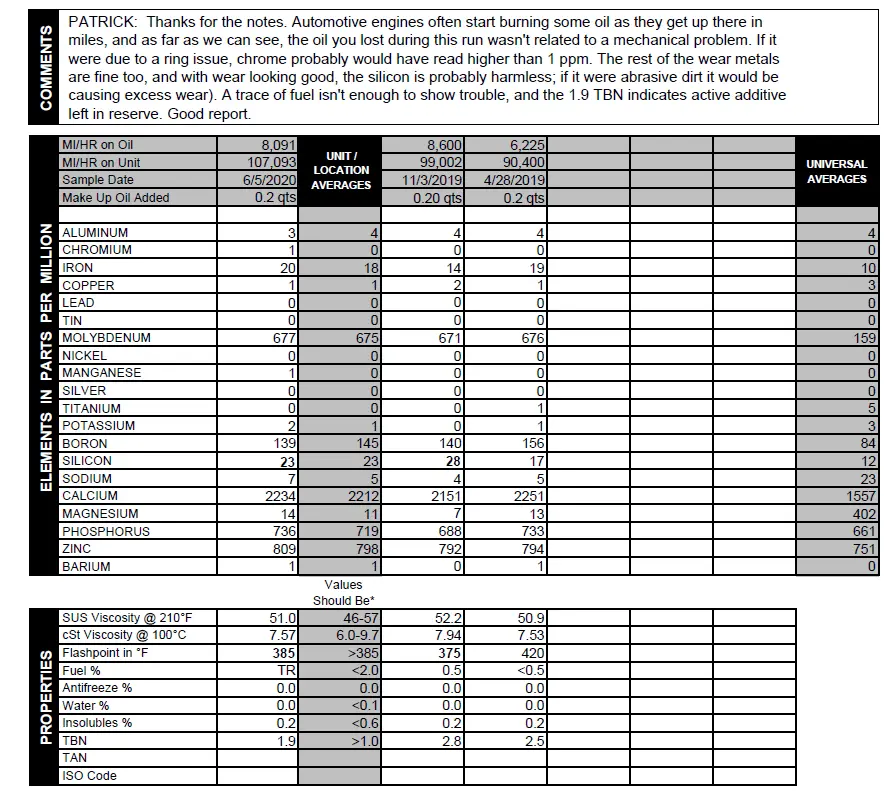

Recently got another UOA report back. I'm having to add a quart of oil between drains on a 8K mile oil drain interval, so I probably will not try stretching it out to 10K miles. I'll just have to start buying an extra quart per oil change to keep on hand.
Need an important info, what kind of oil did you use?
My guess is you used Mazda moly 0W-20.

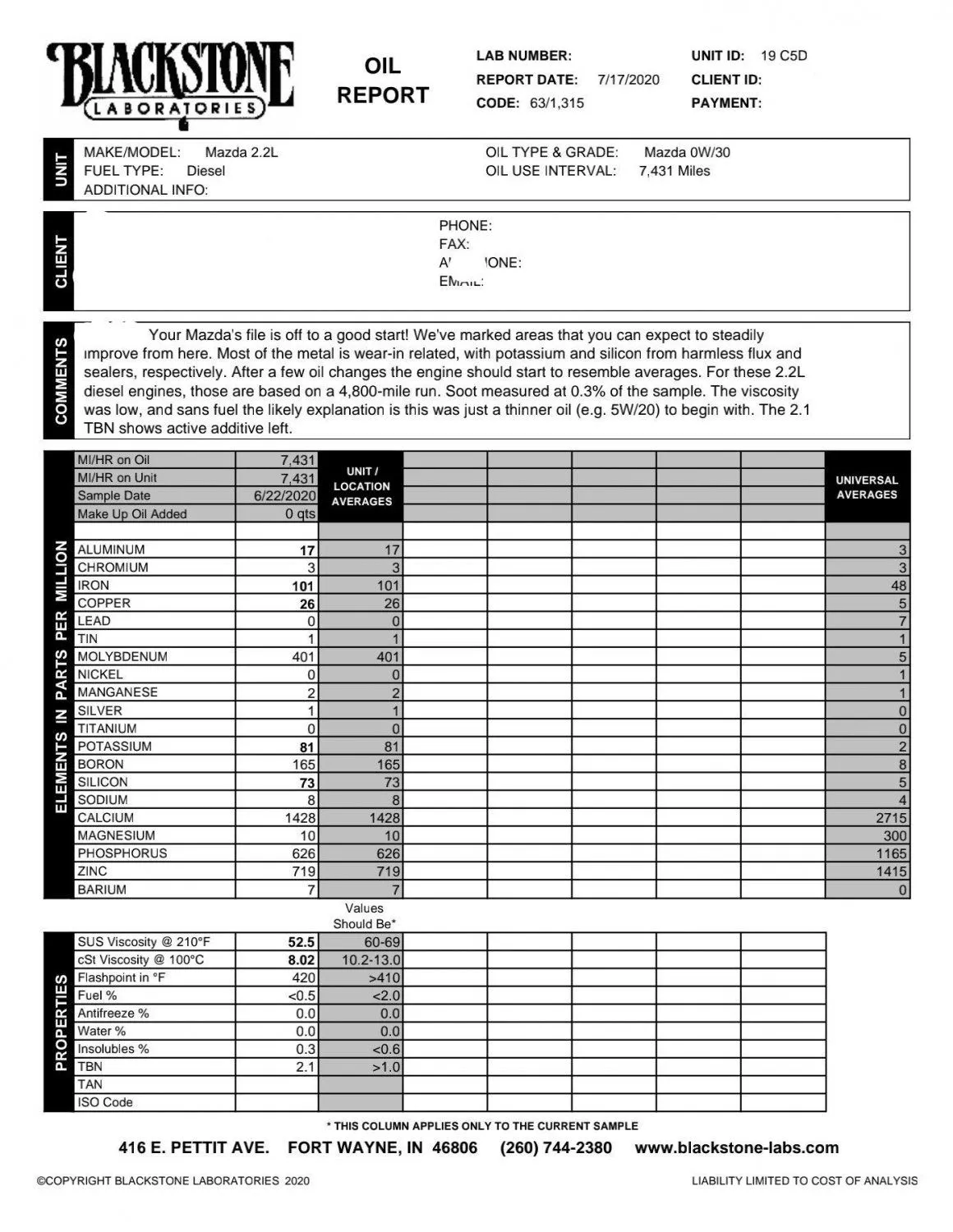

Since I have free oil changes for the first 2yrs /30k miles I figured I would do some UOA's. This is the first change of the factory fill so I figure it's been in the vehicle since 06/2019 (into service 02/2020). Who knows how much idling it did in it's first 8 months of life on the dealership lot. Interesting the viscosity is so low and will be looking to see if it's the same results next change with known bottled 0w30 Mazda diesel oil.
A North American 2.2 skyactiv-D ....

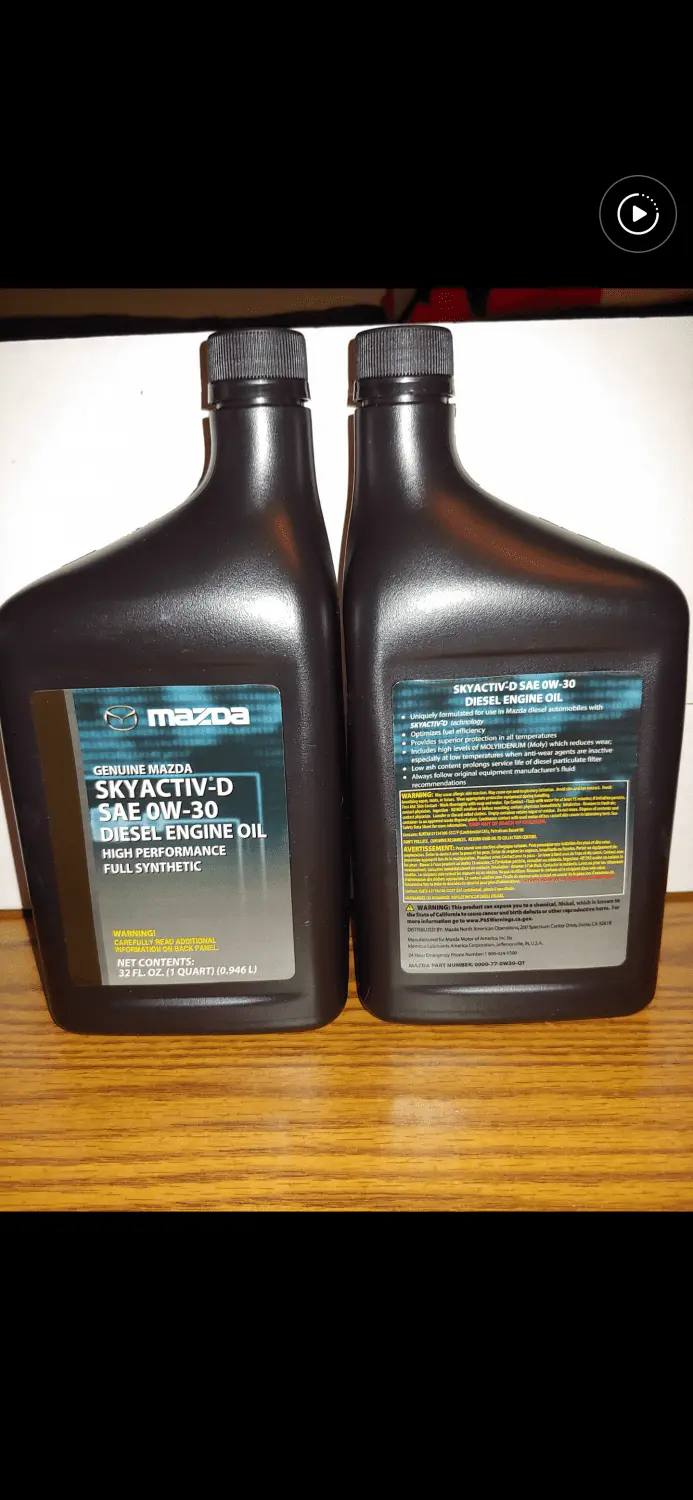

So what is “known bottled 0W-30 Mazda diesel oil”? Is it Mazda OEM 0W-30 oil used only for SkyActiv-D 2.2L? Is it ACEA C3 oil?
Yes and Yes. Mazda [branded] oil from Mazda dealer.
I found (as I suspected it would be) that it's not something my dealer keeps on hand and talked to the parts guy about a month before I needed an oil change to buy 6 quarts and a filter to have on MY shelf to make sure it's available when I need it. So, just based on Blackstone's comment on viscosity being low could be because it never started out as 0w30. I can't vouch for what the factory put in it and I didn't pull a sample when it was new. So if my next UOA shows the same low viscosity then perhaps it's getting sheared and we'll go from there. But if it shows a viscosity that one would expect from a 0w30 oil then maybe the factory fill wasn't.
My main thought was to see if any fuel dilution was going on, how much soot / insoluble and TBN to determine if Mazda's free maintenance interval of 7500 miles is gonna work for me.
I may pull a sample at 5k miles on this fill and set it aside to test should this sample come back with a lower than expected viscosity again we can check out the 5k mi sample.
Interesting. Looks like this OEM Mazda SkyActiv-D SAE 0W-30 Diesel Engine Oil is also made by Idemitsu just like Mazda Moly 0W-20 oil. Your factory oil has high contents of molybdenum than other oils, almost like Mazda moly 0w-20 oil which has 600 ~ 700 in UOA report.
Wow, that is a thin oil.
Thanks for the analysis. I think it's the first diesel we see. Check it out next time, it would be interesting to compare.
I would try at 5k miles if you are ok with that.
