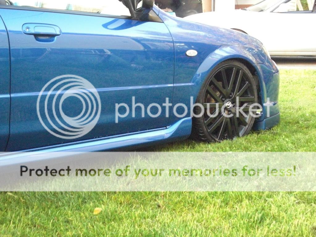

without side moldings
and jean i bet its way easier to wash !!! i always miss spots under that darn door bumper haha
