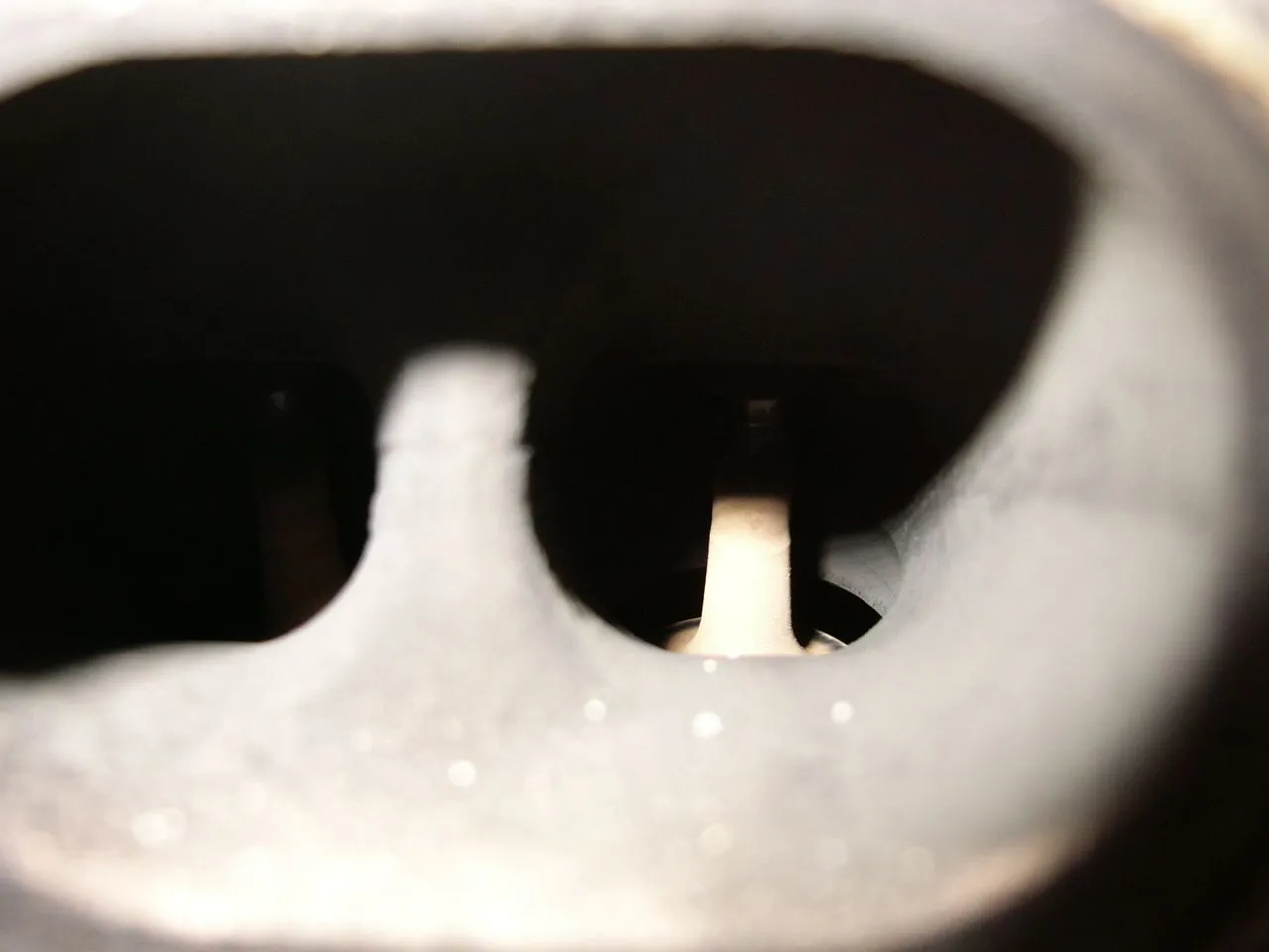

umm.. about the valves resealing.. the valves are pulled up and sealed with the valve spring, if there was backpressure wouldn't it try and push the valves down/open? a vaccume in your exhaust manifold will force the valves shut? i thought the only reason to have back pressure was for velocity of exhaust,
theoretically you want super velocity going out and zero back pressure
I could be wrong on my reason.(mswerd)
There was a negative to no backpressure. I'll admit that my theory is shot out the window...Ummm. I'll read up and get back with a better solution.
