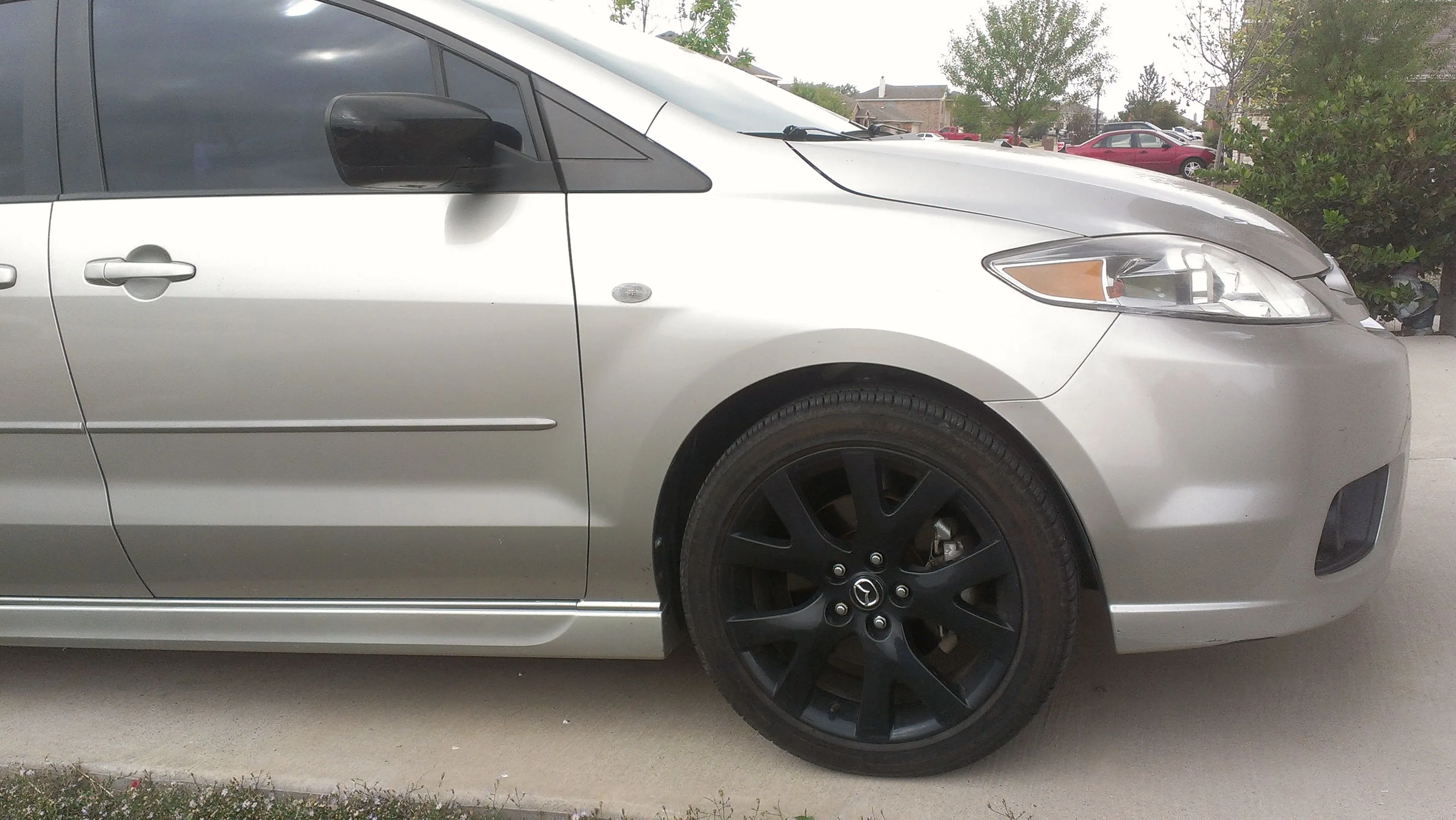

Nice. Are those the CX-7 or CX-9's? I always loved the idea of swapped wheels from a different model in the brand to make it look unique but also stock. RX-8's are played out for us unfortunately as are the MS3's (quickly). Maybe I should get some custom Diamond Auto Wheels made. 18x10's... lol

You said you were using rx8 wheels right? What was the offset on those?
I am using 19x8.5 in the front wi an effective 45mm spacer, no rubbing during normal driving. You might get away with just a 5mm spacer if you're trying to push it a bit.
Ah. So I'm assuming the rx8 wheels are also 18x8, so you may get away with using a bolt on 15mm spacer, but it may slightly poke out. Since the coils have camber plates, you may be able to run the 15mm spacer without rubbing the front fenders. My front fenders are not rolled, if you were wondering.

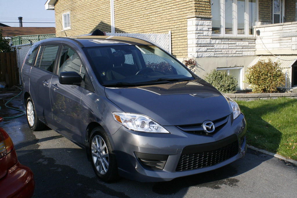

here is my 5 that i am in love with ! had alot of JDM cars in the past (240sx, mr2, ae86, cedric) but buy far with the 2 kids is the best and most confrtable. Also most reliable ah ha
