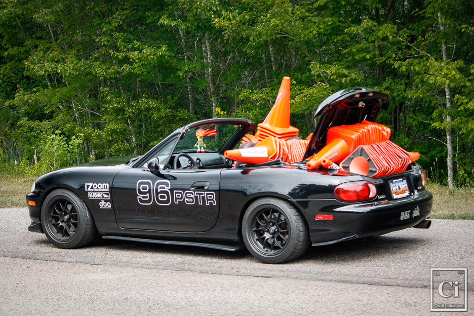

You'll love an NB man, they feel SO much lighter and smaller than NC's, plus you can make em look like this ;)
Wow, are those all brand new cones or is everyone in your region REALLY good? Sweet looking NB though. NB1's FTW!
Your car does look pretty awesome. I do like they NB idea because then I can use the really awesome Konig Dial-In wheels I have on my 2 right now. I'll probably put it off for a little while though because I have a 85 Caprice I'm converting into a muscle car that I want to throw some money at first.
