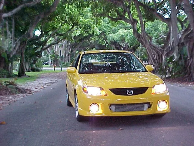

maybe hes trying to put it in upside down? lol just a guess?
and by looking at spools pics its a possiblity.

heres one of spools car, thats all i got.

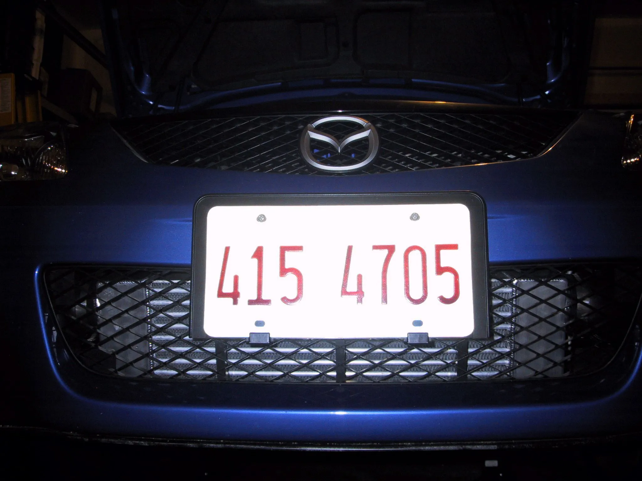

I posted a picture of my intercooler and bumper in the forced induction forum. It is worth checking out. Worked very slick. I kept the bumper "functional" and got the intercooler in a much better position. The "stock" position for the intercooler of the Spool kit was unacceptably for an anal retentive engineer like myself. So, I HAD to modify it.
It worked out very nice. Here's a pic of the finished product. If you need more details I can help, but I'm guessing you're probably "done" already.
