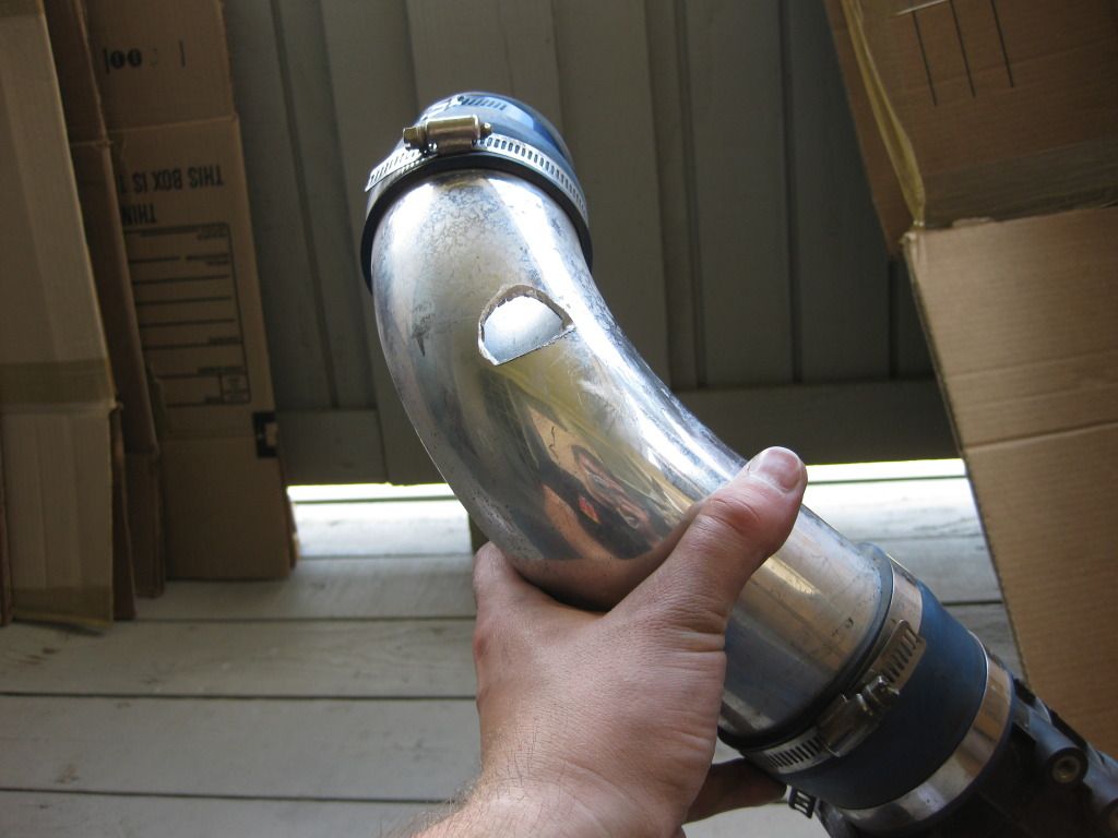

i'm pretty sure i found the problem.
it's on the back side of the CAI near where it meets up with the throttle body. I could never have seen it if i didn't remove it. It looks like it was cut out with a tool by a previous owner (don't ask me why). I closed it off with several tightly-wound layers of tape and I think it's fixed now. I drove it around for about 5 miles and my long term fuel trim went from about 10% to around 0%, and the idle stabilized again. I want to drive it around a bit more to make sure, but i can't imagine it wouldn't fix it.
p.s. i have no idea why the revs would not have increased when i sprayed around it with brake cleaner and instant start. i was sure because of that that I didn't have any leaks in the piping. oh well.

I looked around for anything it would have been rubbing against that might have done that (especially since getting a big chunk of Aluminum in the intake should have been catostrophic) but it looks like it was cut out with a dremel or the like. Why? beats me. i'm the 3rd owner of this car and the original owner liked to mod it. Konig rims (not bad, actually), an amp in the trunk, a better stereo (although be put the factory one back in afterward, with a few missing garnishes), NEON LIGHTS under the front and rear bumpers that were integrated with the stereo, a car bra, and a couple other things that i know are there but aren't coming to mind just now. most of the engine mounts were completely torn, so he liked to hot-rod it too.
This is my best guess. The lean condition would make the ECU compensate for it by putting too much fuel in (hence the 10% Long-term fuel trim) and inducing a rich condition. The result is more explosion and more power (since the normal map trys to maintain the mixture just slightly lean for economy). Admittedly, the car doesn't pull as hard as before. It was hard not to squeal the tires from a stop, but now it's more tame. The effect, as well as I can surmise, is the same as "chipping" your car to get more power out of it--just cheaper.
I that was the pipe by your throttle body then that looks like to me it was rubbin on the master cylinder reservoir
correction to my previous comment. It was definitely rubbed open by the master cylinder. I guess I didn't take a good look at it when I put it back in, except that the code came back because the master cylinder wore away my band-aid fix. Idiot move on the PO's part to put in a CAI that didn't fit without any interference.
