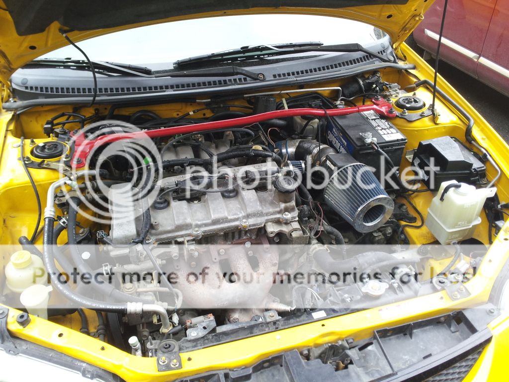

Alright, so, we finally got some time to look at the car yesterday. The headlights are actually missing. You heard right, missing. She thinks they installed an HID kit and it was removed before selling it to the dealer. Coolant level was fine except the overflow tank was a bit low so we topped it off and drove the car for a bit. Coolant temp gauge was fine after a 3 mile loop but after the car sat for about 1 minute we noticed so heavy coolant bubbling in the overflow reservoir which had the water level almost to the top several inches above the full-mark line. The bubbling subsided while the car idled but it was still bubbling. The driver's side fan kicked on/off like any other fan would and the A/C fan turns on properly as well so that leads us to believe the thermostat is working properly as it warmed up quickly (not permanently open) and it didn't overheat immediately (not permanently closed).

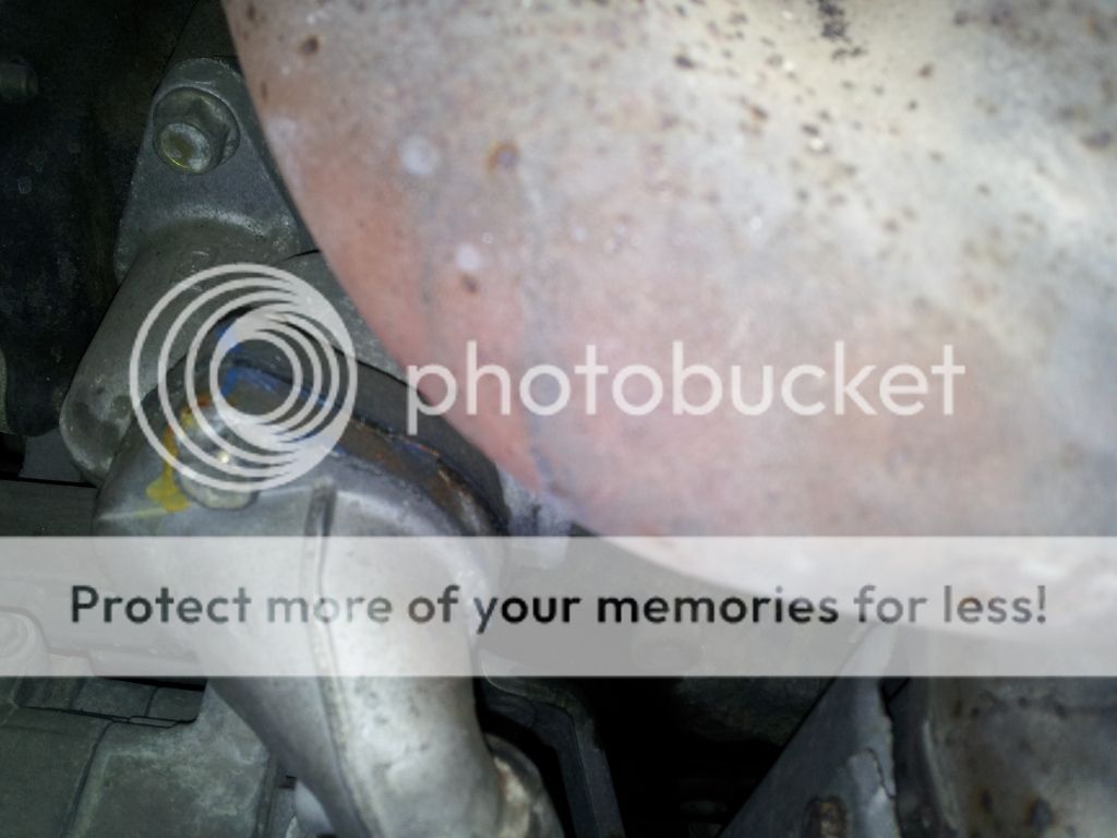

• The thermostat appears to have been replaced, evidenced with some fresh sealant around the thermostat housing

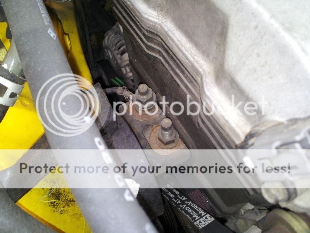

• The bolts on the water pump pulley seem untouched

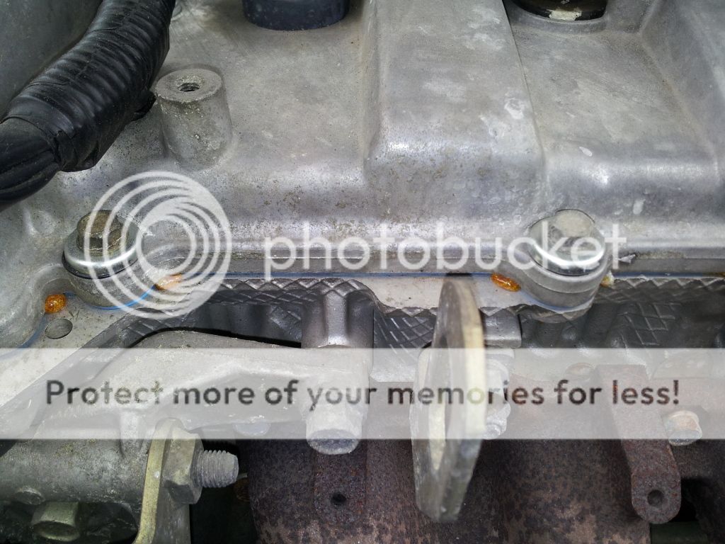

• The bolt seat on the valve cover bolts are new and there is fresh sealant around the valve cover showing it was removed and replaced sometime recently
