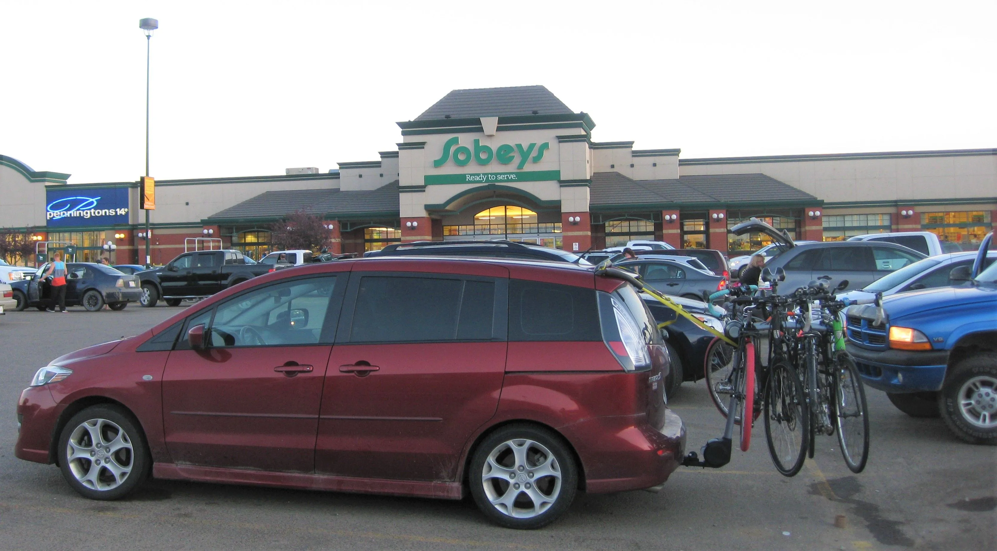

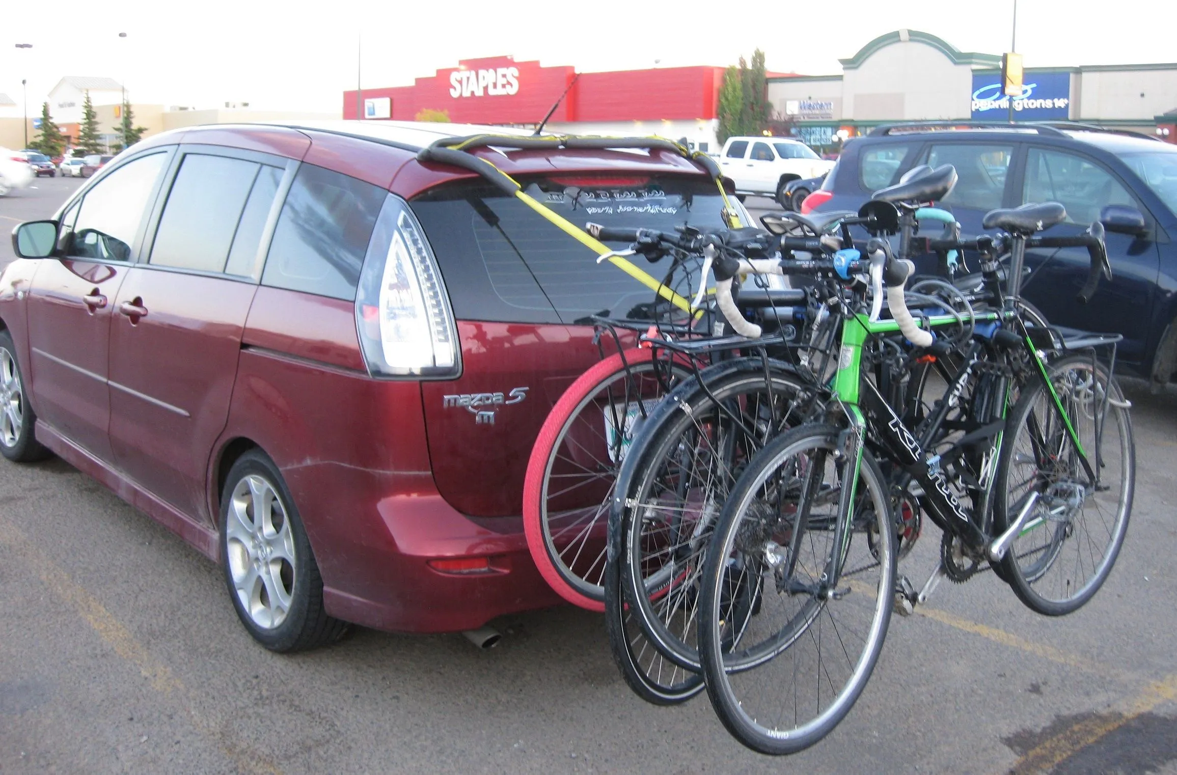

Hey, one thing to be aware of ... the 5 is not rated to tow, although I did add a towbar (hitch) solely for the purpose of hauling our bikes around. Class 1 (1-1/4") is the only hitch available. We have a Thule 4-bike carrier, and they specifically say to not load it up with four bikes when the carrier is used with a Class 1 hitch. Oh oh!
My workaround was to add a ratcheting tie-down strap to take most of the tongue weight off the hitch. Worked well for us.
