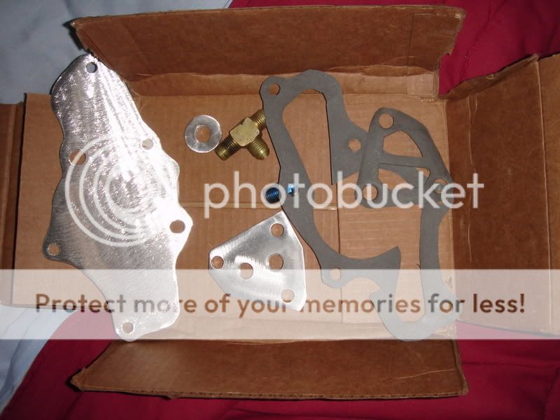

Water Pump Block-Off Plate (and Oil filter block-off)

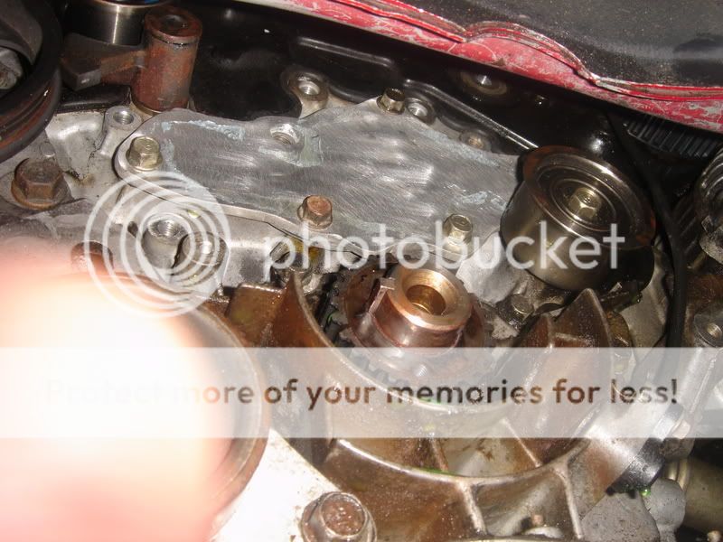

Installed Block-Off Plate (and my beautiful thumb, which is blurry, but trust me, it's beautiful)

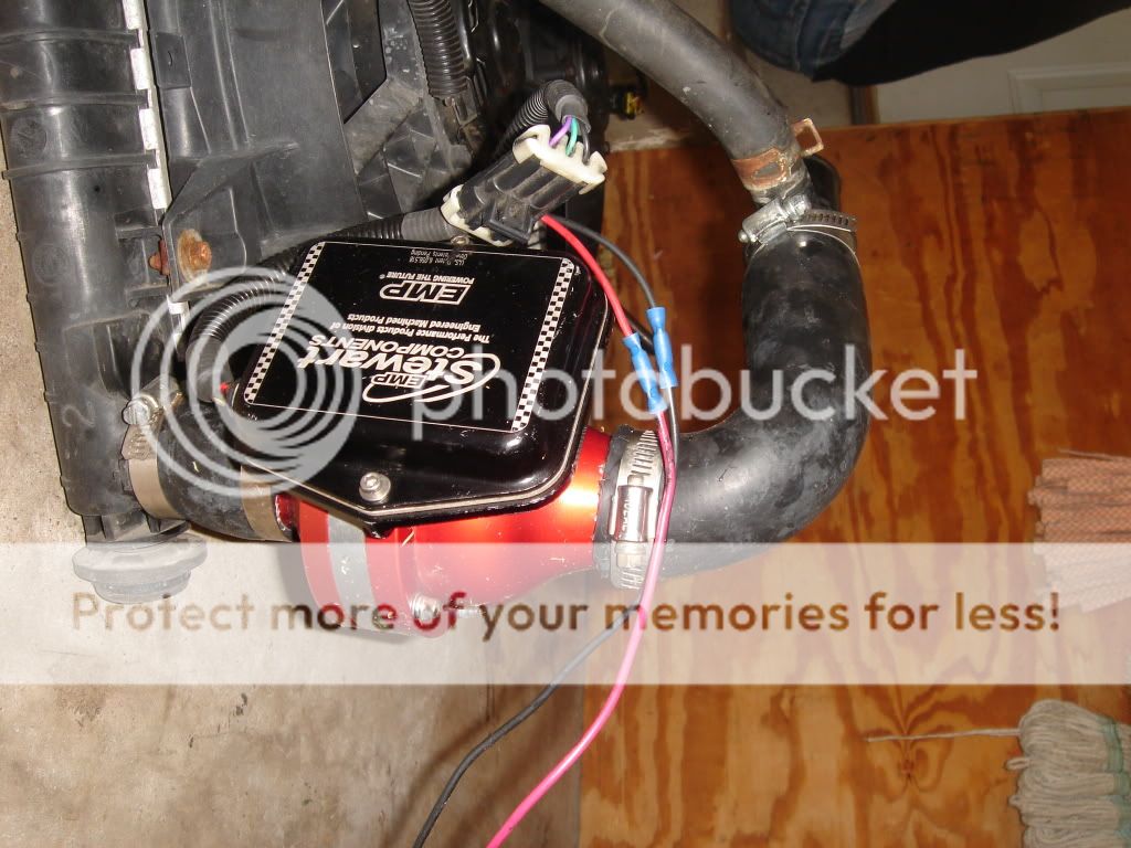

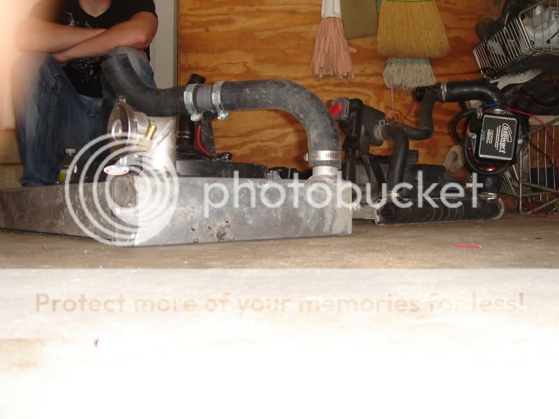

This is how the pump was attached to the old stock radiator

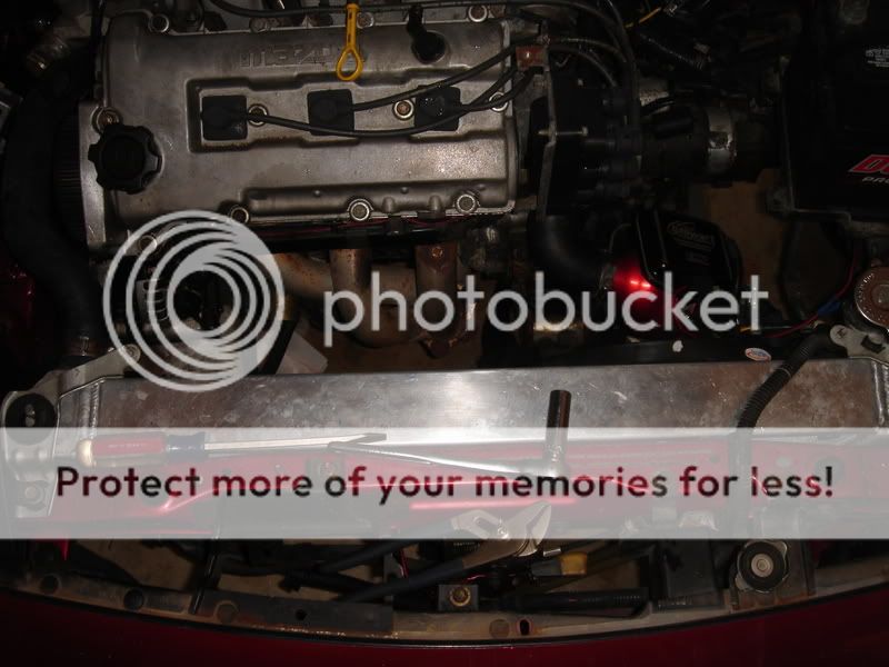

New Hotness (borrowed from Jarod for the time being)
Old and Busted....New Hotness

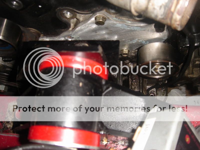

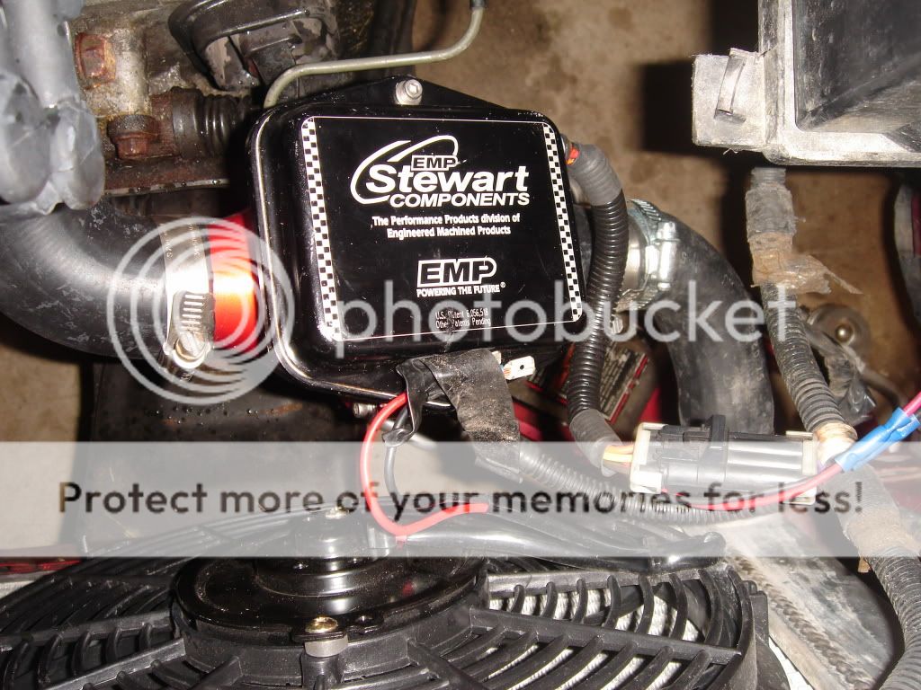

New and MUCH Improved Pump Location

The car takes a long time to get up to temperature, a long time. But once it gets up around 180-190 degrees it just keeps getting hotter and hotter. If I turn the car off, the motor cools down MUCH faster than it used to, if I just let the pump run with the car off. So I am not sure what is going on. Like I said I will wire up the second fan (which I don't think will matter) and check the thermostat, maybe even run without it and see if it changes anything. I will update this thread, since this is the way the setup will stay for the most part. Thanks to Jarod and Chris Pace for the radiator and bringing it to me!
