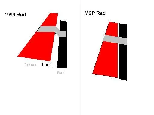

the 99-00 radiators are different than the 01+ ones yes... this is because the core support is (obviously) different due to the different from facia
as far as the radiator brackets goes, the passenger side one will definately work, not sure about the driver's side one as mazda changed the intercooler design between the 99-00 turbo diesel models and the 01-03 turbo diesel models... yes, that's where the radiator and intercooler is from

Edwin, just look at the diagram I drew. I'm so sick of arguing with you. I can't make it any clearer. And unless the radiator sits crooked in the frame, which last time I checked it doesn't, the brackets need to be uni-level on both sides.
I'm talking about using the MSP radiator brackets... I know for sure the passenger side one will work
stop arguing with me, I know what'll work and what won't
you obviously don't read my posts thoroughly which would explain a lot of things. I previously said twice that I didn't have the msp radiator bracket or the msp smic bracket. go back and read
I already know you don't have them... so I'm telling you to go get them
stop being a cheap ass and buy them from the dealer... they're CHEAP anyway
Again, you didn't read my writeup. Did I not say that the machine shop was right next door to the shop and it took less than 30 mins to fabricate them? Why would I order them from the dealership? It's a 45 min drive to the closest dealer, 1.5 hours round trip. Or I could order them from the dealership and wait two-three days for them to arrive because that makes a whole lot of sense.
