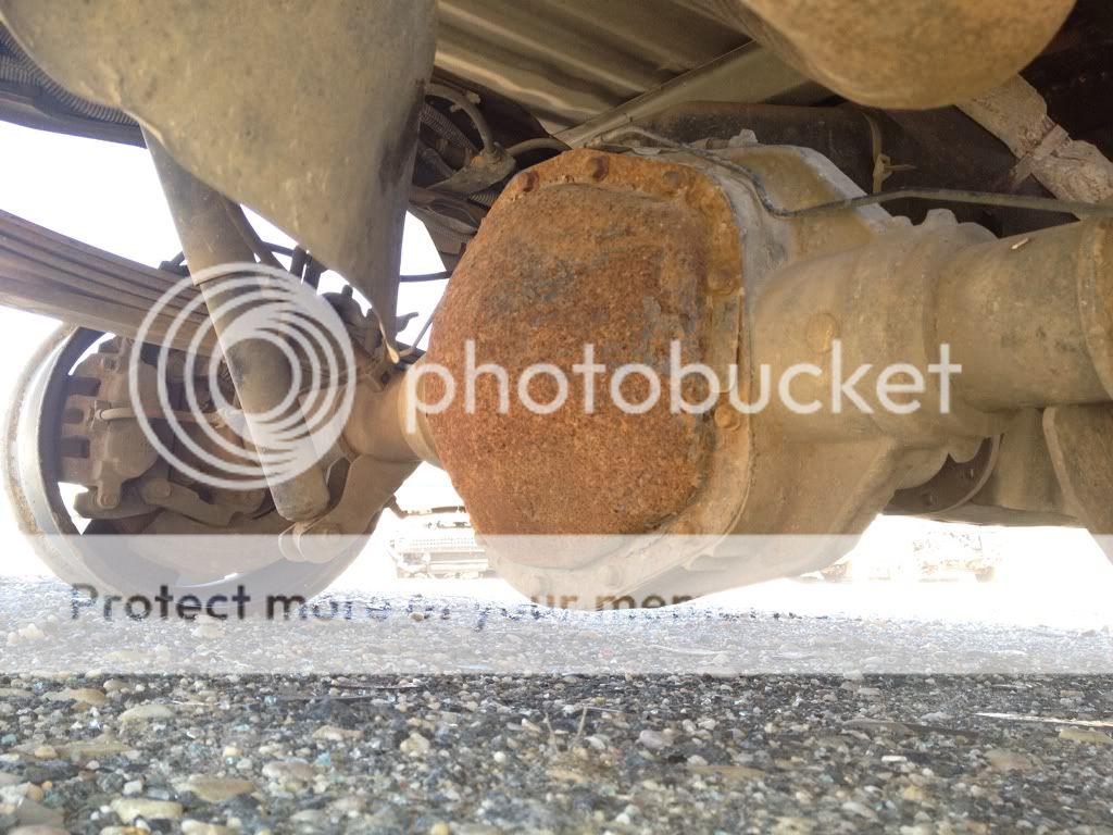

Ford 10.50 with disc breaks rear axle! I still need to find an Dana HD60 front axle. It's a lot of work to get them in but it will be worth it and will NEVER break.
