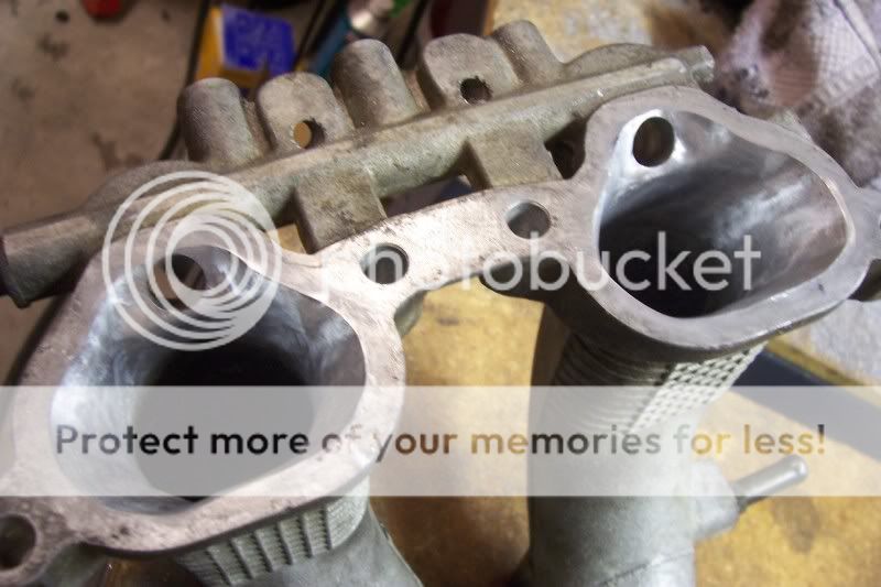

Good news is I will be replacing the bad block with a 2.5 NA block from any 99-04 Subaru with my 2.2 heads/manifold(high compression!), port and polishing and port matching heads/intake manifold, new clutch, light weight flywheel, and 2.5L cams in the 2.2 heads

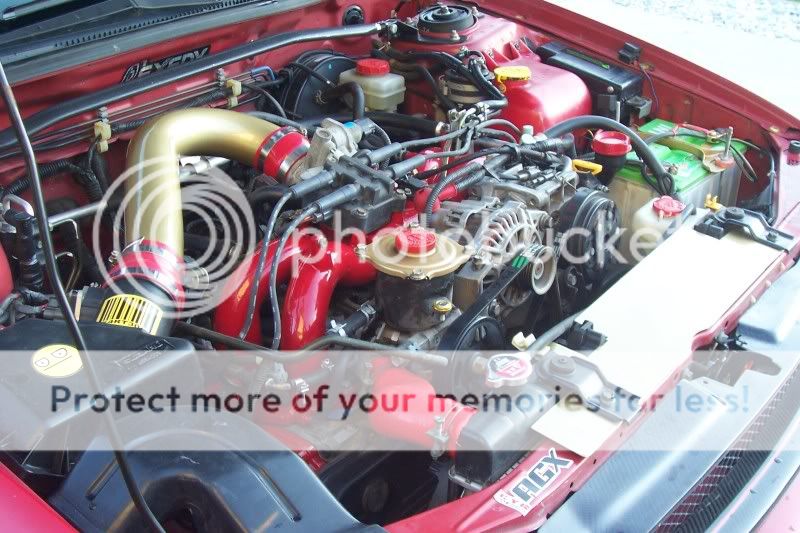

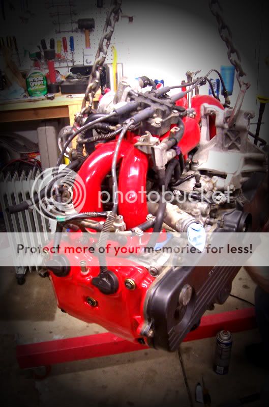

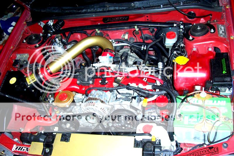

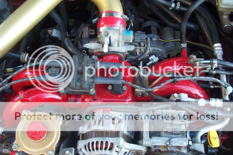

Swapping in a 2.5L(from my 2.2L with single port SOHC heads) with 2.5L SOHC heads(descided to go with the 2.5 heads for they are dual port instead of single) with port/polished/port matched heads and intake manifold, stage 1 exedy clutch, ACT lightweight flywheel, and lots of powdercoated goodies! Look below for some teaser pics. Almost done!

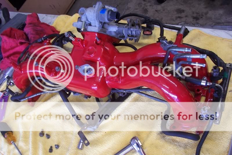

Should have the swap done this weekend. Just have to get a ball joint in, intake on, and check everything and then will be ready to start it up for the first time. Praying that no other problems come up. I had a few snag's with the intake manifold wiring but got that resolved so everything should work out just fine. Here are a few teaser pics to show some of the powdercoating I got done lol:
Should have some more pics up in a few days when I get the car up and running. Probably will have a sound clip to for my new duel port heads and headers(last setup was single port).

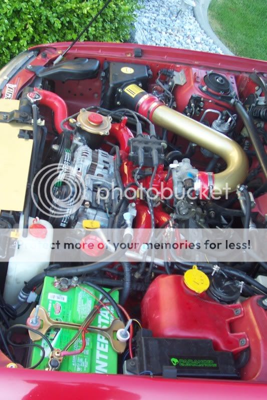

6/23/11 UPDATE:

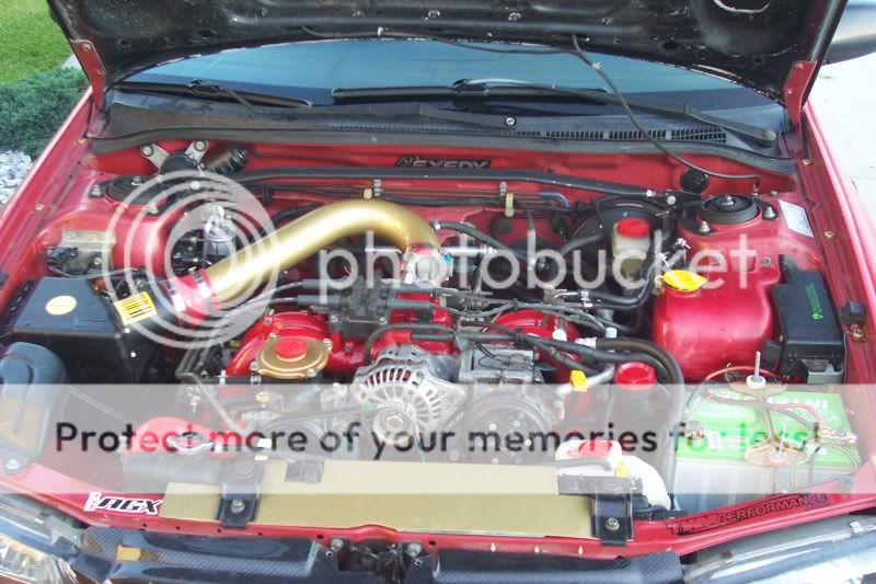

THE SWAP IS FINISHED!
Got it done earlier this week. Runs amazing. Great torque, acceleration, and rev's up faster than you can blink! I love it!
SPEC'S:
  • 2.5L W/ 2.5L SOHC HEADS
  • PORT/POLISHED/PORT MATCHED HEADS AND INTAKE MANIFOLD
  • EXEDY STAGE 1 CLUTCH
  • ACT LIGHT WEIGHT FLYWHEEL
  • BORLA REPLICA DUAL PORT HEADERS
  • POWDER COATED INTAKE, VALVE COVERS, RADIATOR SHROUD, OIL CAP, AND INTAKE MANIFOLD
PICS/CLIP!:

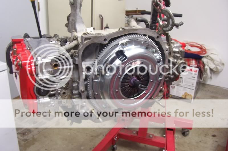

WHEN I GOT THE BLOCK BACK AND PUT CLUTCH AND FLYWHEEL ON:

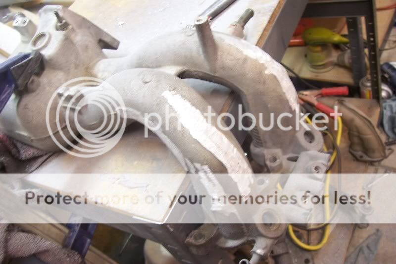

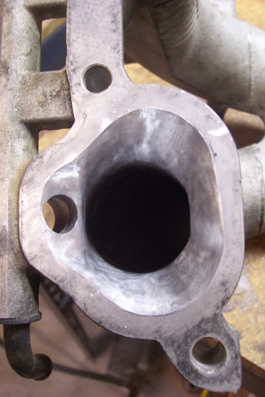

PIC'S FROM WORKIN ON THE MANIFOLD. PORT/POLISHING/PORT MATCHING:

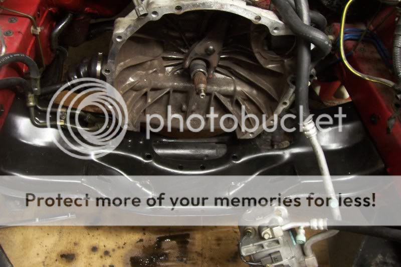

CLEANEST CROSS MEMBER EVER. CLEANED HER UP BEFORE PUTTING THE MOTOR IN:

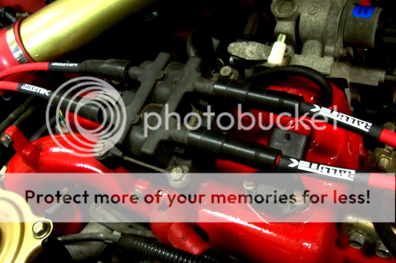

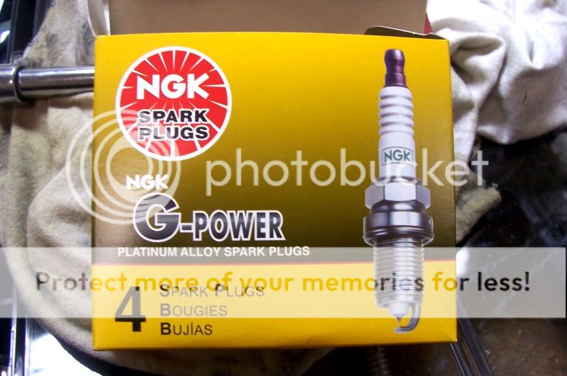

Hey all! I am have been meaning to get an update up for you all but have been working 55 hours a week at a total of two jobs and then you have a family with two young kids in the picture it is hard to have much free time :lol: . Not that I am complaining. I love my family :D. So any who after the swap my car was not idling that well so I did some pocking around on the motor and found one of my spark plug wires was falling apart. I also found that the standard NGK plugs that were put in my motor are not quite right for it so I went with a set of these bad boys:
NGK Platinums. So I then of coarse needed some new plug wires so gave me an excuse to pick up some Rallitek replacements(amazing quality, performance, and gas mileage BTW. Very impressed!):

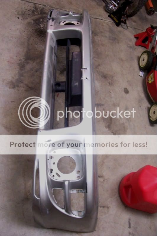

After all that and adjusting my valves the car runs great! Then onto the best part of all one of my buddy's with an RS replaced his bumper cover so he gave me his old one. It has a few cracks that I need to fix and repaint it of coarse. Then it will be going on my car:

Thanks guys. I love the bumper on there now too and was even thinking about making a fiberglass lip for it but the RS bumper has more sturdy fog light brackets, better locations for the fog lights allowing more air flow to the radiator/engine bay, they make better lips for this bumper, I got it for FREE from a friend, and this will also allow me to pass the blessings on to a friend of mine who really wants my current bumper since he has the older style impreza bumper so I am giving him mine.
