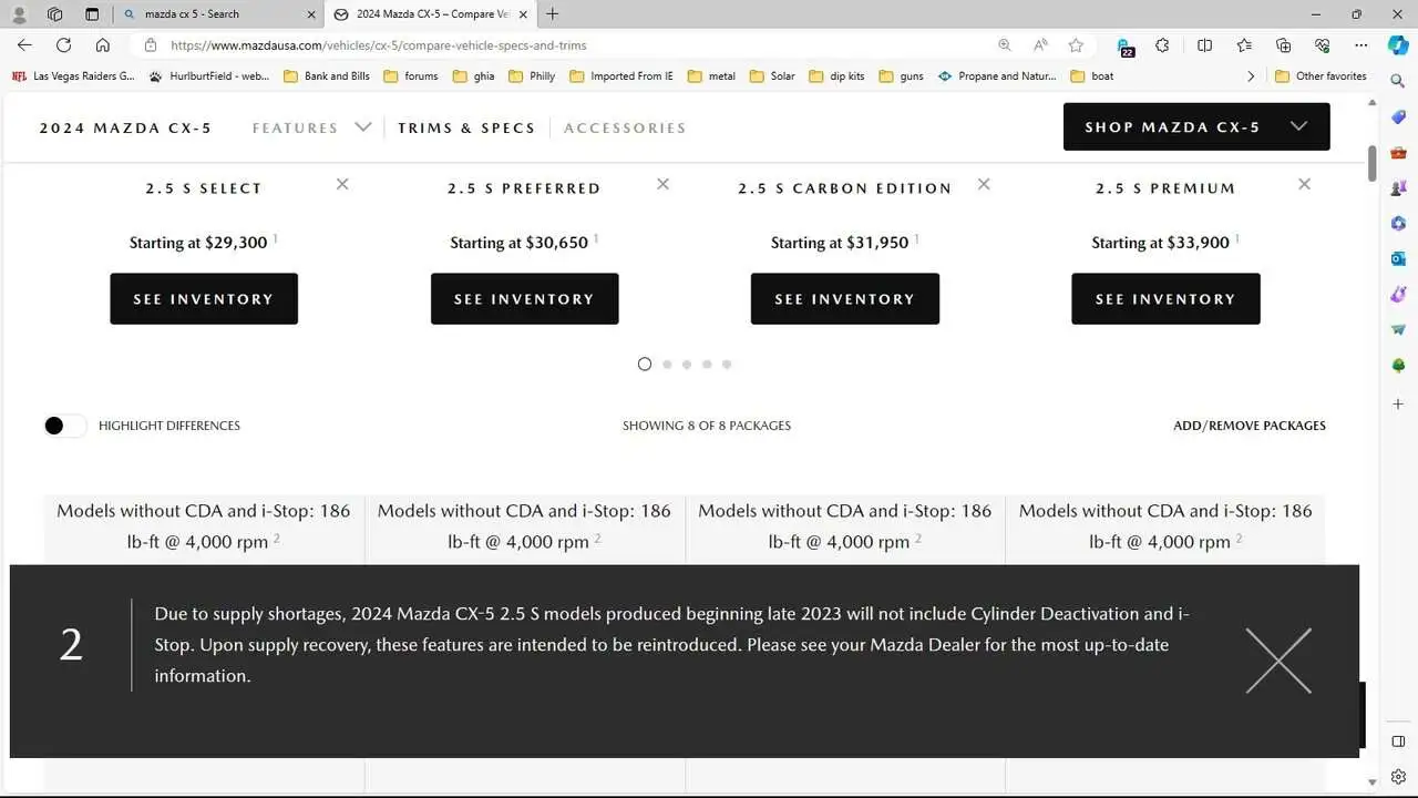

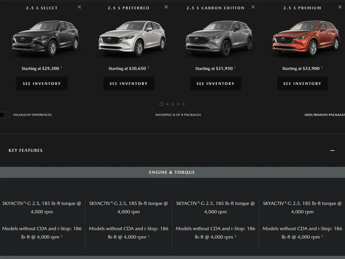

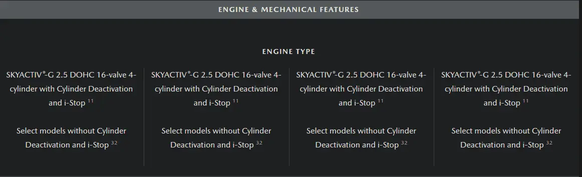

Went into the Mazda USA homepage and saw this. It wont say which particular trim is offered without CD and i-stop, but my guess is that Mazda is sending few batches of CX5's without CD and i-stop, to the dealers across the country.

In Canada. Mazda's website says the lowest two trims (GX and GS) have neither.
I noticed that too, although the Kuro and GT trims have both. However, all non-turbo trims of Mazda3 (sedan and hatch), CX-30 and CX-50 all still have CD, but not i-stop.
Seems there's a note pertaining to this. It is due to a shortage of something so late 23 until the shortage is resolved certain S models will not have i stop or cyl deactivation.

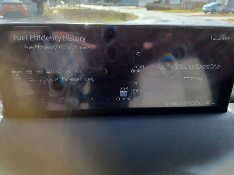

While driving, go into the "Information" option of your infotainment system. Then fuel efficiency--->energy flow monitor. You will see a picture of a car with cylinders firing. Light foot the gas pedal and maintain a constant speed. If two of the lights from the cylinders turn off, then you have CD.

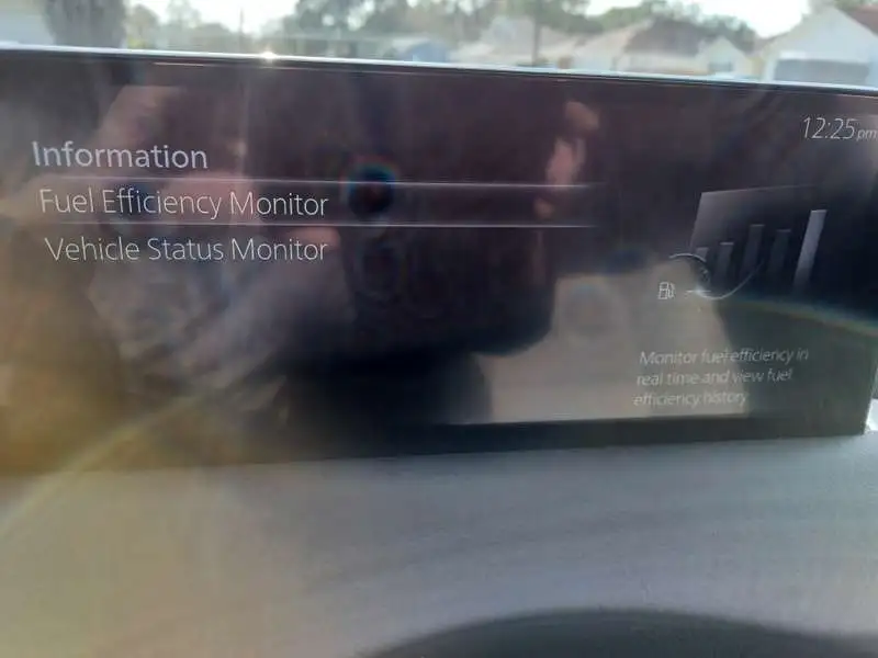

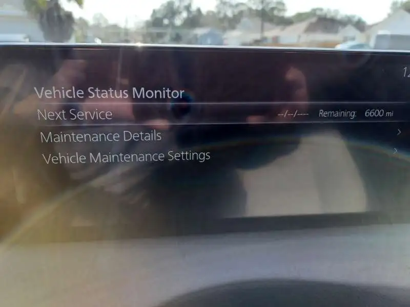

Mine doesn't have that. The info page has fuel efficiency and scheduled maintenance due/reset.

I just bought a '24 preferred as well in early March. The VIN number is the way to tell. An M in the 8th digit position means it has CDA and an L means it does not. If you don't have I-stop you don't have CDA... Also, the fuel monitor screen will show a front end of a CX-5 with the 4 cylinders going on and off as the CDA engages. Mine does not have that screen.
