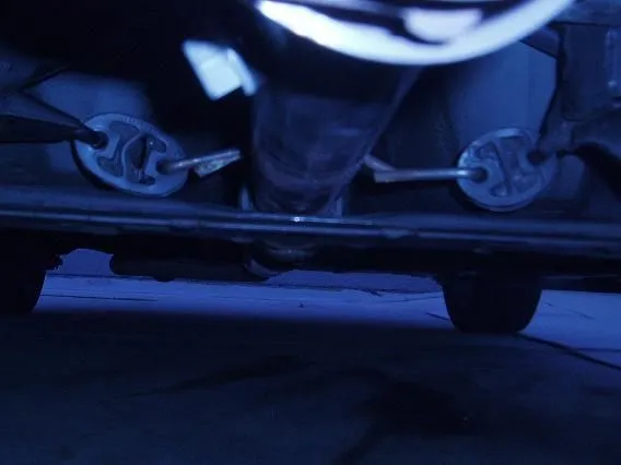

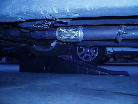

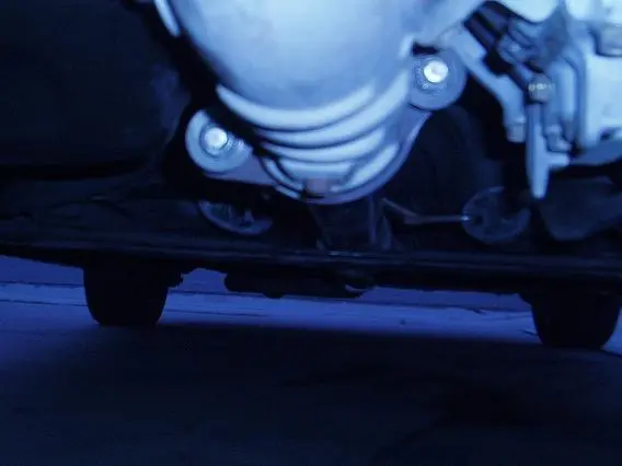

I just bought a MAM midpipe from Chris @ SPD Racing yesterday and installed it the same day. Great guy and price, also hooked me up with a gasket I didn't even use! Let me tell you that if your looking for a cheap mod with lots of gain then its a midpipe that will replace your second cat! Once I installed that badboy, the car was asking to be taken off those ramps. I'd say an easy 5-8 whp only for $75. I'm happy with everything other than the midpipe keeps hitting my crossmember which will hopefully be cured by adding 2 washers in between to give it more space. I'll try to take pics later on after I'm finished (rofl2)
Ok, the washers didn't solve the problem.. it still vibrates and clunks against the cross member!! ERrrrRrRR >=Z I'm now thinking of getting the GT SPEC Front 4 Point Ladder Bar from Corksport.com I thought it was fixed at first after I placed the washers in but it ended coming back when I floor or push the pedal slightly more than regular. Does anyone know what I can do because I don't mind buying the ladder bar unless someone can help me out.

the midpipe stretches out the stock rubber exhaust mounts..
you either have to bend the hangers on the midpipe so it hangs higher.. or buy aftermarket urethane mounts... which I did..
