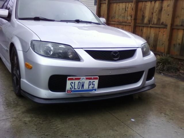

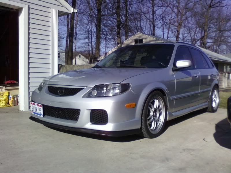

-Installed the JDP knock-off front lip. Just some minor trimming and tweaking and it bolted up. I think it looks pretty damn good too.
-Installed an eBay front license plate bracket. Took 5 minutes with some glue. I wish all installs were this easy... haha
I'll get some better pics when the sun comes out. It's been raining for the last 3 days.

Thanks for the link, Roy. But yeah, same lip, after some customizing. Ill write up the "How To" tomorrow with pics and all that jazz.

I finally got some pics of the finished JDP knock off front lip. I'll write up the How-To this weekend when I get the pics of my room mates camera. Let me know what you guys honestly think!
