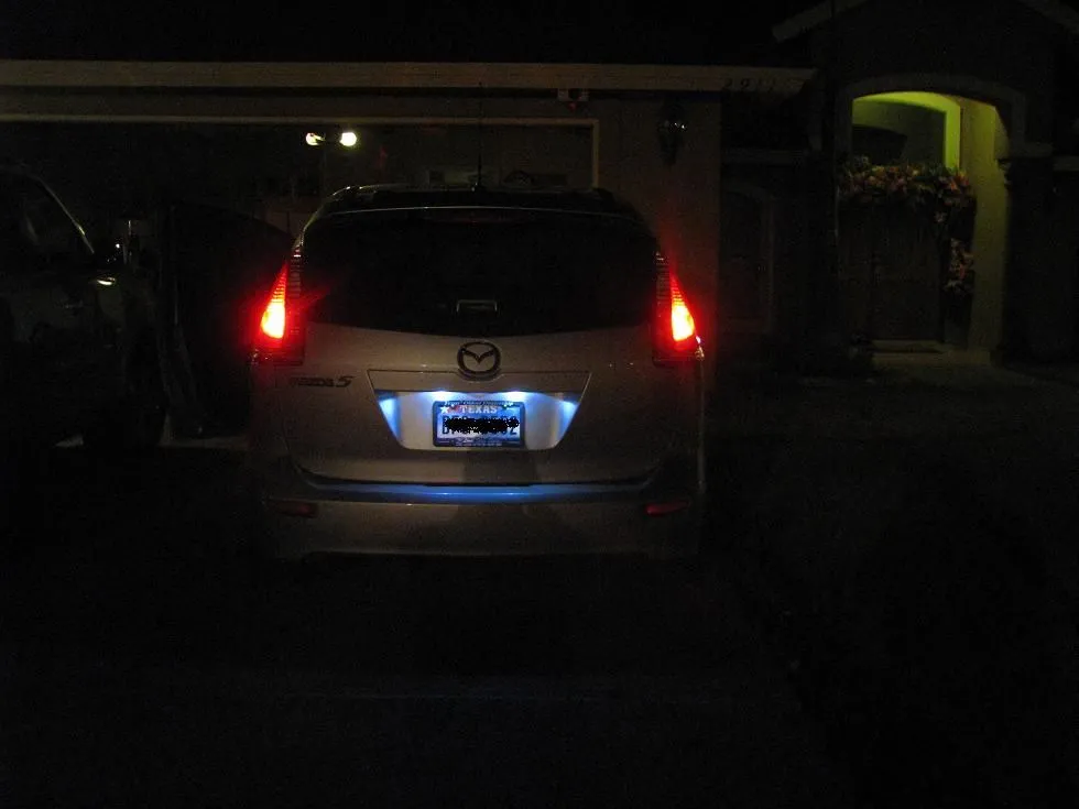

So i got some LED bulbs from V LEDs.. for my tail lights (Parking and turn signals) they are to be the best all around in the market.. i got the high power ones at 49.00 a pair.. I got in today and have been installed. Just waiting to get dark and some pics.
6634406
Can you show some pics of them in the tail light housing when they are on, and when you press the brakes?
you should get pics when its BRIGHT out, because LED's typically arent as bright durring the day.
this bulbs are very very very bright... i can say that if you see them directly they kinda hurts ... they do light up the housing and they are very bright during the day and night.. i have had several led bulbs on my vehicles.. including oem led tailights (2009 maxima) and i can say these are as bright as those. I will try to get a video uploaded in youtube..
