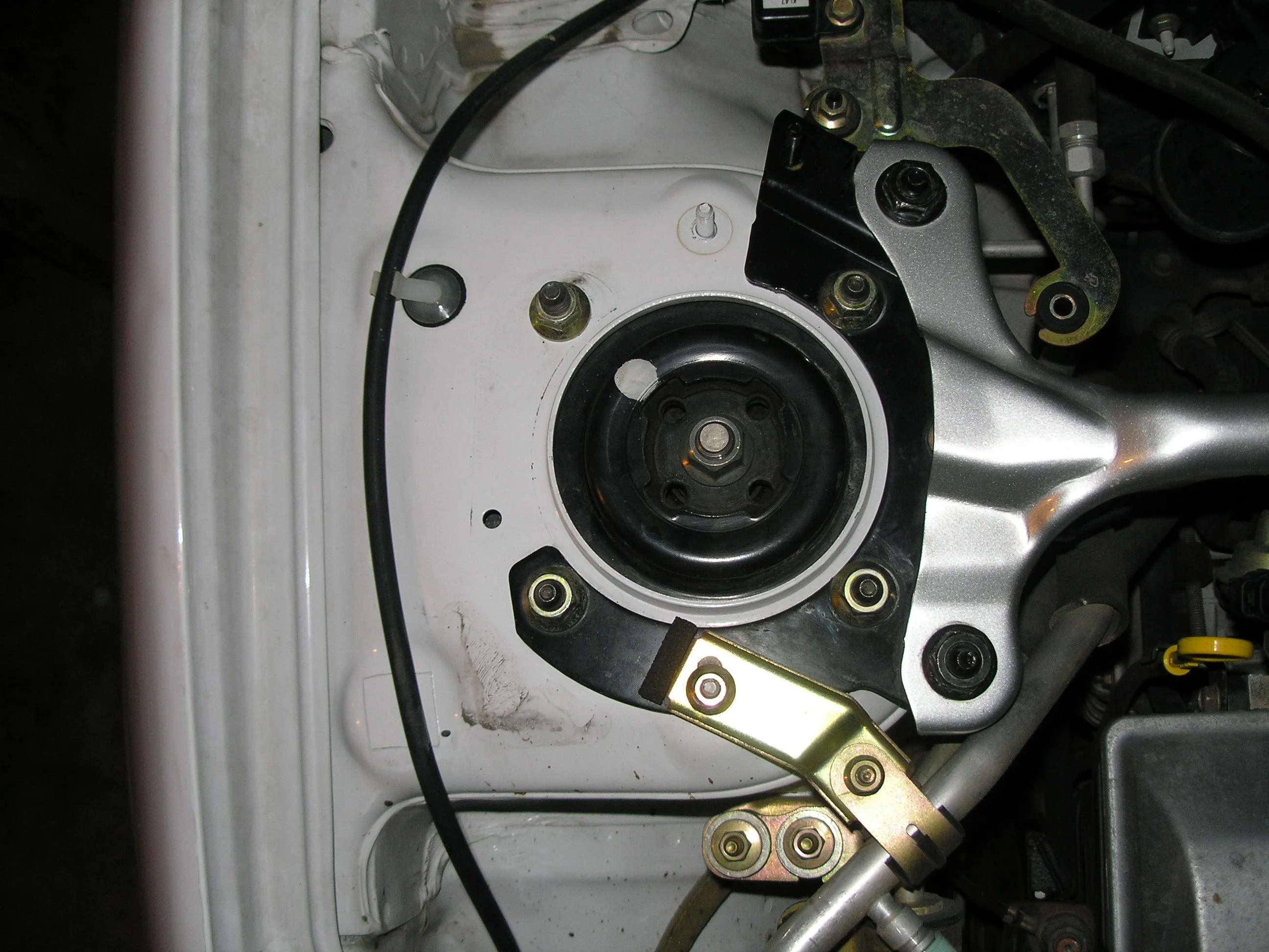

ok check this out, I have been having this problem with all of my tires. and I realized how to adjust it when I got new struts.
On the front struts you have 4 bolts and connect right under the hood. same place the strut tower bar connects. here you will find a white dot. at one of the 4 bolts. if you raise you car, drop the strut and turn the plate so the white dot is at a different location, it changes your camber. I have a picture of mine attached so you know what to look for. I think I will change mine to the way another protege forum members looks like since he has less problems with his tread wear.
the attachment was taken from the passanger side strut looking at it from the front of the car, the white dot is mirrir opposite on the driver side. while playing with the strut I noticed that it totaly threw off the camper from what im used to. so i just put it back to what it was stock.
Hope this helps.
when you adjust camber you also throw the toe setting for sure and maybe your caster. i dont recommend doing this at all with out the car on an alignment machine
