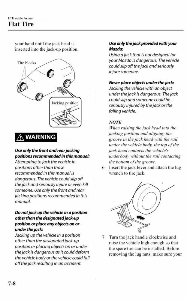

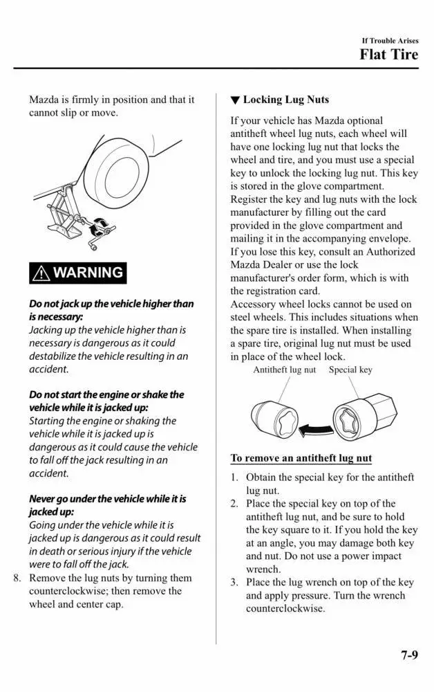

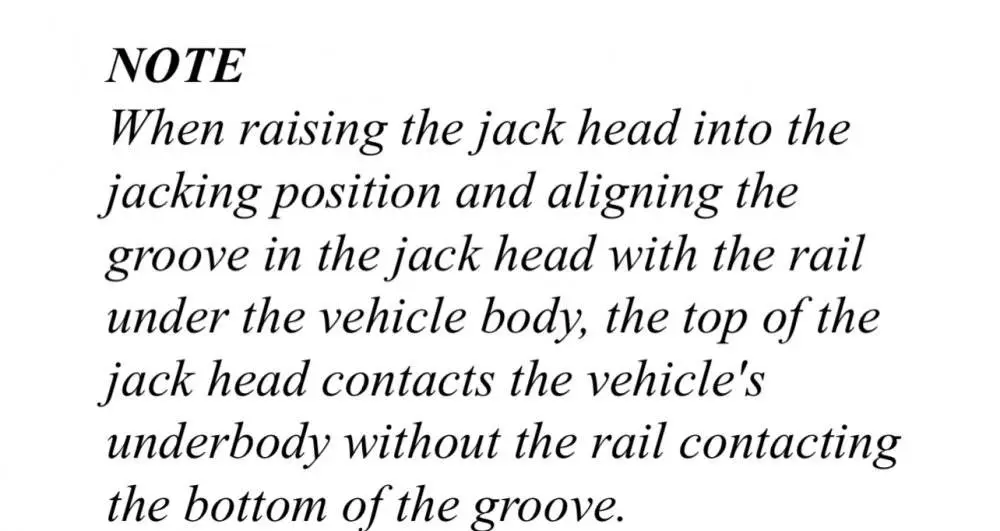

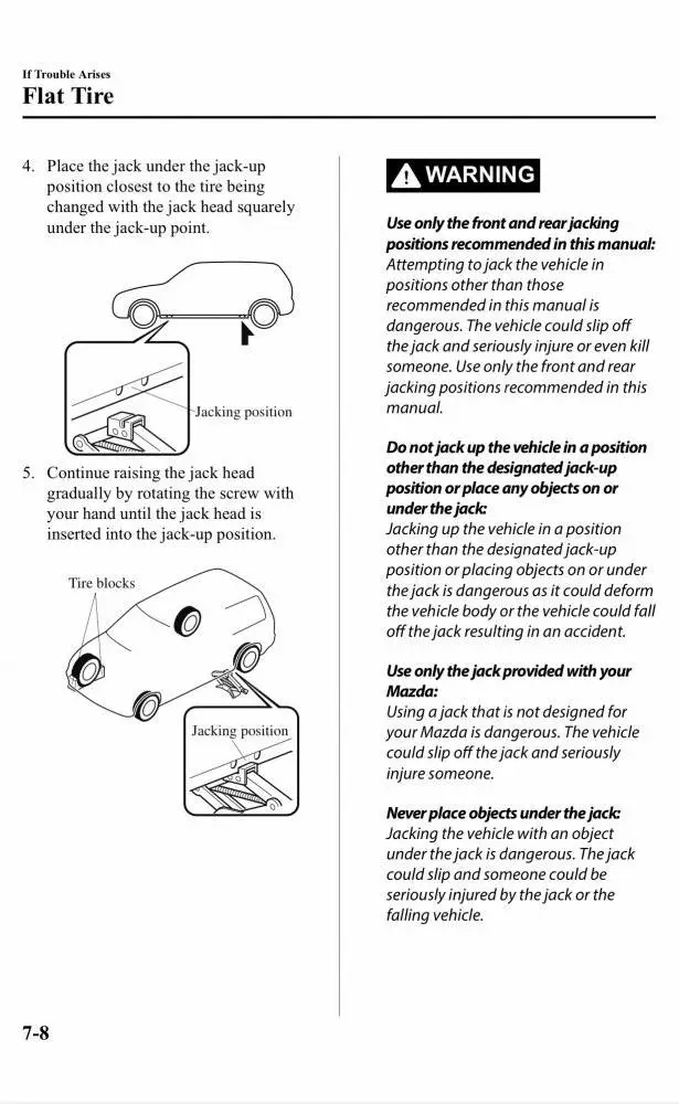

Not being rude but the 2021 owners manual page 7-8 says otherwise 🤨:

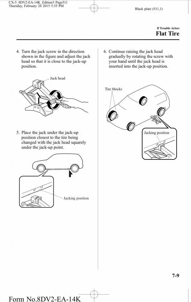

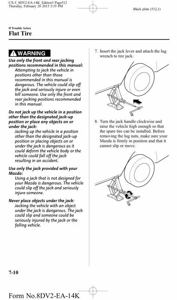

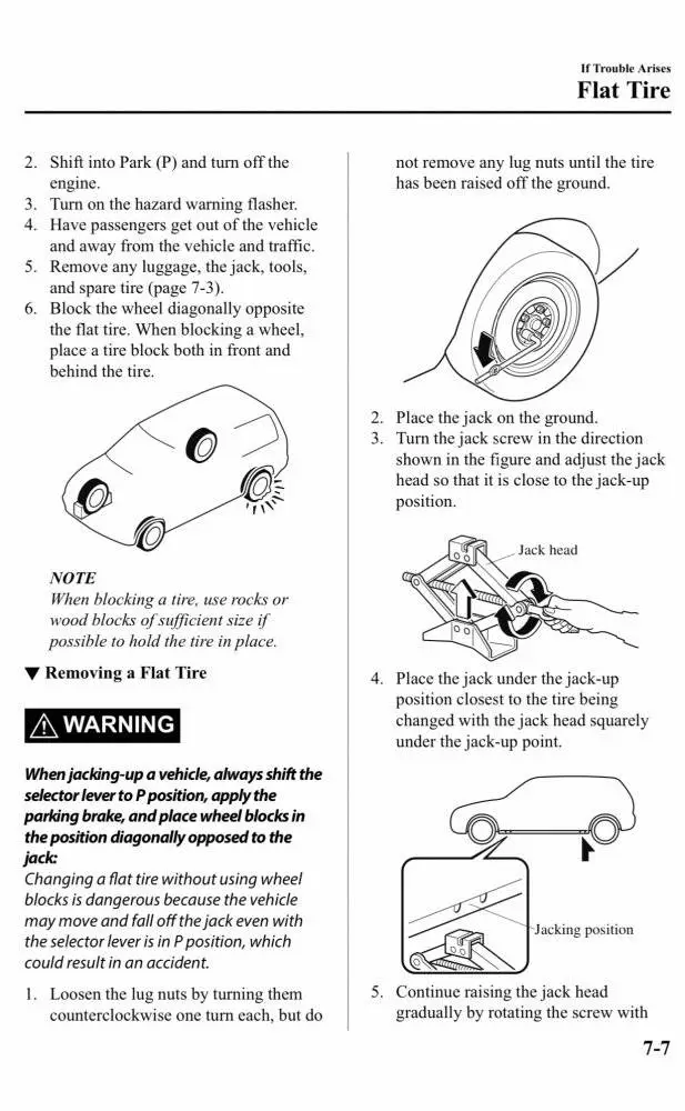

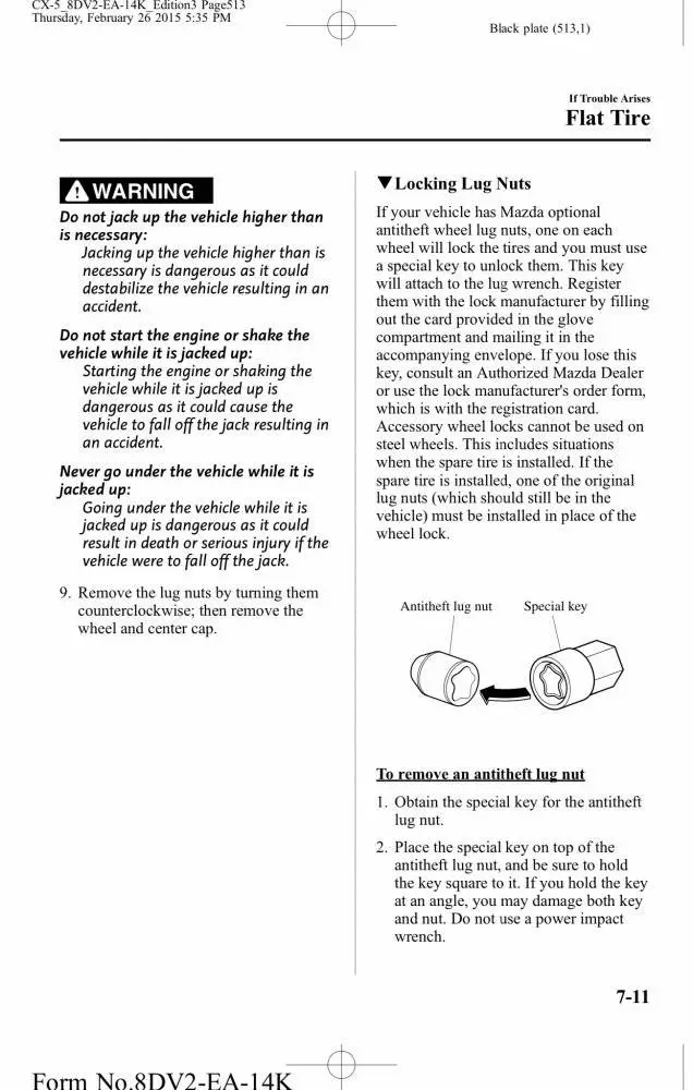

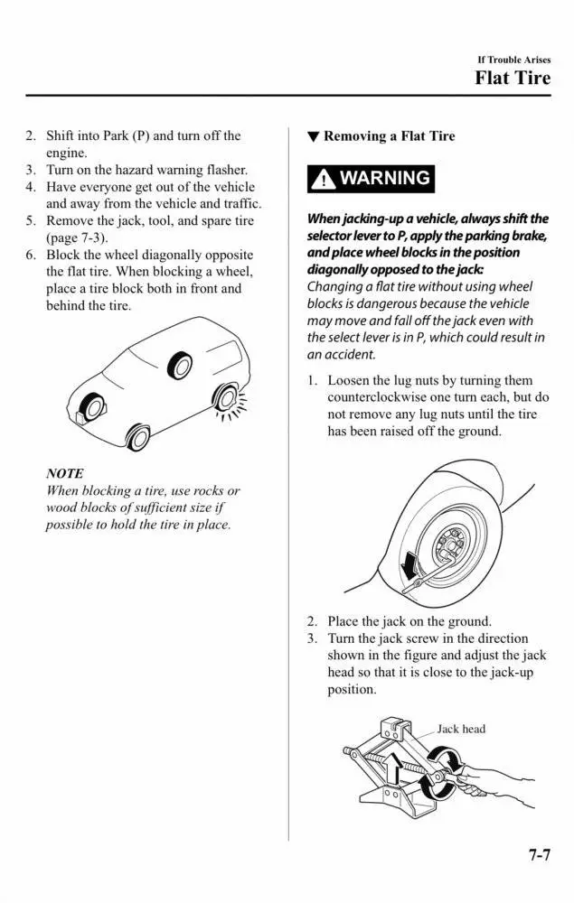

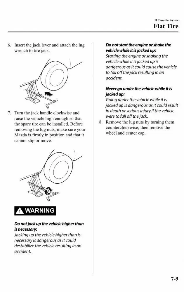

I can see your concerns after I read the 2021 Mazda CX-5 owner’s manual.
My 2016 CX-5 (Gen-1) owner’s manual:
2018 CX-5 (Gen-2) owner’s manual:
2021 CX-5 (Gen-2) owner’s manual:
We can clearly see the 2021 factory tire jack head looks diffrtent from my 2016 gen-1 CX-5 and 2018 Gen-2 CX-5. The note of the rail not touching the bottom of the jack groove has appeared, and all illustrations have also changed so that they show the jack head touching the car body.
I personally wouldn’t be too concerned as the owner’s manual has also said you have to use the crappy Mazda provided jack to lift at designated jack-up position and you can’t place any objects on or under the jack. This means the floor jack and pjack pad aren’t supposed to be used on the weld pinch rail area. Further, you’re not going to be able to find a deep-groove jack pad to meet such requirement like some had suggested.
Yeah great eye btw, the 2021 mentioned contacts only on the underbody and not the rail (pinch welds) but I ordered the jack stand pads for the rails and ordered a round rubber pad for the hydraulic jack ONLY to jack the front cross member (dimples) and rear differential. The hydraulic jack will not be used on the rails. Sorry for being so paranoid as I am a fresh Mech Engr. Thanks to all the great info and stay safe!
