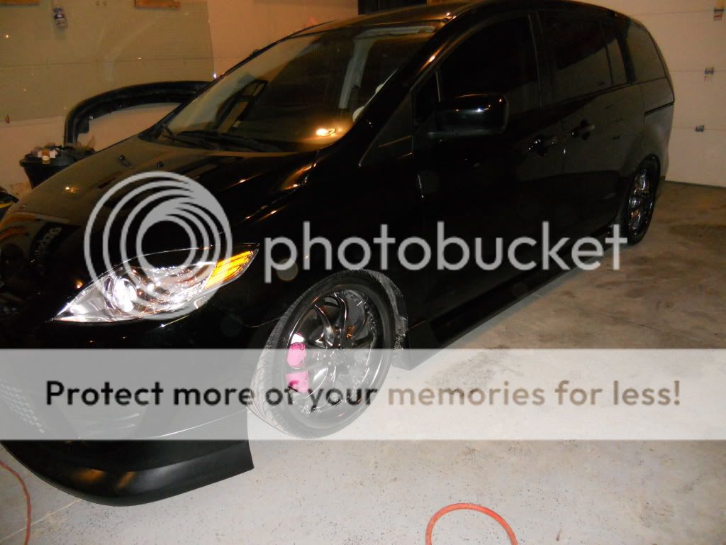

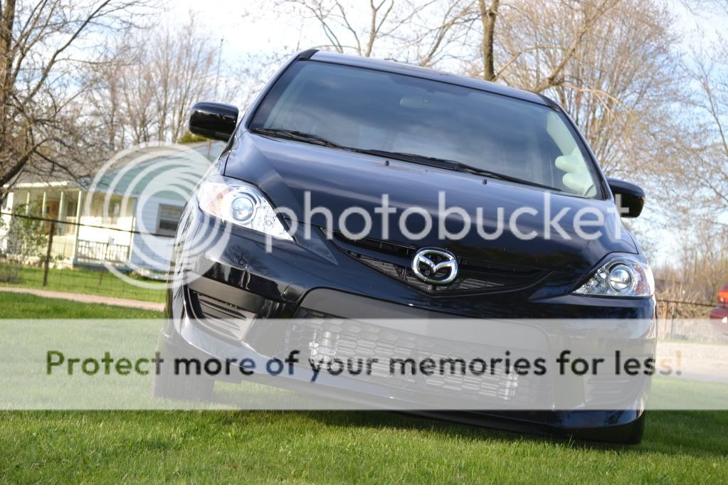

this is the car all the way up..

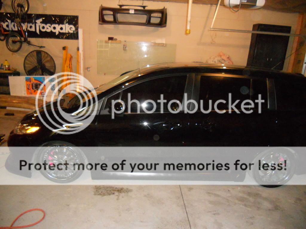

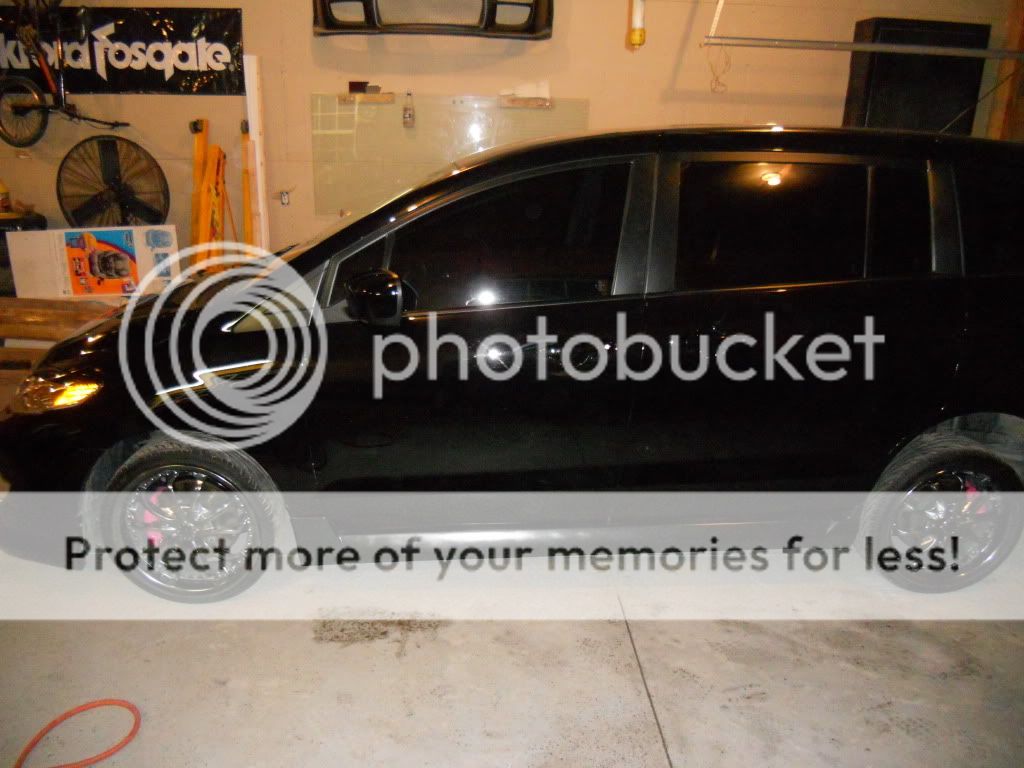

and here it is all the way down..

I'll be honest, If it won't tuck at least tire on bags than this isn't the car for me. I was really suprised how high it is completely dropped... before and after.
