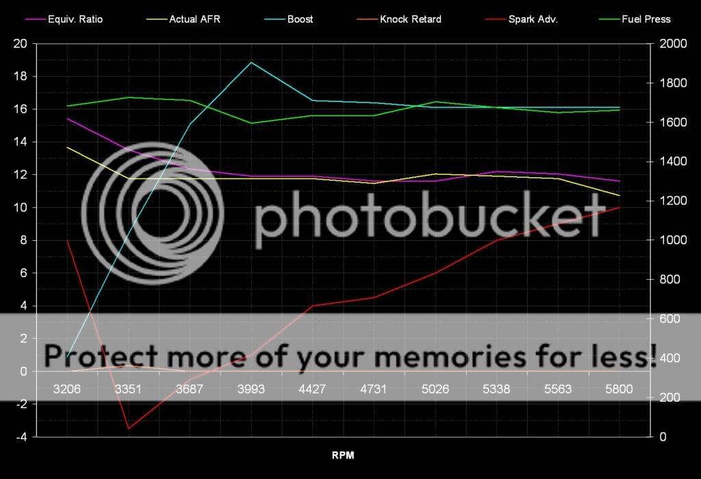

3rd gear notice fuel pressure is on the secondary y axis. Everything else is on the originial y-axis

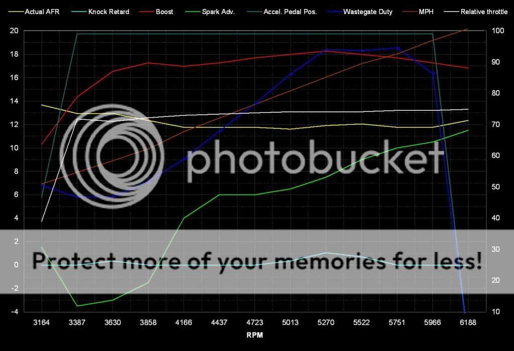

4th gear run
same 4th gear run but with different PID's. This graph is harder to read because I graphed 8 PID's which is too many in my opinion. You will also notice that the 4 PID's (mph, actual and relative pedal position and wastegate) that are on the right of the legend are on the secondary y-axis. The 4 PID's on the left are on the smaller y-axis.
4th gear run
