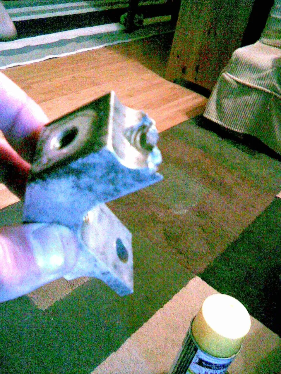

hehe i went thru that X-member with my hand and wrench to mount my new bushings ... F-ing weld that tacked that nut in place was garbage.
no doubt, I have had three of them fail, but my rear sway is as tight as I can go with it so they are under some hella stress. Pretty sure that is why the AWR mount broke too. I'll throw a pic of that up tomorrow from work.
my broken AWR bracket
