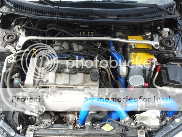

I bought the car this way .I'll explain as much as I can and even get a picture if needed. It has blue hard pipes with a hks bov and injen cold air intake.my pipes are 2" but my cai is 2.5". What looks to be like a stock bpv is connected at the pipe that goes from the turbo to the stock upper smic location and it then goes inline connected to some other hose
here is a picture of my engine bay
so if i buy the ebay universal kit with the U bend pipes and couplers,all i would need after that is the 2'' to 2.5'' reducer for the turbo which i already have ..how many 90* and 45* couplers would i need to run the pipes thru the smic location and the left radiator section? this is my last question and then i guess im good to go lol
