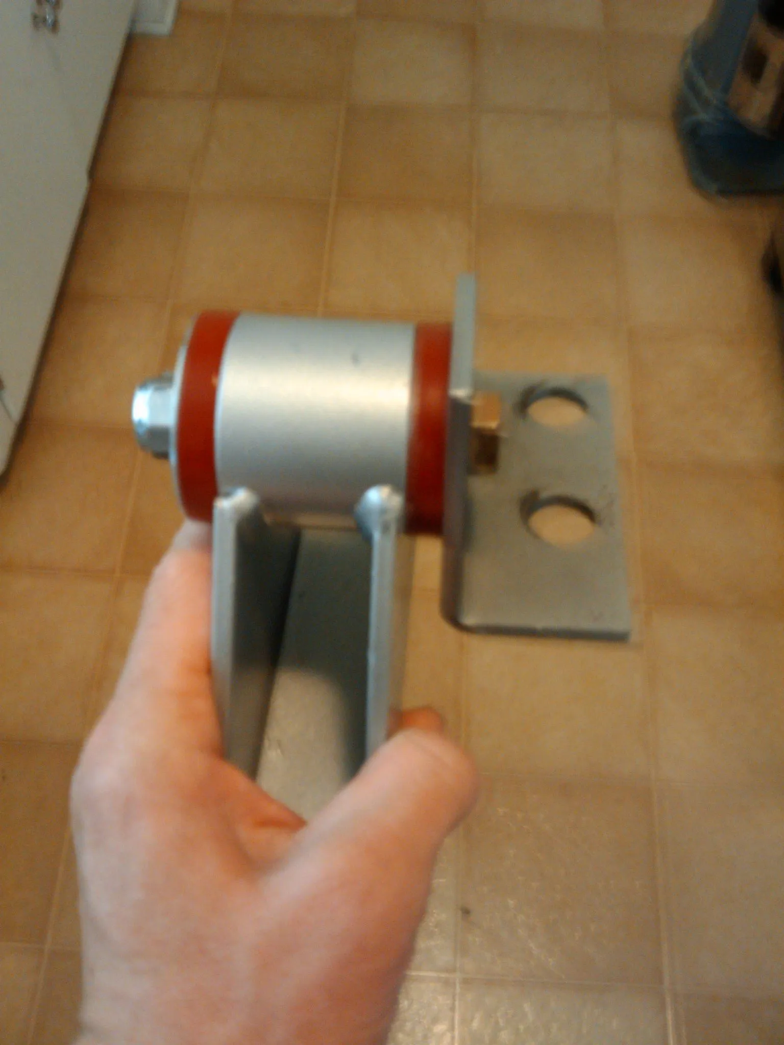

OK, here's a pic of the Medieval. Basically the autozone replacement is missing the part off to the right with the 2 bolt holes, which attach to the engine.
I saw a lot like that when I was looking to replace mine.
I believe you either:
a) bought the wrong model/year mm
or
b) bought the REAR passenger mm, when you were looking for the front passenger mm.

Hmm. it's the correct mount, I mean I know what the other three look like, and this is it, it's just missing a means to bolt it to the motor. Veryfreakinweird. I'd very much prefer to buy from autozone, because they offer a lifetime guarantee on the part. In other words, it's still a crap oem mount, but unlike Mazda parts, I can return for a new one when it rips. :D
perhaps you need to use a hydraulic press to get the bolt thing out of your old mount and press it into the new one
I tried hammering it out, but it really looks as if the rubber was poured around it, and it's molded in there.

And from what i see...that part is listed for the 01 engine only. IDK maybe double check with autozone.(burn)
i bet the mount you bought is for a 1.8 liter but that doesn't make any sense cuz its the same block
that's what you get for buying aftermarket bulls***
you'll have to press the old bracket out and press the new one in
the cost of paying a shop to do that will make it worth as much as buying a stock MSP mount
Ok, just so I am straight: if I buy the mount off mazdaparts, the sponsor here, will I still have to press the old mount apart, or will it arrive ready to go? Its odd, because like social's link shows, you can buy aftermarket oem replacements which are complete.
Anyway, I put the old torn one with inserts back on. My goodness, what a relief, smooth as butter! Lol funny, because I remember noticing increased vibes when I first put the inserts in the torn mount. After the medieval, though, its unnoticable. I hate to think what awr's all around would be like.
