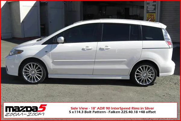

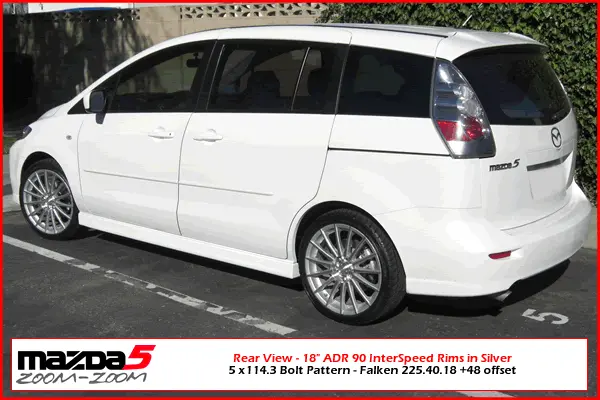

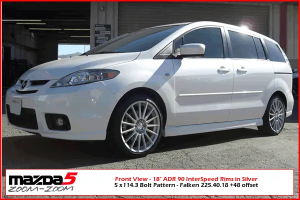

Your 18 w/ 42 offset might be a problem. Minimum offset should be 48 for the tires to be flush with the fenders. When dropping the 5, with this offset, it will definitely hit the fenders.
Oops, Actually I have a 48 offset front and back. It was a royal pain finding the right looking rim with such a high offset. Konig, American Racing and tons other MFGs didnt have that many choices that I liked in 5 x 114.3 +48.
The ADR's I finally settled on were my 3rd/4th choice, but still look pretty good. I was going to get the Konig Randoms ( LINK ) only to find that they were discontinued 2 years ago and that not a single set were available nation wide in this offset and bolt pattern. I searched the world over (online) to find the right rims, and amazingly ADR's are manufactured less than 10 miles from my house.
As you can see below, it needs a drop to finish the look, but Im really going for perfromance over looks, I like to drive fast - - ZOOM ZOOM 4 REAL - -
TJ, I appreciate the heads up ~ MazdaForums ROCK!!!
