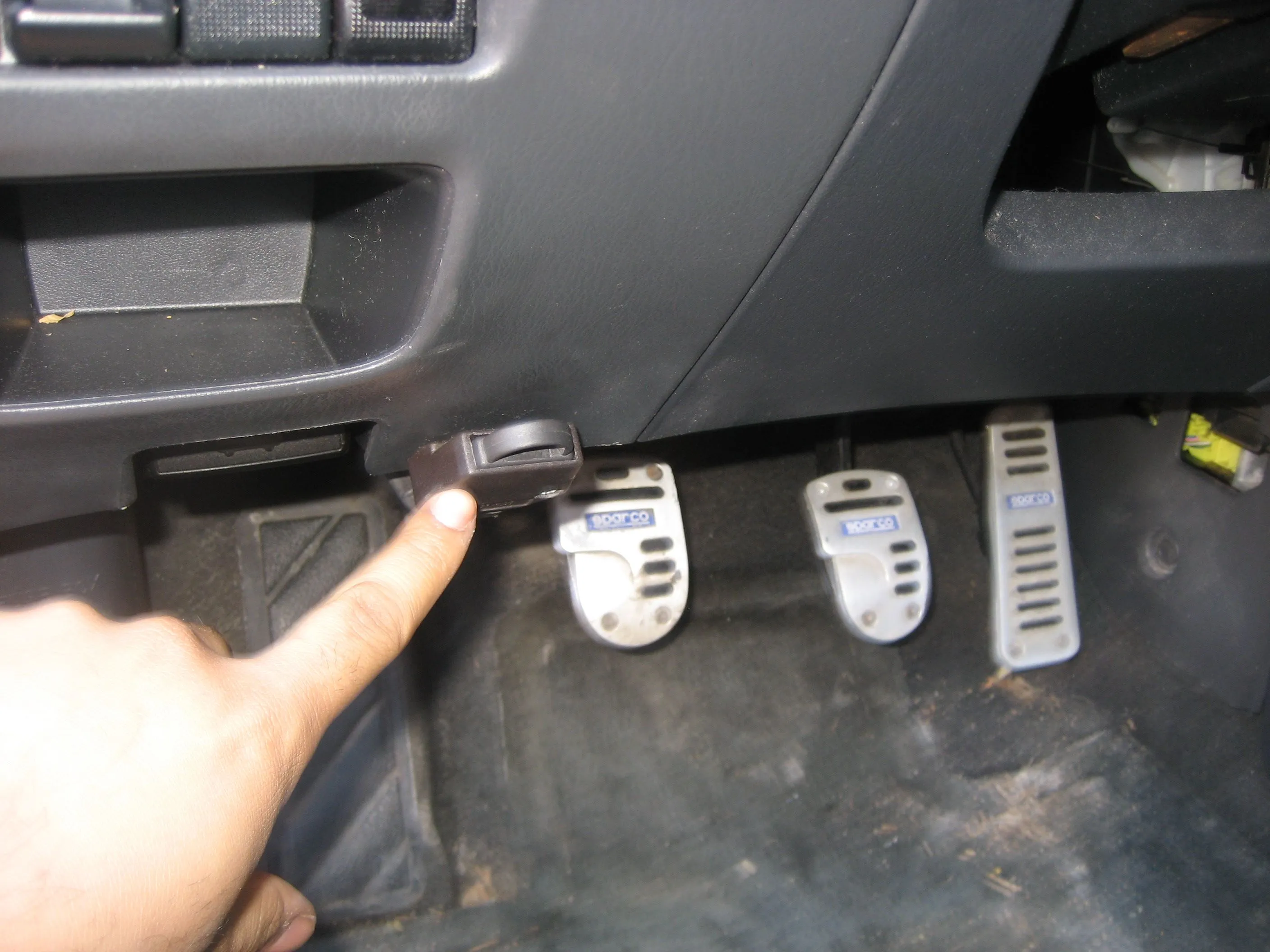

check the plug sensor thing that goes into the ODB tester port pull it out them push it back in again.

did you try my idea? similar thing happened to me twice it was that plug thing

Near your left knee while sitting in the drivers seat...here... I took a pic
your won't start without it in place. I take it out when I park as added security. It's like disabling the computer, it can't be started and stolen
you're probably on an aftermarket system..i've never seen that before on a msp.

Wow I'm really confused now!! I thought it was stock. In fact when I got the car the whole damn thing was factory bone stock besides the upgraded kenwood head unit.
I wonder what else was done to the car before I got it!!!
It's nice though, When I park it I just pull that plug out and the car won't start at all, it kills the ignition system. All the power works fine though. it's like trying to start the car without pressing the clutch....nothing happens.

do you still have the stock security system zuku? cuz when I bought my MSP out of an auction in Michigan, the security sytem was taken out of it, and they ha one of these put in its place... but I got rid of mine and went back to stock... thread jack ended...
It's an aftermarket kill switch. I hope you got a car fax report before you purchased it. Makes me wonder what else might be lurking that you don't know about. lol
