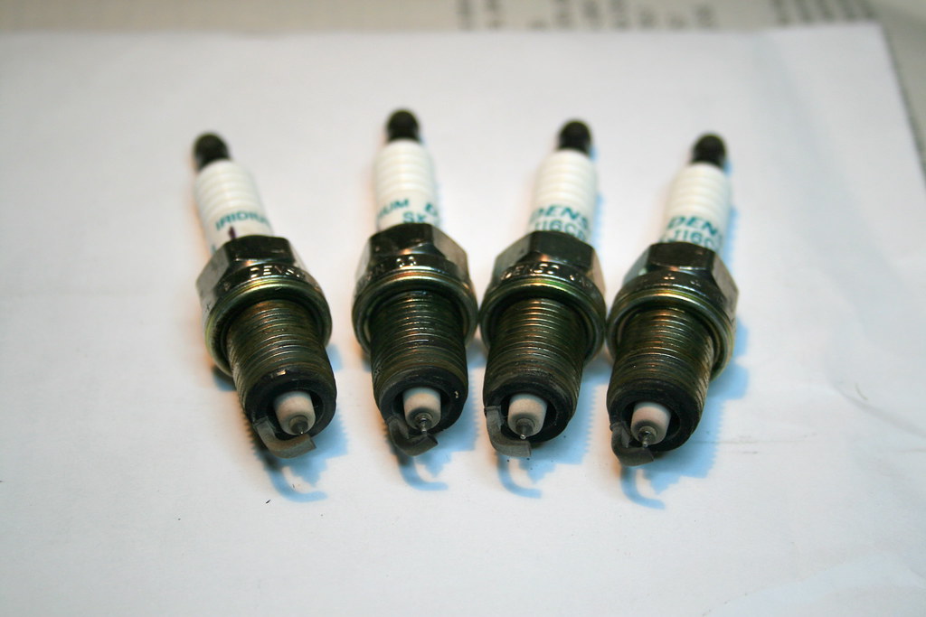

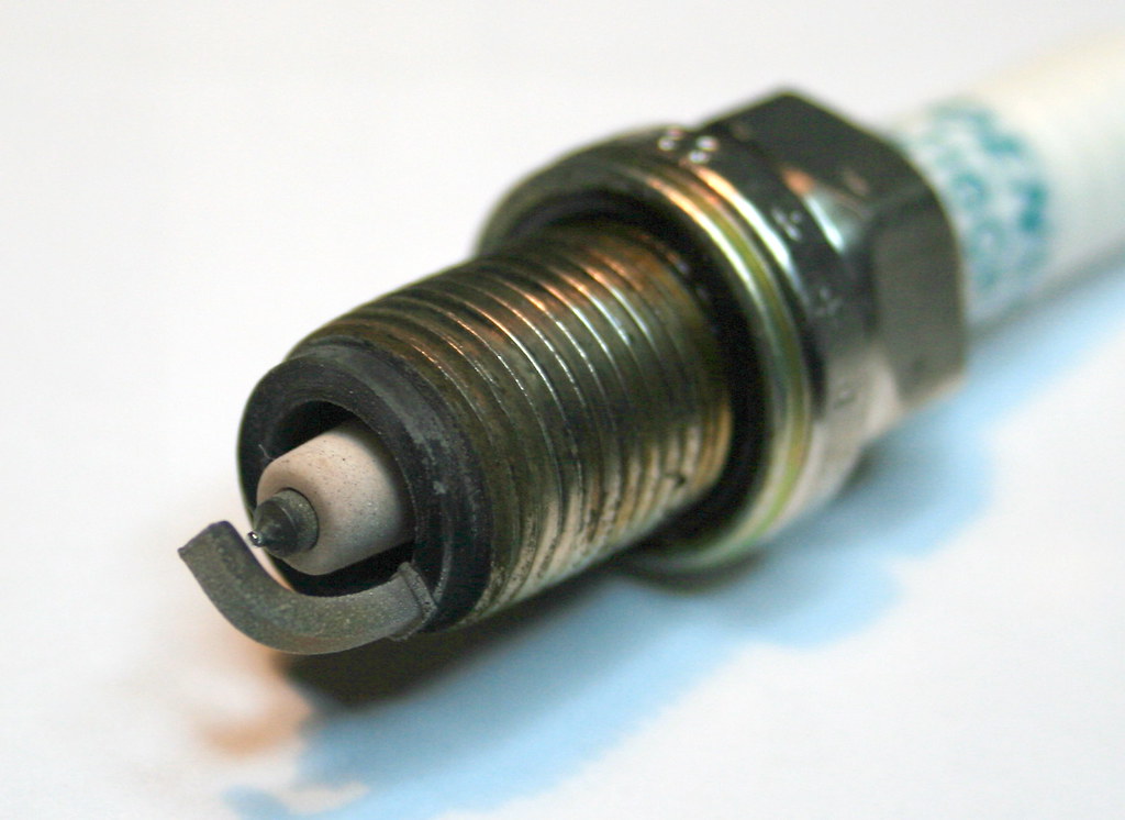

This morning I yanked the old plugs ..... and much to my surprise, they weren't what I expected!!
What came out were ND Iridium SKJ16CR-A8's!!! I can assure you these are the plugs installed from Mazda. I am the first owner and have done all maintenance on the car.
Checking ND's site, these would be used on a 1999 BMW 750il (V12 engine) ... and the equivalent NGK V-groove plug would be the BKR6E.
The plugs with 21k miles on them look perfect -- I'll snap a picture. Nice light brown coating, no visible wear. I checked the gap and it was ~0.32" on all 4 of them. Looking at NGK's site, I see that BMW calls for this gap on the V12.
So how odd these were in my car!! And then how odd the gap was 0.32". I installed the ZFR5F-11's with the 0.44" gap they came with. Driving around today, I notice zero difference between the new and old plugs. I never really had any lurching or other problems you guys talk about though... Mileage seems to be pretty crappy lately, though ... about 18mpg all city, all stop and go. We'll see if it gets better.
Has anyone else ever found these in their MP3? I am thinking I will just re-gap them to 0.44" and put them back in when the ZFR's die. In addition, I should have taken a comparison shot, but the Iridiums look pretty long reach -- comparable to the ZFR's. I saw someone else's shot comparing the BKR5E to the ZFR5F-11 and there was a big noticeable difference.
I am thinking now my slightly rough idle these days is just caused by hardening motor mounts, as would be expected due to age.
Oh, and for reference I always run 91 Octane (California Gas.) The Iridium's I yanked were a "6" heat range and that seems to be perfect. So we'll see what happens with these new 5 heat range plugs... I'll check them in 10k miles to see how they are doing.
Sorry for the bad lighting -- I need a light box. Pictures of the Mazda-installed SKJ16CR-A8 Iridium plugs I pulled from my MP3 today....
most interesting indeed. i think you're the first for sure with the iridiums
