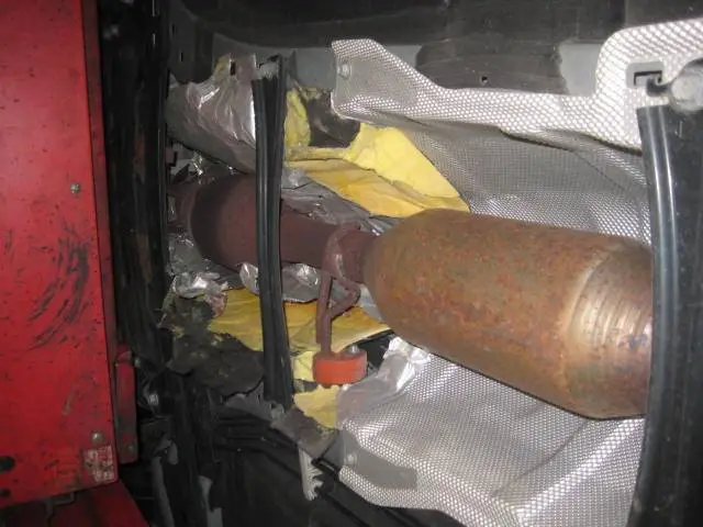

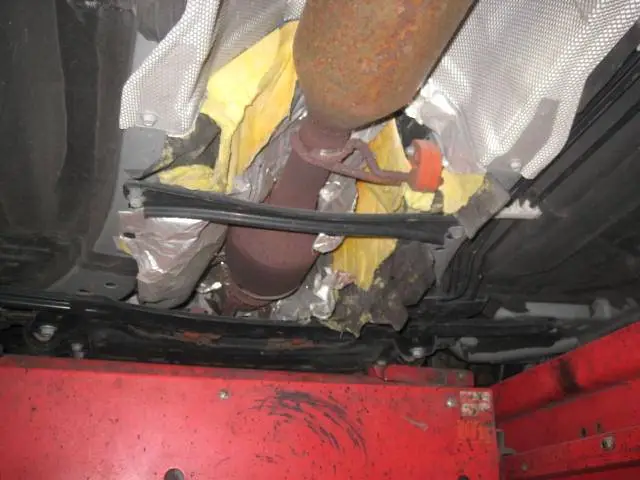

Failed heat shield
I would replace it. Mine was failing for no reason and I got mazda to send me gift cards to buy a new one and got service to install it for free. Shouldn't happen on a 07 with less than 40K. The dealer told me it was vital to the exhaust/02 sensor performance. Too much heat= fail. IMG_6646.jpgIMG_6647.jpgIMG_6646.jpgIMG_6647.jpg
Well, same is on my son's car. I have good guess what the reason is - if an idiot tries to run a speed bump at high speed, betcha, bump will bite back. I'll re-cover it with heat foil like shooter did, no reason to fork for new one. Hey, shooter, what did you use exactly?
