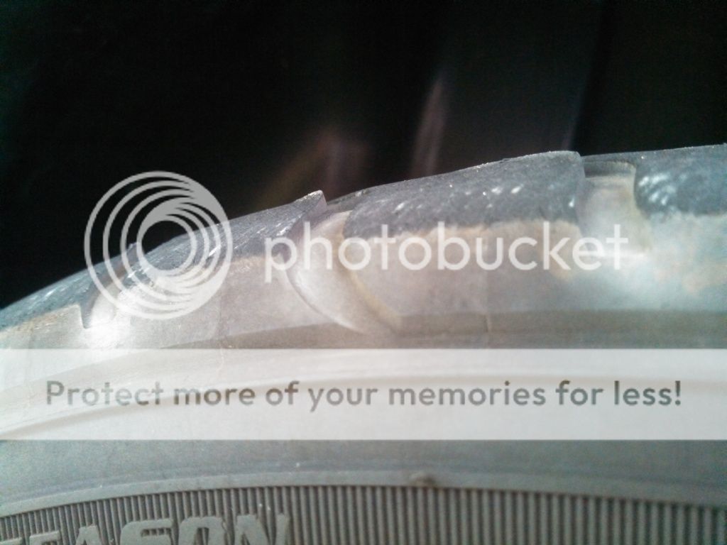

Guys, Here is the info from the Car and Driver article. I thought is was interesting because my wife's car is within alignment specs, but the front tires were feathering on the outside edges with only 5K miles.
Persistent vibrations and suspension clunks necessitated the replacement at about 17,000 miles of the anti-roll-bar bushings, a rear shock, and the steering intermediate shaft—all also covered under warranty. The problem caused uneven wear to, and prematurely trashed, the car’s Yokohama Avid 534 all-season tires, which the dealer fortunately replaced at no charge. The vibration never resurfaced, but we did continue to hear the occasional groan from the suspension.
The steering shaft and roll bar bushings would have zero effect on tire wear... fyi. I'd bet that the alignment was off from the factory(this is WAAY more common than you might think. Every single damn Dodge Caravan/Town and Country from 2008 was off center by a noticeable amount), and when the steering shaft was replaced it was checked/corrected after the shaft install.
How bad is the feathering? Got pictures?
FWIW a lot of cars seem to just be prone to wearing the trailing edge of every single tread block, my Mazda3 did the same thing in the front. The rear it was actual uneven wear(cupping) because of the goofy rear suspension they have(lots of negative camber + lots of toe). It depends on the tire in a lot of cases... the Yoko Avids they come with are not exactly great tires to begin with. This seems to happen to cars that are driven more aggressively in my experience(to the front tires). My Mazda3 needed the front tires rotated every autocross event or it would get out of control...
The front of the car is to the right. That is after one autocross event. Rotate them, did another event, evened them out(this all over about 500 miles), drive normally after the season was over and never see wear like that again.
I just posted the informatino relative to the steering shaft as a possible reference for other people. The tires were not too bad. After I show the tech, they relucatantly agreed to check the alignment. It was within specs and they billed Mazda for it. I would have liked them to have tweeked the toe, but they already pulled it off the rack. I agree with your comments about the tires. On my 2, yes we have two 2s, you could visually see how bad the driver side was towed out from the dealer. Since I was going to install the Bilsteins and camber bolts, I just maxed out the camber and adjusted the toe.
