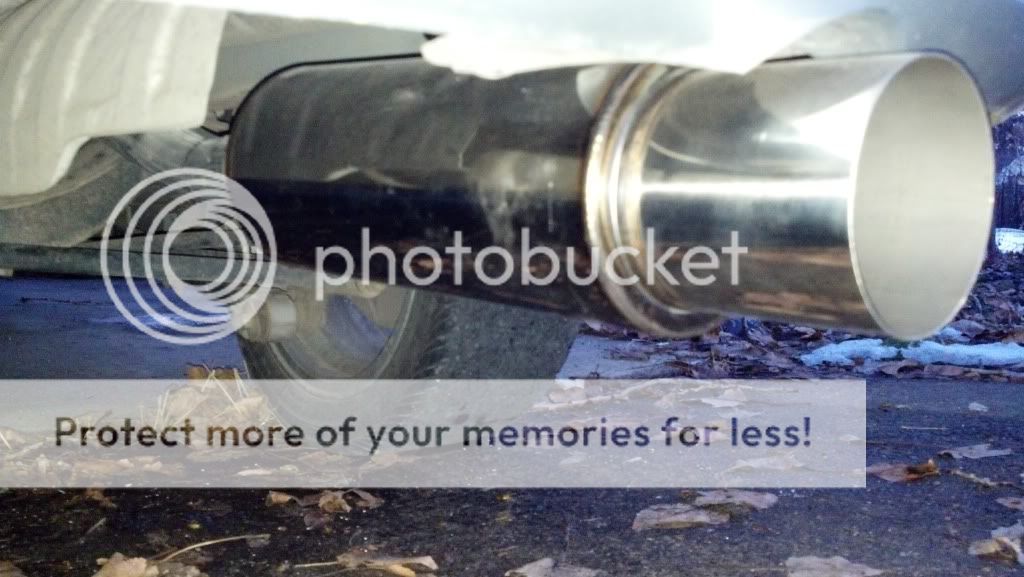

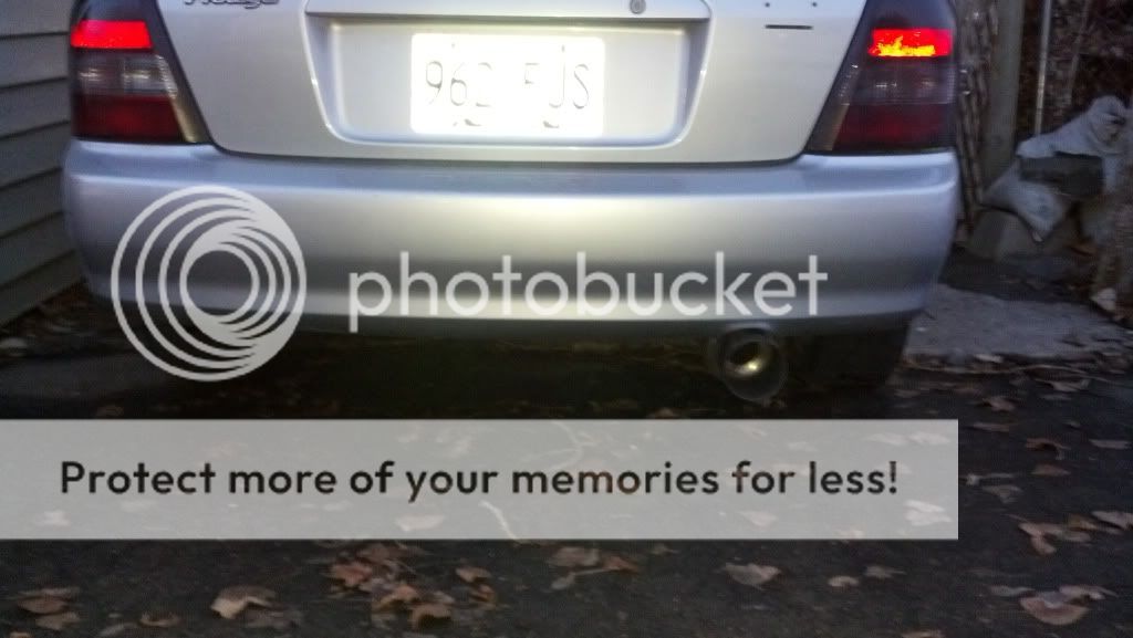

Here are some pics of it, I am really happy with how it hangs, matches up very nice with the rear valence and doesn't seem to rattle. I'll try and post a video later on today.
^ looks good man. Mine was a little stubborn getting off the mid pipe. Had to take an impact gun to get it off, that was loud.
Does the pipe hit on the rear cross member on your car?
