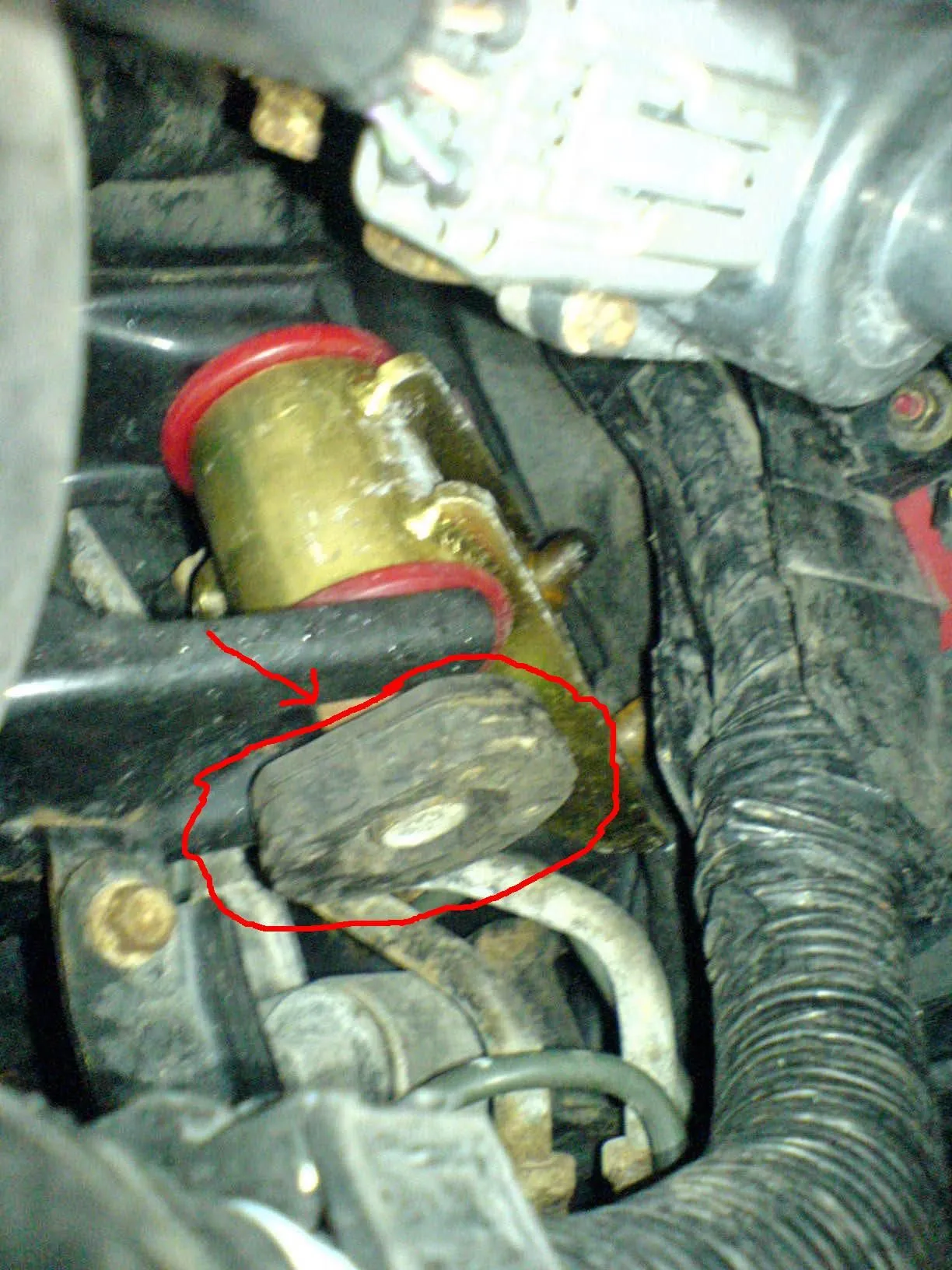

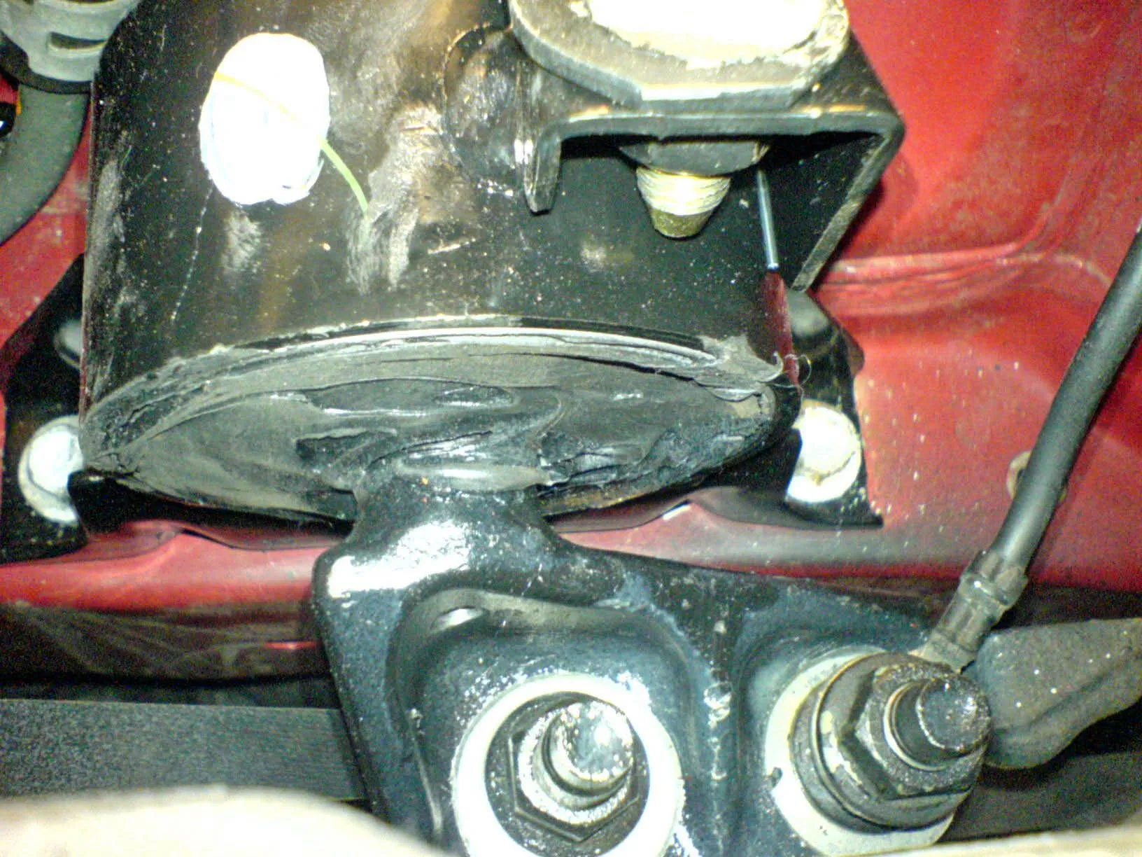

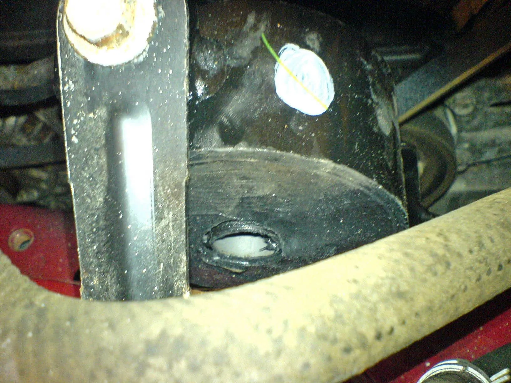

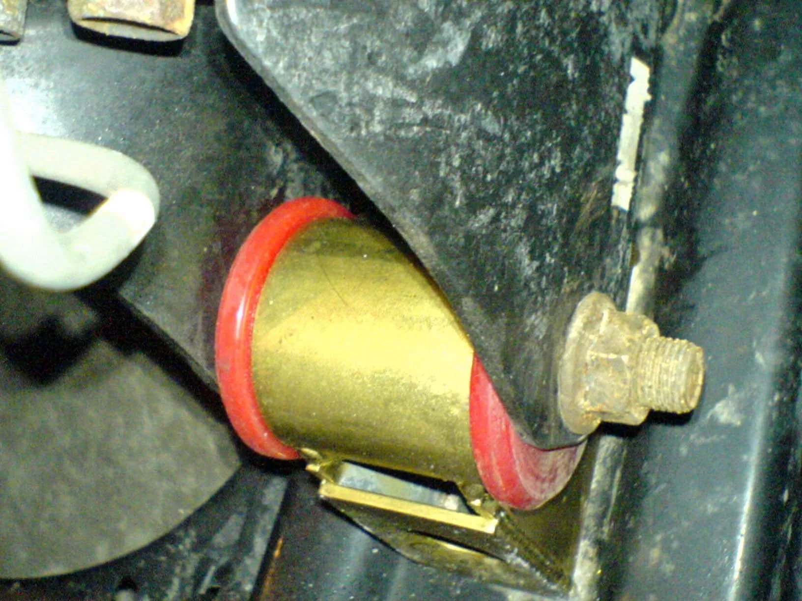

I looked at the mounts and the rear looks kinda funny to me...there is a rubber isolator on one end of the bolt that holds the engine to the mount itself and it doesn't seem to be sitting flush with the mount. Additionally, because it isn't siting flush, the bolt is probably not as tight as it could be.
Did you install the AWR mounts? If not, I would def look into those. I baought both RR-Racing inserts but have only installed the front due to the added difficulty of installing the rear. Its possible the previous owner sis the same thing. If you only have the from AWR mount, then that puts more stress on the rear mount which will cause it to fail.
It may be difficult to verify which mount is in the back unless you jack the car at the front jacking point and crawl under.
That bolt has a weird collar on it which is what you are seeing. There is a spacer behind the collar that makes it look like the bolt is loose. that is probably not going to be a source of any trouble for you.

Ok...well here are the photos of the mounts...more specifically the rear mount.
I understand that if placed correctly, the rubber collar should not cause problems, however, it sems as if it is not placed correctly.
Can anyone verify that it is - or is't - placed correctly?

From reading what you are experiencing it doesn't seem so much like clutch chatter as you are just lugging the motor down too far. It's not a big V8. Let someone else drive your car and see if it still bucks. Have them drive it their way and then make them drive it your way. That will be a good test if it's you or the car.
oh...yea...that collar on the rear motormount is fine.
