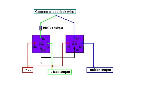

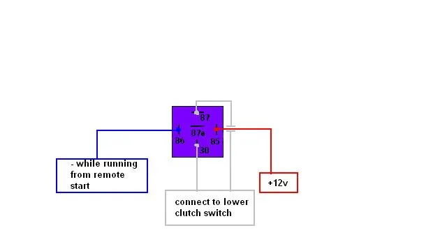

S ssinstaller Member : 2006 MazdaSpeed 6 Oct 24, 2004 #1 here are the diagrams The Clutch bypass relay should be connected to the higher switch on the clutch NOT the lower! Attachments clutch.jpg 10.6 KB · Views: 966 doorlock.jpg 16.8 KB · Views: 566 Last edited: Oct 25, 2004
