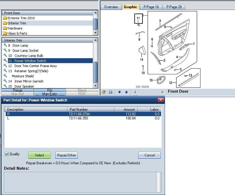

Actually, It looks like its all one switch assembly,
part# TD11-66-350
This would be my bet, but its an expensive bet.
