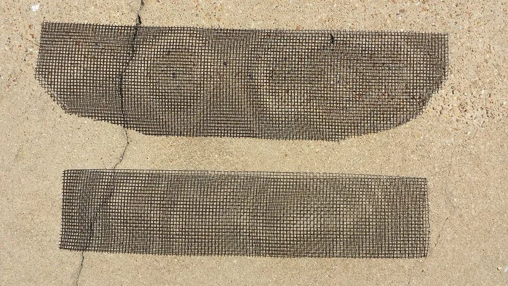

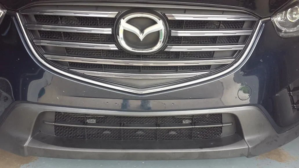

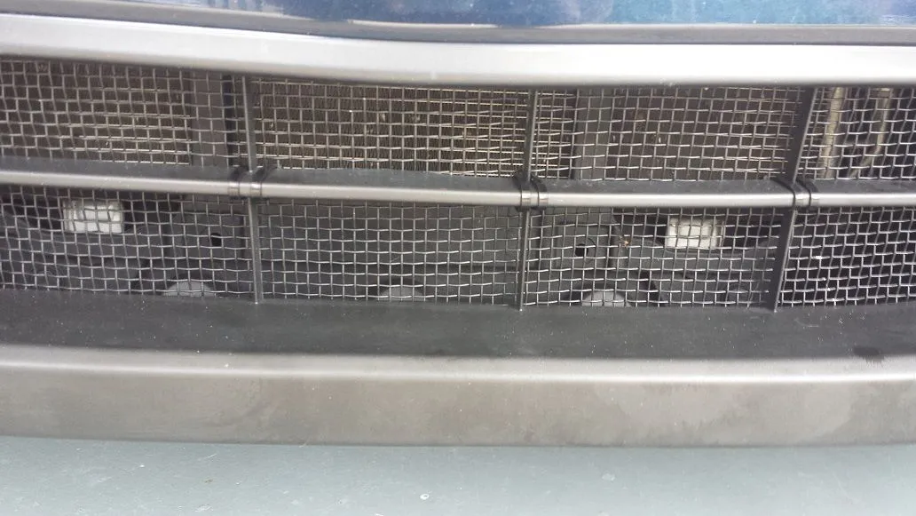

Stainless mesh painted black. Bottom piece is 28.5" X 6.25" and the upper piece is 32" X 8.5". Zip ties on main bottom bar, with a dab of silicon on the corners. I didn't attach on the verticals because I thought they were too thin. It should be enough to at least deflect a radiator-killing blow. Upper section is attached under the crossbar only.

Thinking about getting some miata teeth for the lower grill lol
That's a good idea. But they'll still get onto your rad. Hell, I've seen bug splatters on my intake manifold from bugs getting through the grill, through the condenser and rad fins and finally hitting the plastic manifold. It's ridiculous where they'll go. But your mesh will certainly help.
I just can't believe that someone designed the front with such large gaps so close to the road. It's not as much for bugs, but for rocks and other large, heavy objects that could punch a hole in the AC fins. I'm not sure what would be cheaper to replace: the front clip of the car, or a busted radiator. I probably didn't have to cover the upper section; there is a point if a meteor is going to strike the front of the car, there isn't anything I can do about it.
