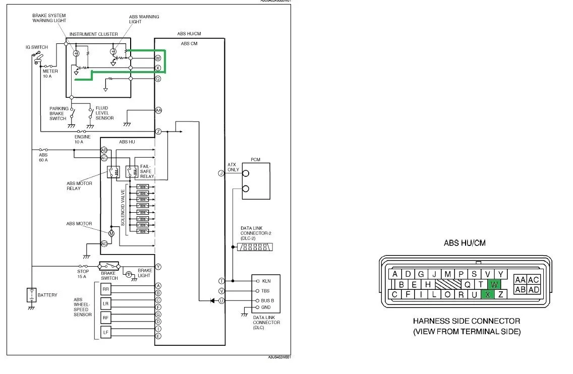

ever since purchasing the car the ABS was dangerously overactive. so my solution was to "**** IT- pull the fuse"
which left me with the ANNOYING undimmable ABS & Brake light glaring in your face every waking moment.
running through the FSM i decided to figure out once & for all how to easily shut off those damn lights.
here's what i came up with: (thought)
Following the below diagram you can see that outputs "W" & "X" control the annoying cluster lights.
so here's my idea- Does anyone see any issues with this??
Pull the main ABS fuse(under the hood)
and simply De-pin from the ABS unit harness plug pin's "W" & "X"

Im not about to take the ghetto route & pull my guage cluster lights out. im looking for an actual solution to just shut them off.
today is a bit warmer so i'll go ahead & experiment as i posted & report back.

well i just unplugged the whole ABS unit & the lights didn't go off. so as of now im not really sure if this will really work. its too ******* cold out to do much so i'll have to wait till warmer weather.

bpt323,... did you do the jumper wire under the hood thing to find out why the ABS unit thinks there's something wrong???
i pulled the main fuse from the ABS- so it no longer gets power. theres nothing wrong error wise with the system. ABS just plain blows a bag of goat nuts
i couldn't back out of my driveway without ABS trying to trigger. as jesseM said....... "******* stupid"
Your car shouldn't throw a MIL backing out of the driveway. (unless you're pulling huge G forces)
If your car used to back out of the driveway without throwing a code then your ABS ECU (head unit) is trying to tell you there is something wrong.
You really should plug everything back together and find out what your ABS HU is trying so stubbornly to tell you.
You just plug in a jumper wire under the hood and the idiot light on the dash tells you what's wrong.

you seem to be missing the point- i don't want to "fix it"
I want a solid solution to pulling it out & not having silly lights shining in my face at all times.

I think both you and Luken are on the right track.
I read in an old thread that pulling the fuse also disables some form of electronic brake force distribution. Supposedly the best way to disable ABS was to remove one of the rear sensors. Does anyone have a picture or diagram on how to do so?
If it were me, I would do exactly what you are thinking,.. But I wouldn't pull the pins if that means you can't reverse it in case we're wrong. I personally would cut the wires W and X about two inches back from the connector in case you have shrink wrap it back together.
I don't remember that connector but usually you can carefully remove the pins with a needle or tiny flathead and reinsert them if you have to.
