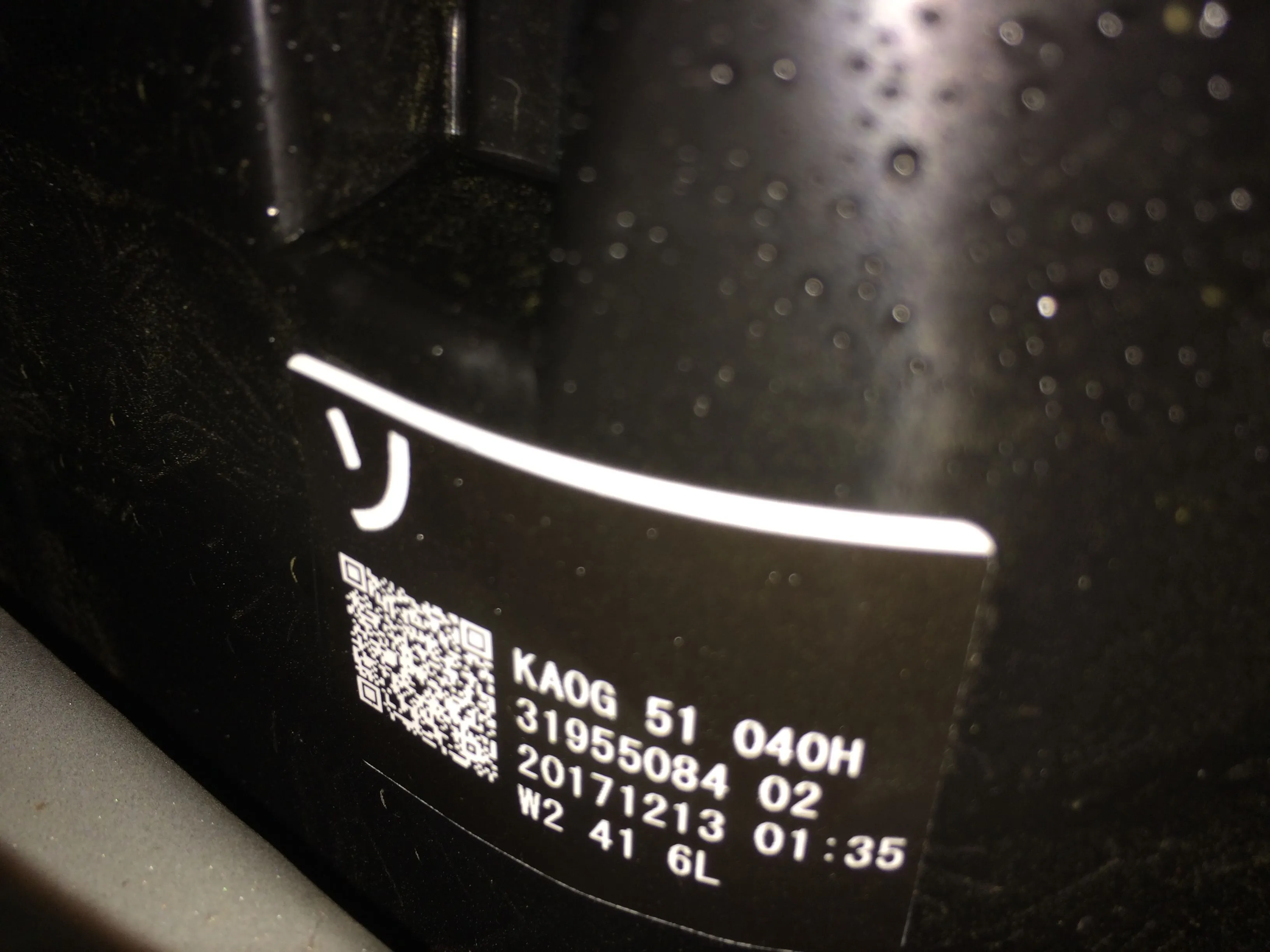

Add another one to the list. 2016 CX-5 GT purchased in May *15 with just over 21k miles on it. Unfortunately we are 3months past the 36month warranty now. Passenger side just started flickering/dim.
Looked on the label and it is a reversion (C) with a 2014 production date on it. The drivers side was replaced last year due to a hit-n-run and is a revision (H) with a 2017 production date on it.
Called Mazda customer relations and have a case started, just need to get the local service advisor to look at this and create a repair ticket (hopefully without charging me a diagnostic fee, ughh). Will report back what (if anything Mazda is still covering for out of warranty repairs on this).
Good news. Mazda Customer Experience has authorized the replacement of the headlight stating I will only be responsible for the labor. Waiting until Monday to call my service advisor to find out what that cost is? Anyone know what the Mazda tech labor time is for a headlight replacement on the CX-5? I saw a YouTube video on the bumper removal by *happywrenching* and i*d Gather it*s under 15 minutes to pull the bumper by an experienced tech (probably less). Don*t know if the headlight requires any special adjusting, etc after install.
Thank you to this forum, this thread and those that suggested calling Mazda customer experience/Mazda North America. It was painless and despite what others have experienced, I got to speak with someone in 5 minutes, he created a case and was very responsive thru email afterwards once I got the car into the dealer to document the issue and create a repair order! I feel like they treated me fairly considering the car is technically out of warranty (even though this does *appear* to be a larger issue with the design of the DRL). My local Mazda service advisor is top notch also getting me in and out of the dealer in 10minutes!

How do you access the sticker to see what version you have? Asked before never got an answer.

It has been discussed in page 10 of this thread. The part label is on the back of the headlight housing. It was fairly easy to find by looking in the engine bay. Use smart phone to reach down taking picture is the best way to see.
Wife just got back and its raining. Here are the info of my replacement LED headlights:
Passenger's side (installed 3/17/2018):
HL Sticker states: KA0G-51-030H (Manufacture date 12/28/2017)
Invoice states: KA0G-51-031J Unit (R), Head Lamp
attachment.php
Driver's side (installed 3/17/2018):
HL Sticker states: KA0G-51-040H (Manufacture date 12/13/2017)
Invoice states: KA0G-51-041J Unit (L), Head Lamp
attachment.php
So your H version LED headlight seems to be the same as my J version after all. :)
