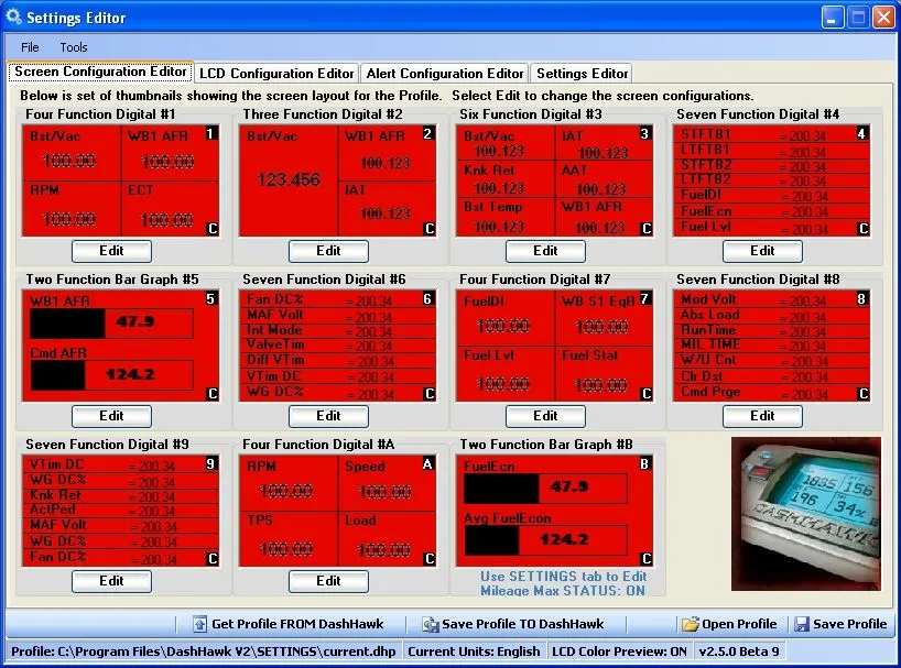

I got mine today as well (had to go pick it up from UPS) and spent just a few minutes playing around with it and then took a quick drive on I-95 to do some data logging. I logged RPM, AFR, IAT, Boost PSI, and Boost Temp. I am very happy with the purchase. I plan to do some more tweaking/configuring this weekend and hopefully do some more interstate driving.
If I had to complain, its that it doesn't seem you are able to config the unit unless it is plugged into the car. It would be nice to get it configured while sitting at my desk... oh well.
Sure you can, you have software version 2.5? Click on SETTING on the main page of the software. You have access of all the possible settings
You can fully configure the DH from the desktop software. This all screens, colors, alerts and logging parameters. Just click on the Settings button on the software. I've attached a screenshot of the settings window. Its SOOO much easier to set it up on the PC than in the car.

Yeah I eventually figured it out; just hadn't played around enough with the software.

Glad to hear you figured out the software. It makes it a million times easier to setup and change.
